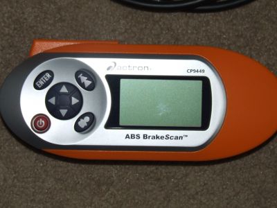

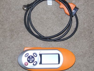

If you replaced the rear sensors already, and that was the code that scanned, you need to unplug the sensors, and use an ohm meter to test the wires. You should get a zero or at most five ohm reading, Inspect for visual signs of damage or corrosion. This may require some interior trim removal to access the wires. ABS wires are called "twisted pair" as they are twisted together along their run. This makes for easy identification, Also, if you want to buy an ABS scanner, Actron makes a unit that reads most US makes to 2005, it is model CP 9449, I Googled it and bout one for $114.00 US, not too bad considering the suggested retail is $299.00!
