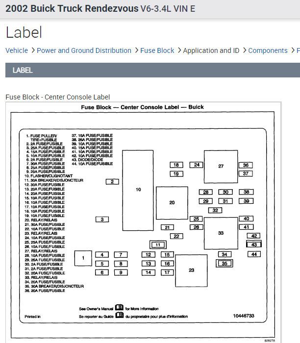

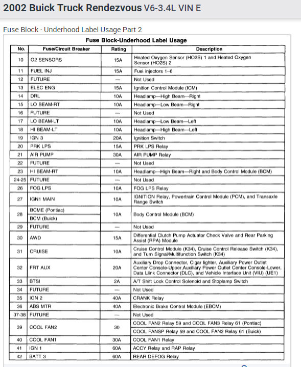

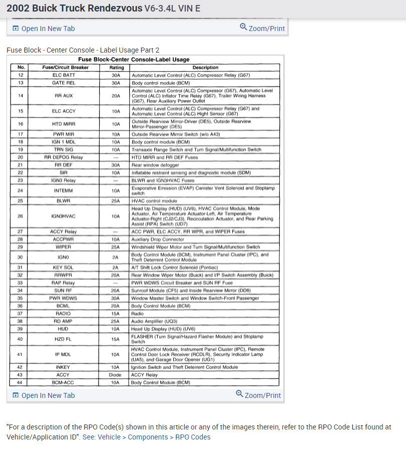

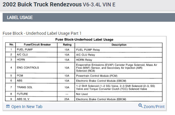

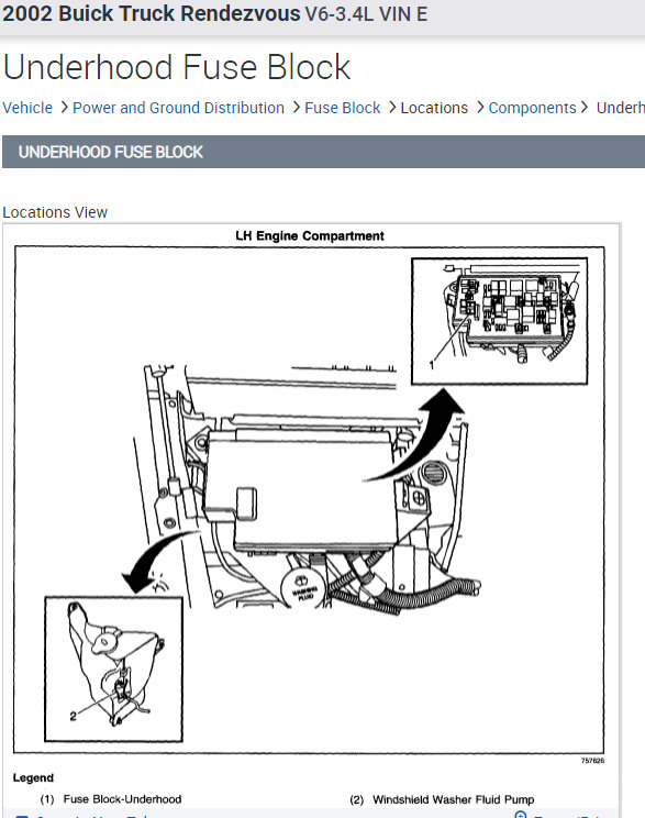

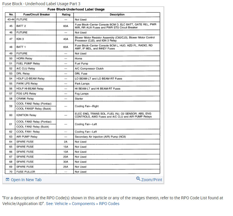

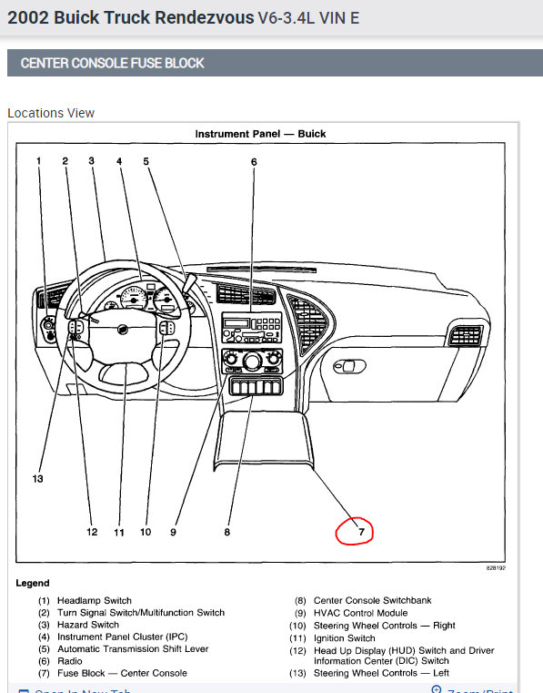

Where are the fuses in this car and what do they go to I have lighting issues I need to test the fuses.
Sunday, February 3rd, 2008 AT 10:17 PM
SQM
MECHANIC
6,383 POSTS

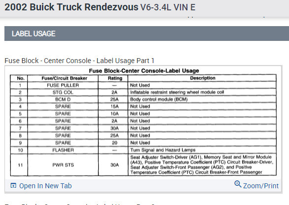

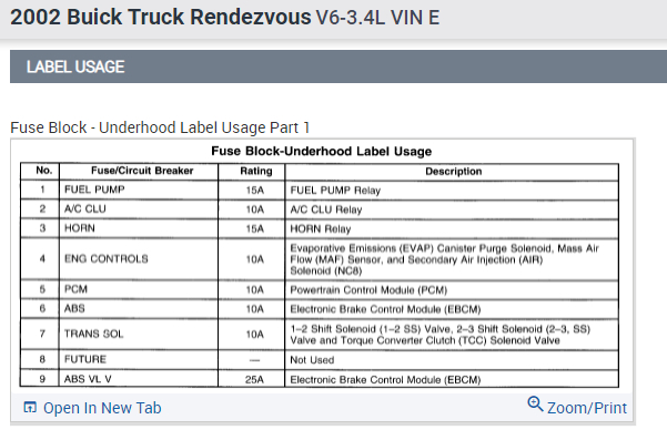

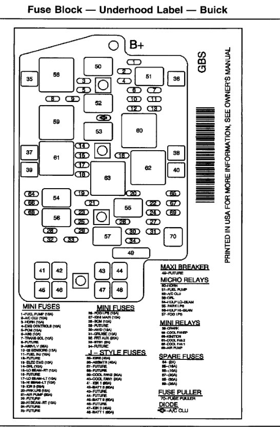

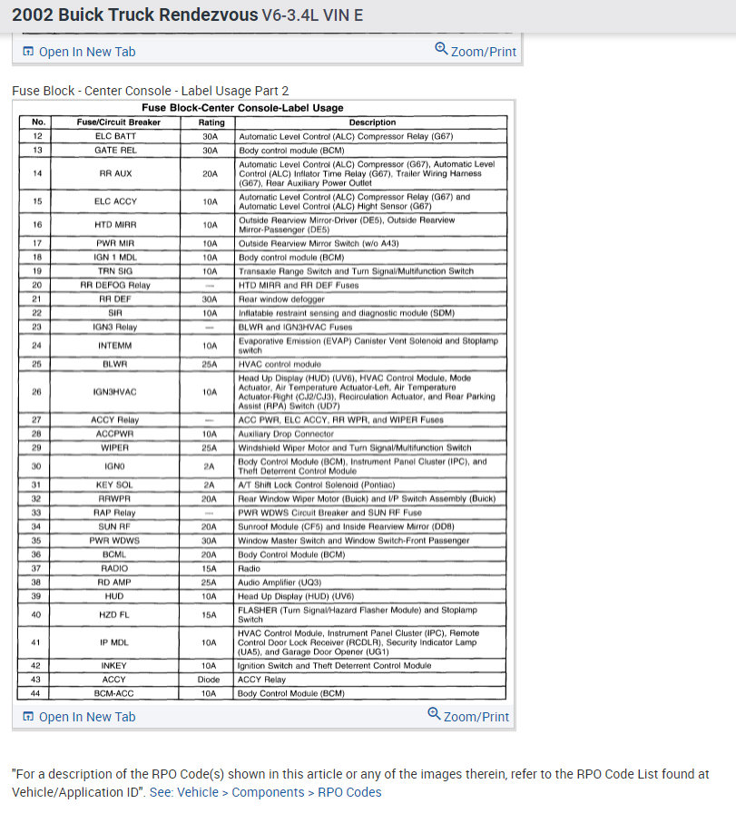

This vehicle has two fuse blocks.
One under the center console, the second one in the engine bay on the left hand side (see diagrams).
Here is a helpful video:
https://youtu.be/Hlna_kUt7As
I have attached the diagrams include all the fuses and the usage for your reference.
