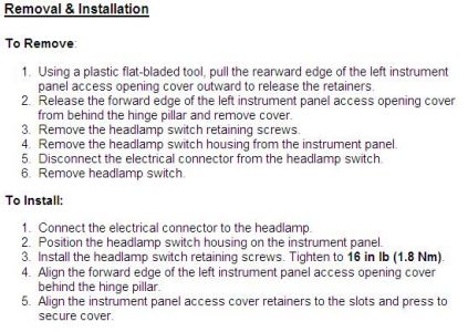

JDL
  • 16,098 POSTS
http://www.2carpros.com/forum/automotive_pictures/170934_headlamp_switch_removal_1.jpg
My info showed the above for removing the headlamp switch. I always consider myself lucky If I don't break or crack something, doing that.
