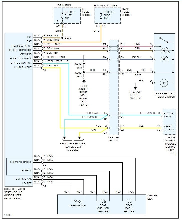

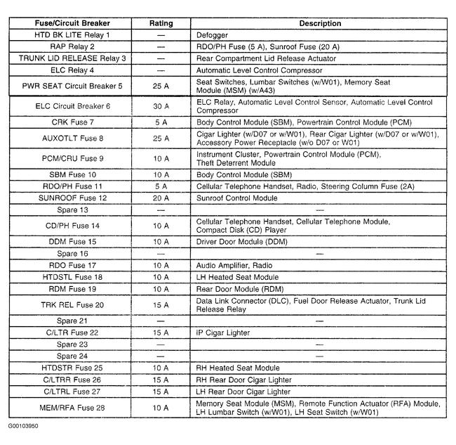

Driver side seat stoped heating. The light comes on at the swithch and I can hear a clicking sound under the seat when I push the switch on & off
I have also checked the fuse for it located under the back seat and it checks good.
is there a temp requlator llocketed somewhere?
is it possible to get a schmatic of the seat heater system and component locations
I will galdly donate by check (if I get good answers) I do not like to give my credit card number on the line.

GM has re designed their heated seat elements because of issues with broken elements in the circuit.
Continuous flexing of the driver side ( more use than any ) causes the wires to break in the left and right thigh areas. Can also be caused by putting your knee in the seat or little kids standing in them in one small area.
Replacement is the only fix and can easily be done
See the guide below on testing wring, it will help narrow it down
The wiring diagram for you heated seat it attached below

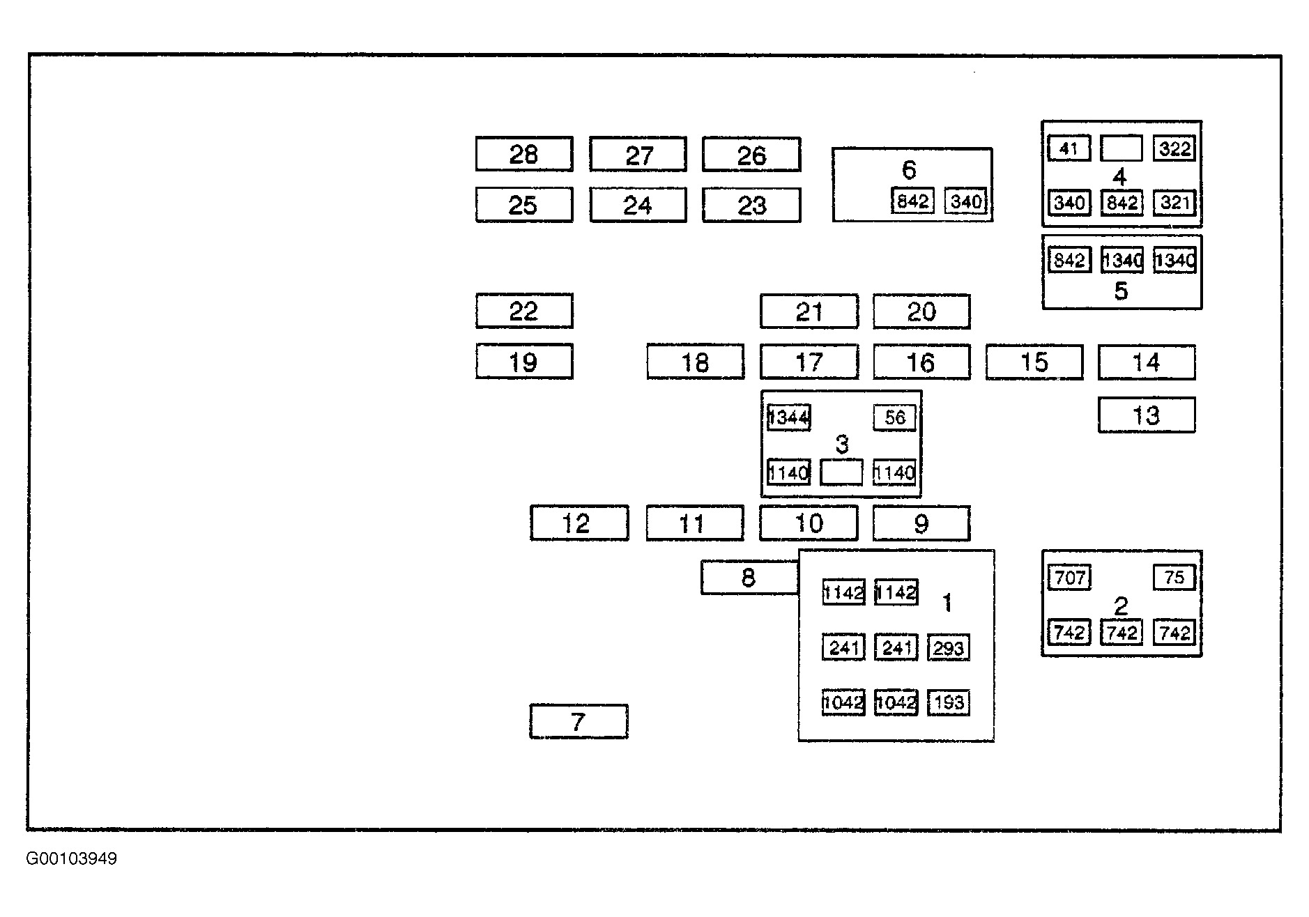

Need to check a circuit braker in Rear Fuse Box Fuse 25 provides power to Memory Module for seats and mirror so if in-op memory will fail and seat and mirror will return to factory preset

Sorry #5 not 25 that is the AMP rating

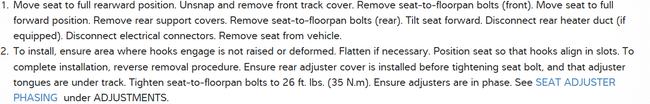

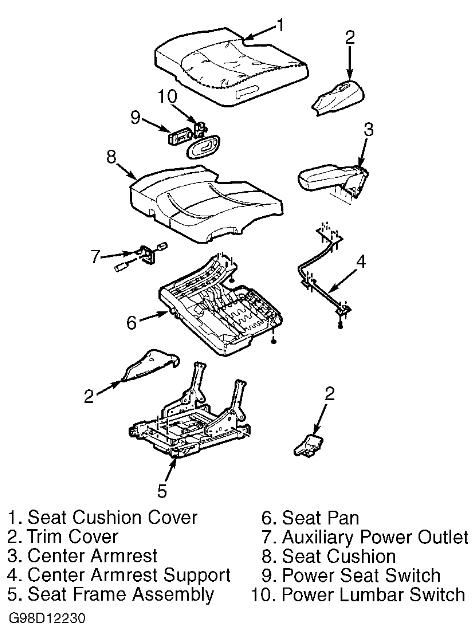

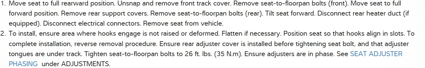

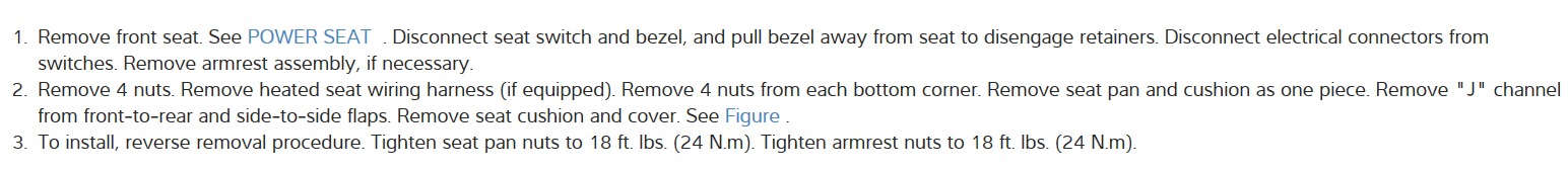

Drivers heated seats went out. There is power to the seat so I'm assuming the heat grid is defective. Can you help in walking me through removal of the seat. I'm guessing there are a couple of bolts on front and back track but I can only locate one bolt in front. In the center near the bottom of the center console. If I can remove seat I believe replacement / repair of the grid should be fairly straightforward.
Thanks for your help!
Friday, November 9th, 2018 AT 7:55 AM (Merged)
HMAC300
  • 48,601 POSTS
See pics
RKWOODY
  • 6 POSTS
Thx for info I was able to remove bottom section of drivers seat all electrical including heated seat module checked out ok issue must be in the heating element which looks to be sewn into the leather cover (which is different from others that I've worked on) best option may be to find replacement @ junk yard

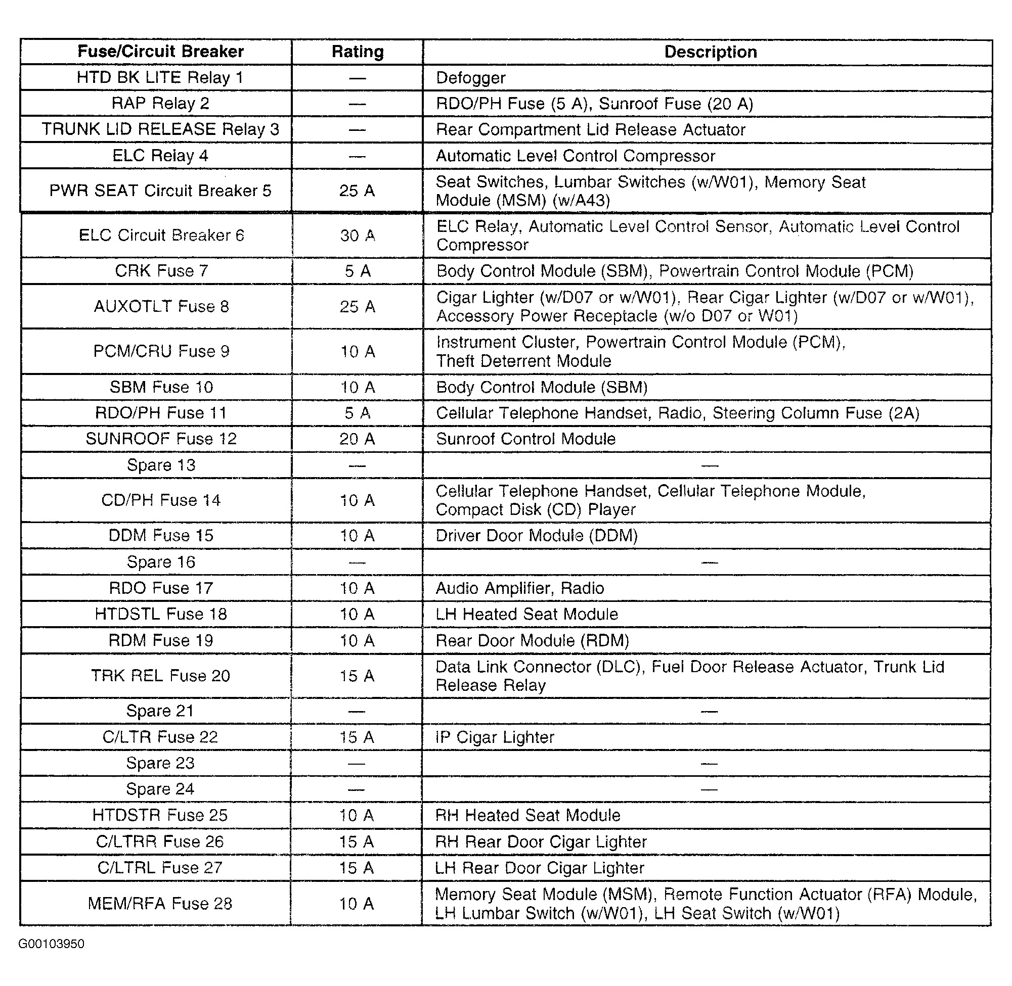

My drivers seat does not work and I cannot find the fuse for it.

BIGTIM5
  • 1998 BUICK PARK AVENUE
  • 6 CYL
  • FWD
  • 98,000 MILES
I have 1998 Buick Park Avenue Ultra. The drivers heated seat does not heat even though the light on the control switch is lit. The passenger side works great. Someone suggested the module is bad but I dont see a module under the seat. Could this be the problem, or could it be something else? Also, if it is a module, where is it?

MERLIN2021
  • 17,250 POSTS
Try unplugging the connector use a volt meter on it, if there is voltage at the connector, the heating element is No good.
