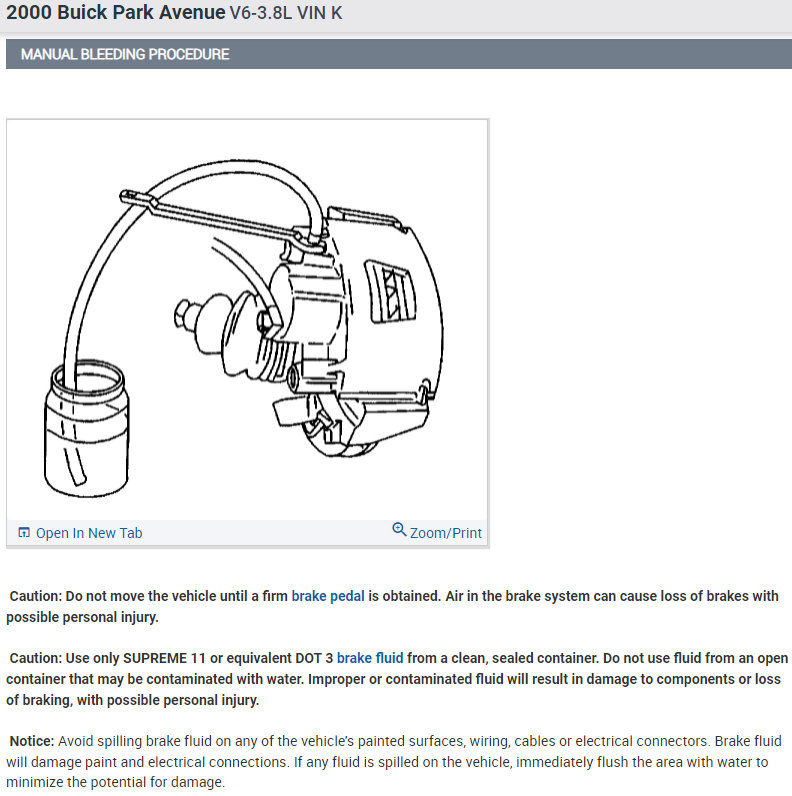

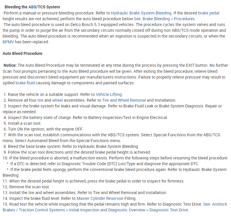

How do you bleed an abs system
Friday, November 20th, 2009 AT 8:24 AM
2 Replies

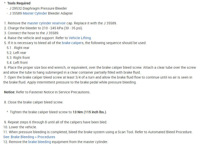

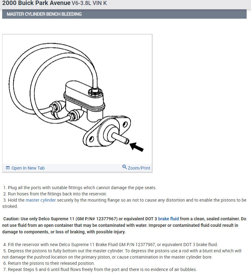

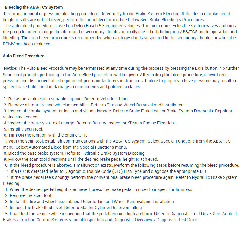

Your vehicle requires a scan tool in order to bleed the ABS system. However, when you do this it is always a good idea to bleed the base brake system as well after you do the ABS.
Here is a guide that will show how to do this:
https://www.2carpros.com/articles/how-to-bleed-or-flush-a-car-brake-system
Below you will find the process from the manual that will show how to bleed the ABS system.
Please let us know if you have other questions on this. Thanks

Please refer to this videos, you might find helpful:
https://youtu.be/w7gUsj2us0U
https://youtu.be/WDxvEQrMkBg
https://youtu.be/nQRnKyVyMuQ
I have also attached instructions on this.
Let me know if you have any questions.
