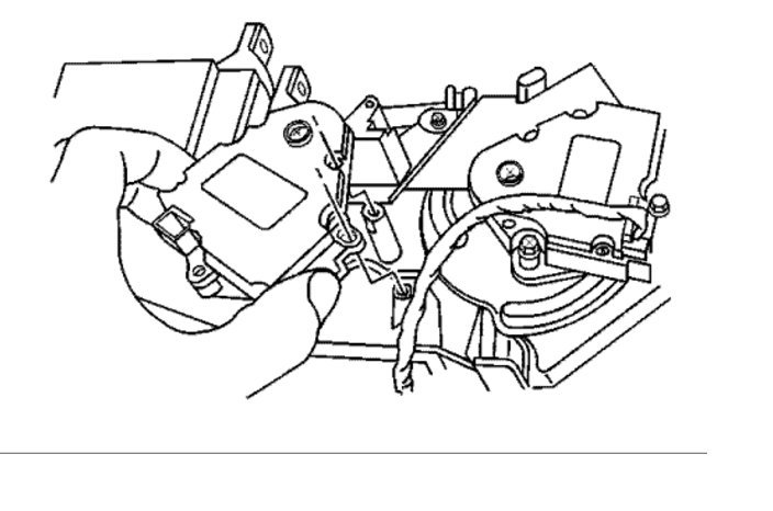

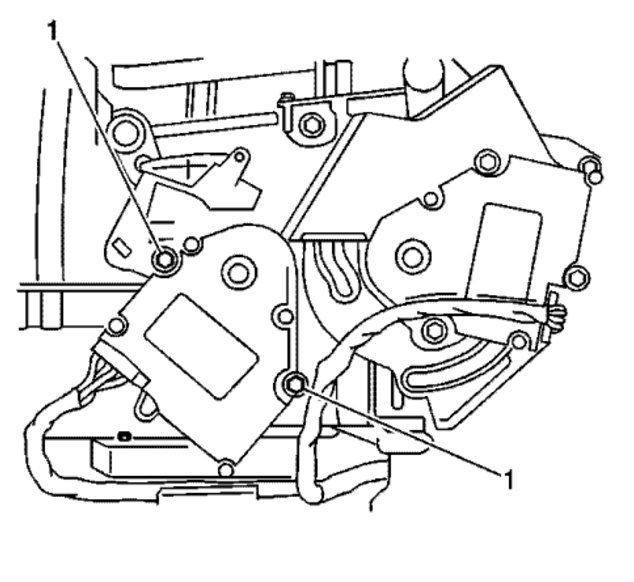

Hey Duane,
These cars also had problem with the blend door actuators (mode). What happens is the gears break inside the unit which will not trigger a code.
Here is a guide that will help you fix it:
And diagrams (below)
Here is a testing procedure to help as well.

This is the identical issue with mine. Same year etc. I cannot find if anyone said if they are all the same. What do I need to buy? Which actuator? All the same?

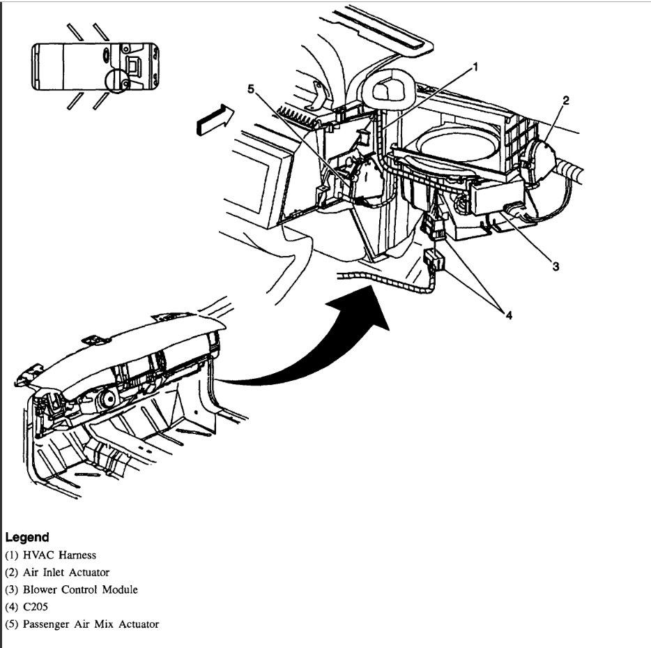

It should be the air inlet actuator that is causing the issue but to be sure remove the actuator and work the pivot for the air door by hand with the system running to see how it affects the air flow.
Here is a diagram (below) to show you the location and check the guide above for reference. Please run this test and get back to us.

I do not have a scan tool. Also asked if they are all the same? There are three correct? I was told on this year and model it was the one by drivers foot upper right? But I have been finding there are two in that area. Which one if that is the case will flow air to proper vents? Thank you again. I trust your help. Just making sure before I start tearing into it.

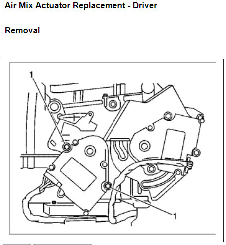

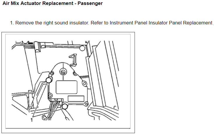

Not sure if they are all the same. There are four actuators when you remove one turn the system on and move the pivot by hand this will let you know which one does what.
Here are the other two actuators. Looks like there are only three.
