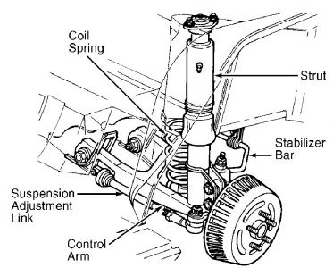

Does this look like your suspension?
https://www.2carpros.com/forum/automotive_pictures/30961_aast_1.jpg
Shocks supply force towars the pavement, springs provide force away from the pavement. Get a look at the springs.

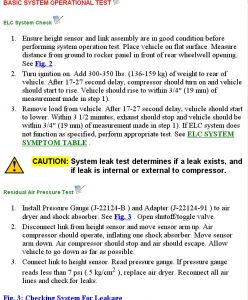

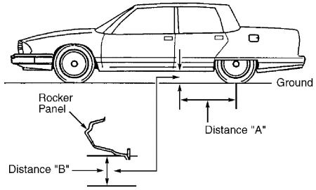

Also measure the ride height and see where it is at. IF the air shocks are not filling it will set low.
https://www.2carpros.com/forum/automotive_pictures/30961_1rdht_1.jpg
https://www.2carpros.com/forum/automotive_pictures/30961_2rdht_2.jpg
