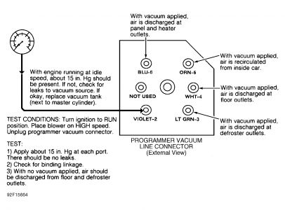

Air flow blows out the defroster I need location of the problem. I have had the vaccum checked out & it was fine thanks

Test the vacuum this way I know you said it was checked, but it is the ONLY thing that causes default to defrost!
