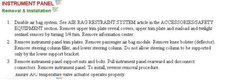

Heater problem
1996 Buick Park Avenue 6 cyl Two Wheel Drive Automatic
where is my heater coil at and how do I replace it?

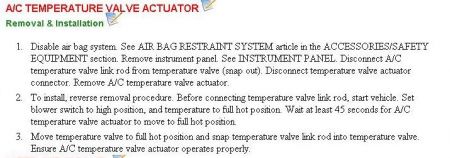

From under the hood, locate the two heater hoses going through the firewall. Your heater core will be at the other side of the firewall, under the dash.
https://www.2carpros.com/forum/automotive_pictures/55316_96parkavecore_1.jpg
https://www.2carpros.com/forum/automotive_pictures/55316_96parkavevalveactuator_1.jpg
https://www.2carpros.com/forum/automotive_pictures/55316_96parkaveinstrumentcluster_1.jpg
