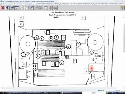

My factory radio quit working, so I was removing it, I shorted something out, what I do not know. Now my electronic ac/heat controls do not work, although they do have backlighting, nor my horn, or cig lighter or the keys in ignition/headligt alarm will not work now. Fuses are good, relays I assume are good, they click when power is turned on.

You should have a relay/fuse box under the hood
Saturday, March 1st, 2008 AT 10:50 PM
BLKJAKROI
I will look again, I found relays but no fuses under the hood. I will check again in the morning. Thank You

http://www.2carpros.com/forum/automotive_pictures/62217_FuseRelays_8_copy_1.jpg

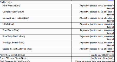

http://www.2carpros.com/forum/automotive_pictures/62217_FuseLinks_copy_1.gif
Look for the red spot...for fuses and relays, also check fusible links on firewall...
Just backin you up 007!
