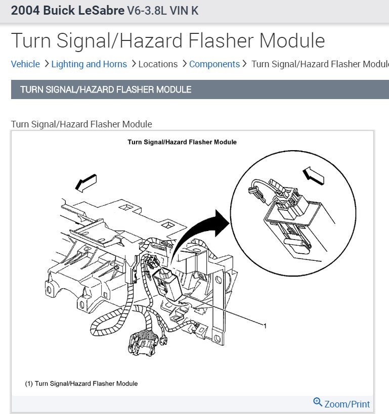

2004 BUICK LESABRE
Where is the turn signal located?
Friday, February 6th, 2009 AT 6:18 PM
MERLIN2021
MECHANIC
17,250 POSTS
The flasher module is located under the dash on the drivers side. Here is a diagrams of the location below. Check out the diagrams (Below). Please let us know if you need anything else to get the problem fixed.
