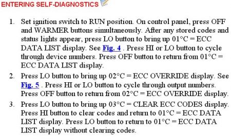

Ok Guy's I hope you can figure this 1 out. The heater stays on constantly and will not shut off except when you turn car off. Stays on auto fan can not switch speeds, temp, or to A/C. It is dual climate control and the passenger side controls do not work either. You can push all control buttons, they will make a beeping sound when pushed but thats it. I have chacked all fuses and relays and still cant figure it out.

Check codes using this format. What did you get?
http://www.2carpros.com/forum/automotive_pictures/30961_builes_1.jpg
Sounds like the heater control unit is bad bu the sounds...but...

Thank you very much for the help but it did not work. You said the Heater Control Unit might be bad by the sound of it. How would I go about changing that part out and is it a dealer part or can I get that at a parts store?
