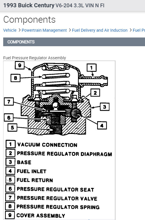

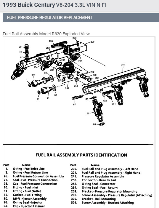

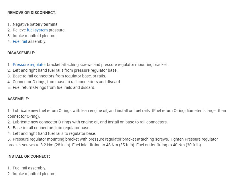

Even with a new fuel pump, if there is a clog in the fuel lines or a bad fuel pressure regulator, it will not start. So, checking the fuel pressure can help narrow down the possible cause.
This vehicle should have 41-47 PSI of fuel pressure with the key on and engine off.

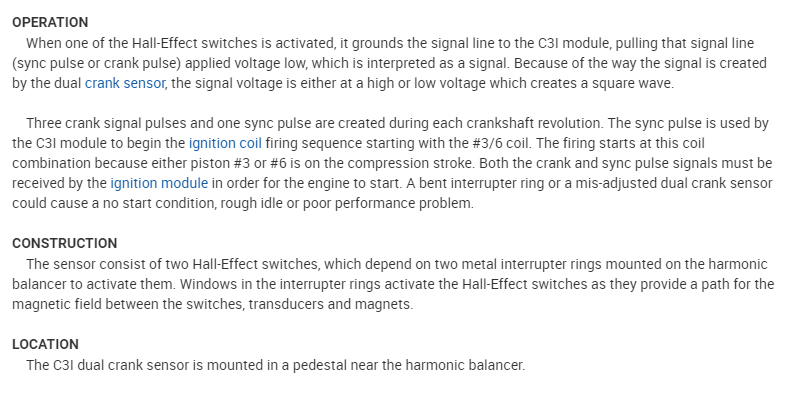

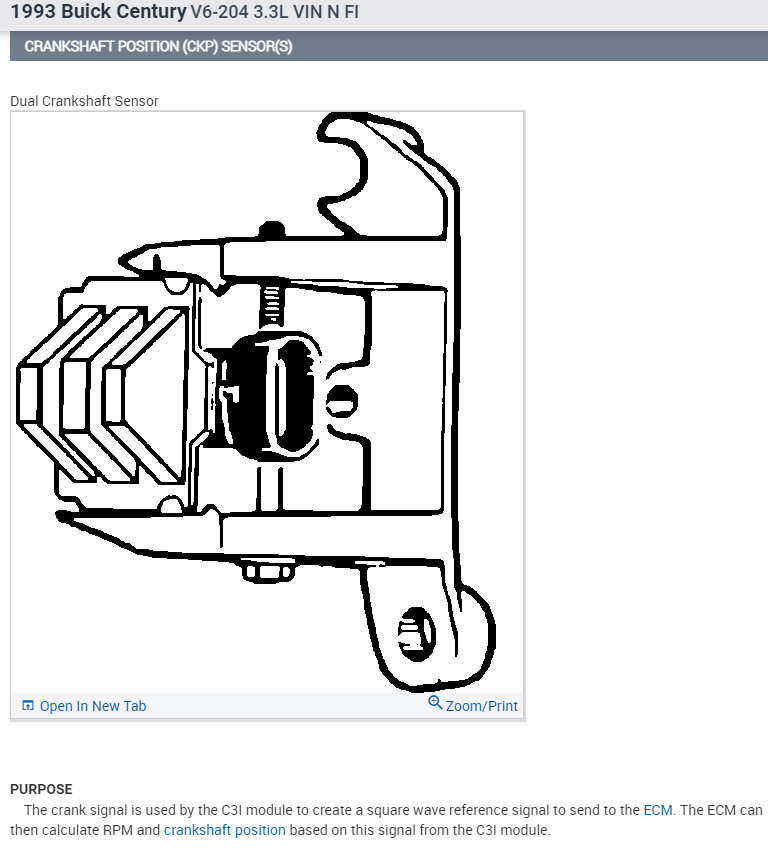

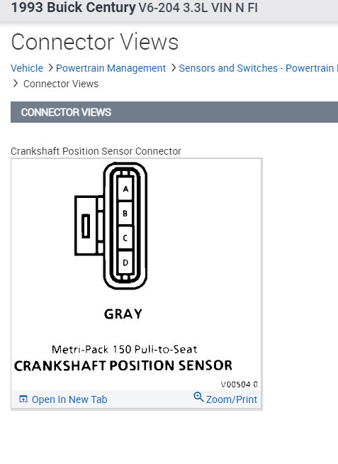

This can also be due to a faulty crank position sensor. A malfunctioning crank sensor will send error codes to the ECM and that will trigger an engine shutdown. It may or may not start back up afterwards.
The crank sensor is mounted near the harmonic balancer.
