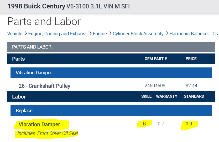

How long should it take to replace this part, only using jacks at home to lift it?

I have included for you a video that will help show the job on a similar car down below'
https://youtu.be/NZIMNkLxCMA
Please go through the guide and if you need instructions on how to remove and install the harmonic balancer on your vehicle, please, feel free to ask.
