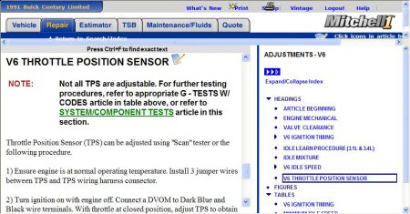

After driving the car for thirty minutes it acts like its not getting enough gas and stalls. The code we recovered was 22, so we replaced the TPS, but are having proplems getting it adjusted right. What do we need to do?

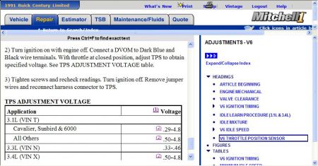

See below for adjustment
https://www.2carpros.com/forum/automotive_pictures/12900_tps1_11.jpg
https://www.2carpros.com/forum/automotive_pictures/12900_tps2_9.jpg
https://www.2carpros.com/forum/automotive_pictures/12900_tps3_8.jpg
