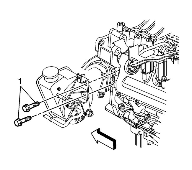

1. Place a drain pan under the vehicle.
Pic 1

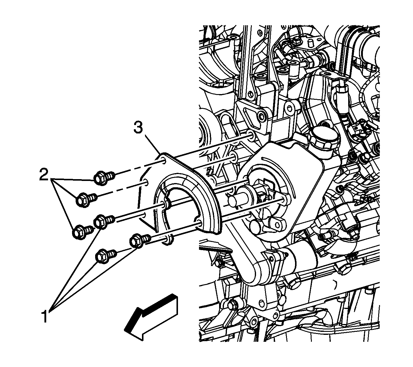

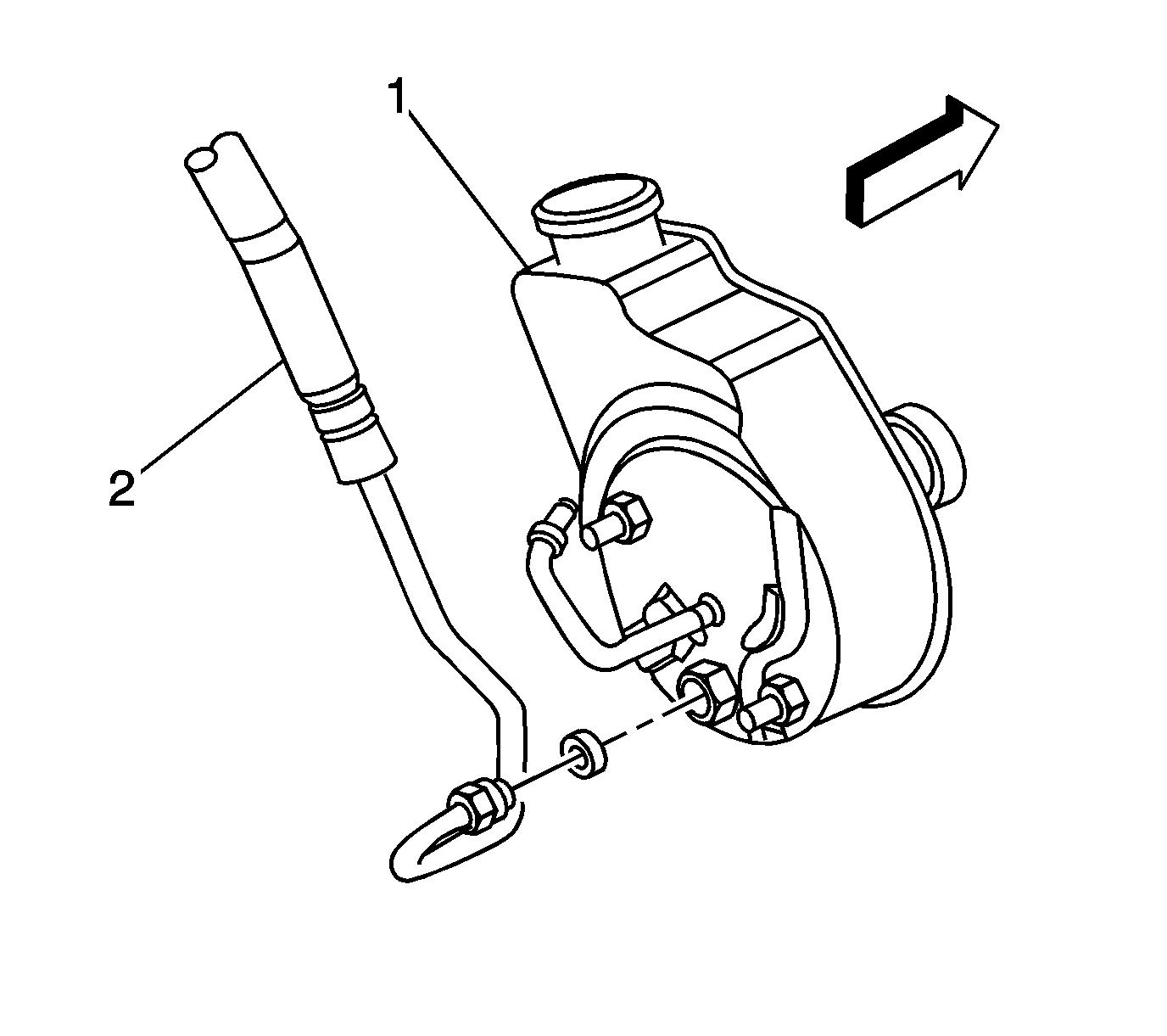

2. Remove the bolts (1) from the rear of the pump.
pic 2

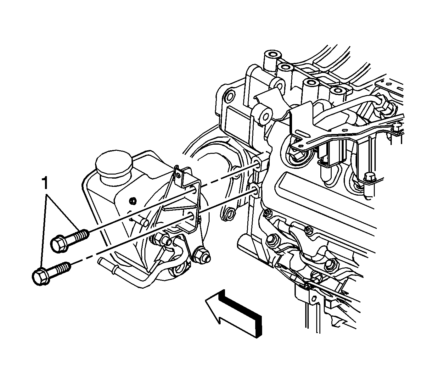

3. Remove the bolts from the front of the pump bracket.
Important: Note the location of the battery cables for reinstallation.
4. Disconnect the negative battery clip from the power steering pump front bracket.
pic 3

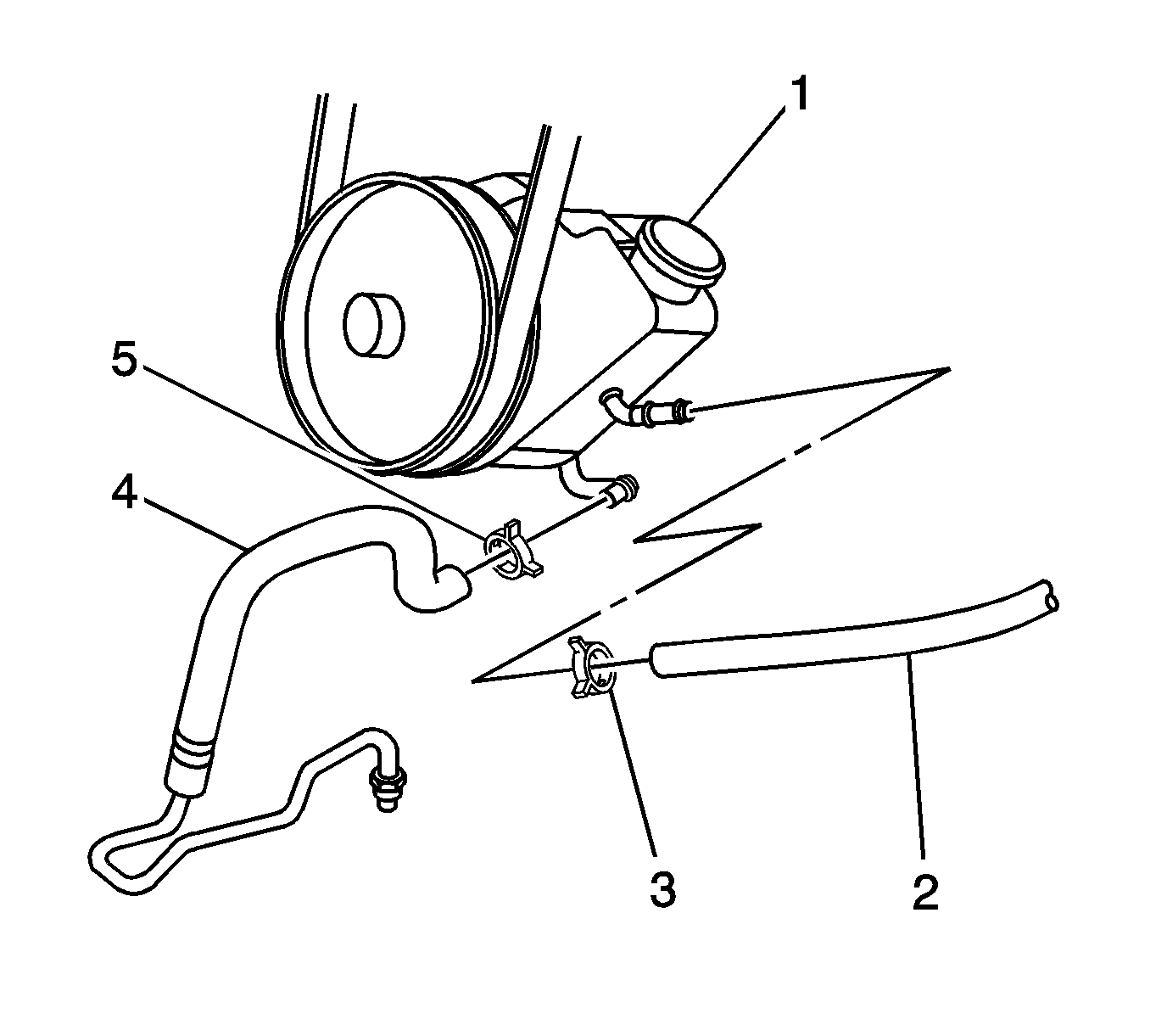

5. Remove the power steering return hoses (2, 4) from the power steering pump.
pic 4

5. Install the power steering return hoses and retaining clamps (3, 5) to the power steering pump.
pic 7

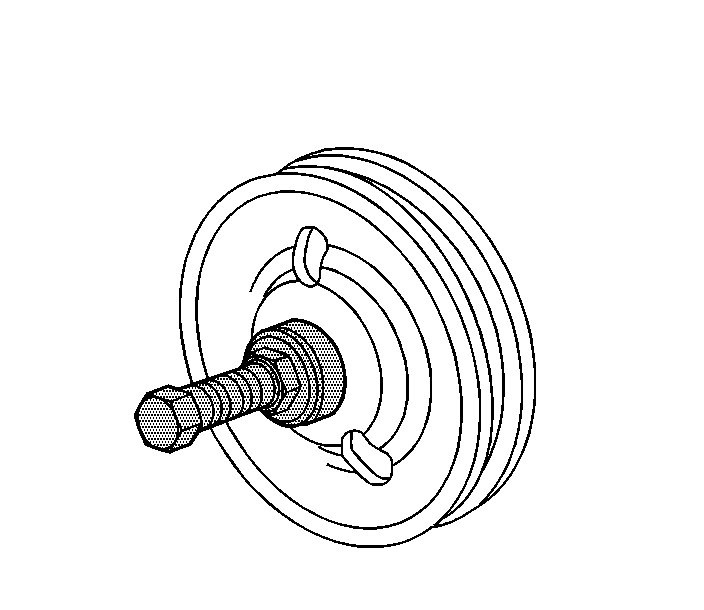

Here are the directions specific to your truck for pulley removal. You will need a specific puller and installer for this. However, just about any nationally recognized parts store will lend / rent it to you.

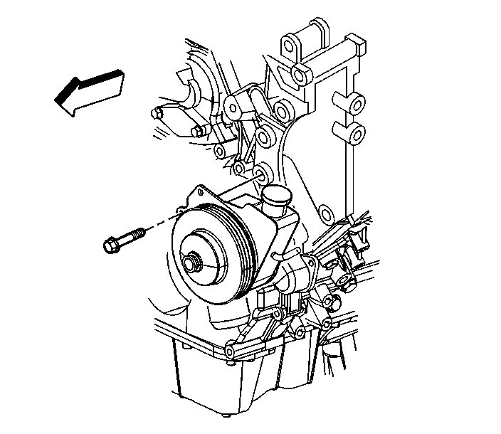

2. Remove the power steering pump front bracket bolts (1,2).
pic 10
3. Remove the power steering pump rear bracket bolts (1).
4. Pull the power steering pump away from the accessory bracket to gain access to the pulley.

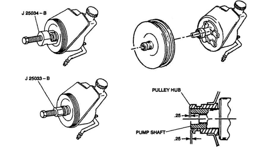

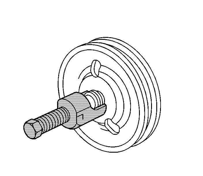

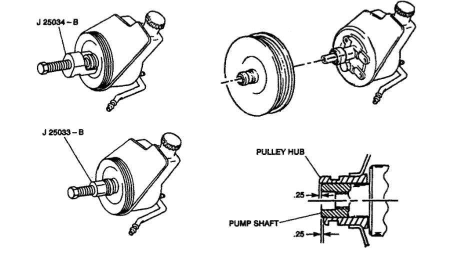

5. Use the J 25034-C to remove the power steering pump pulley.
Installation Procedure
pic 12

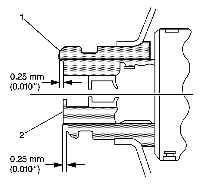

1. Place the power steering pump pulley on the end of the power steering pump shaft.
2. Install the power steering pump pulley using the J 25033-C.

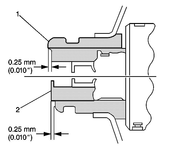

pic 13
3. Ensure that the power steering pump pulley (1) is flush against the power steering pump shaft (2) with an allowable variance of 0.25 mm (0.010 in).

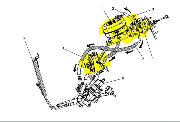

Let me know if this helps. Also, if you look at pic 16 (last pic) I included an exploded view so you can see how the power steering pump ties in with the brakes. I highlighted the power steering pump and brake master cylinder.
Take care and let me know if you need anything.

My power steering pulley pulled out every time I turned the wheel, it threw my serpentine belt as well I removed the power steering pump and am going to buy a new one, does the new one come with a pulley? If not how do I put it on so it doesn't come off like the last one? And why would the last one have come off like that?
Thursday, February 25th, 2021 AT 4:32 PM (Merged)
RHALL77
  • 3,361 POSTS
No it does not come with with one. you will have to change it. Is the shaft coming out with it? the power steering shaft could be broken. or the pulley is worn to much.

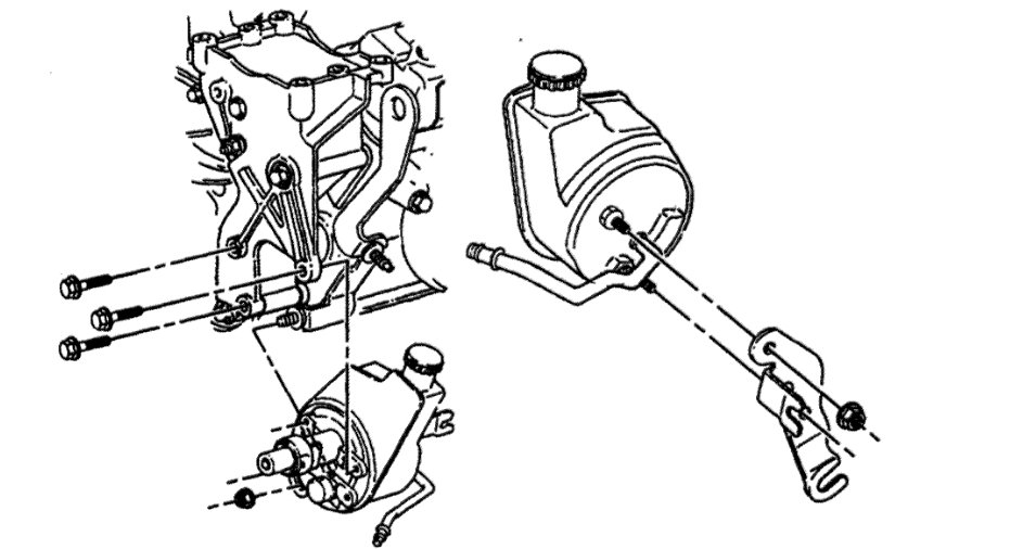

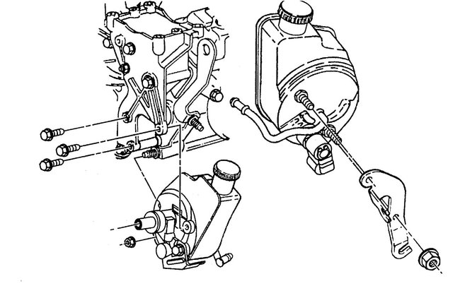

How do I remove the power steering pump? The haynes book says there are only 3 bots to remove but there seem to be more that I can't find.
I've removed the drive belt, the in/out hoses and the plug on the rear of the unit and it just won't come out.
What am I missing?
Thursday, February 25th, 2021 AT 4:33 PM (Merged)
BLUELIGHTNIN6
  • 16,542 POSTS
There is also a rear support bracket, you will have to remove the lower nut to get the pump off

4. Pulley.
Install J 25034-B. Be sure the pilot bolt bottoms in the pump shaft by turning the nut to the top of the pilot bolt.
Hold the pilot bolt.
Turn the nut counterclockwise.
5. Front mounting bolts.
6. Rear mounting nuts from studs.
7. Pump.
