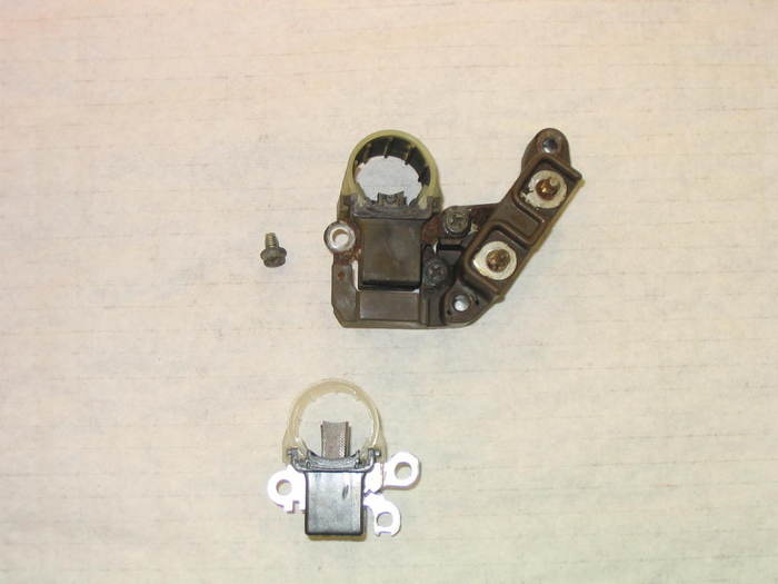

Aug 1, 2020 at 11:11 AM
(Merged)
Yup. REAL common problem. The brushes are worn and making intermittent contact. The testing has to be done while the problem is occurring. During their test, they caught it while it was working.
If you can find the parts, you might be able to replace the brush assembly without removing the alternator from the engine, at least that could be done on the older stuff that I drive. I've done this many times on cars I put "bugs" in for my students to troubleshoot.
Here's a photo of what the assembly looks like. You don't have to remove the terminal block as I did in the photo, just the three screws.
caradiodoc
caradiodoc

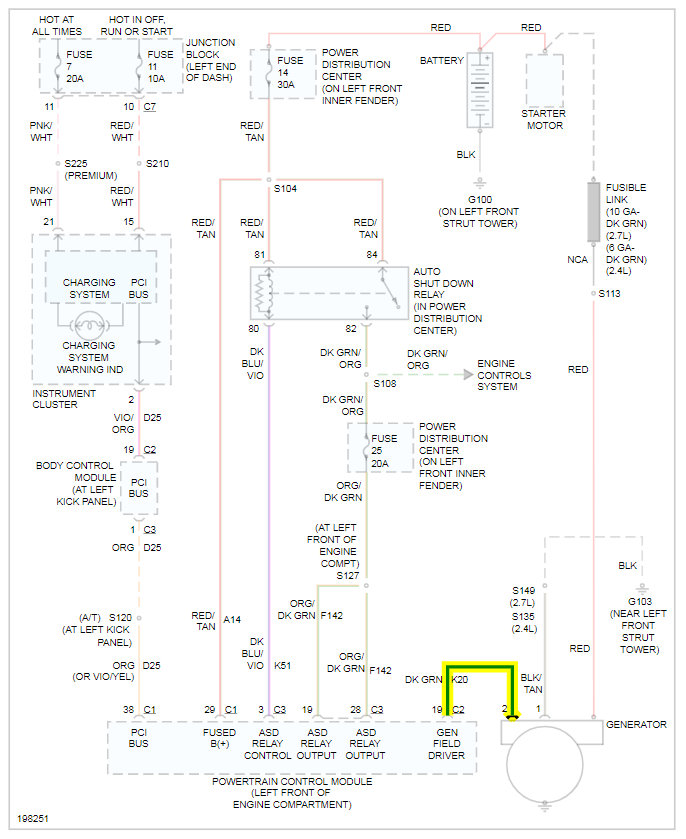

(Merged)
Brand new battery, new alternator, and brand new re-manufacture ECM. ECM was corrupt i cleaned all the grounds to the chassis and cleared faulty codes. Only codes available was for heater control circuit and EGR. Any help with ambient air temperature location? I'm scratching my head on this one. Any experience with this issue would be greatly appreciated and helpful. I did clean all the grounds. And 3 weeks into this one, thanks in advance for your help.
Oct 25, 2020 at 11:30 AM
(Merged)
More then likely you have an issue on the generator field control wire. Either a connector issue or the wire itself has a short or high resistance. I highlighted here in the wiring diagram.
We need to check for a short and measure resistance from end to end. Basically this is the wire that the PCM uses to control the generator.
We can confirm the generator is causing the light to come on if you check the voltage across the battery when the engine is running. There should be around 14 volts. If not then the light is coming on properly telling you the voltage is low.
Let me know what you find. Thanks
