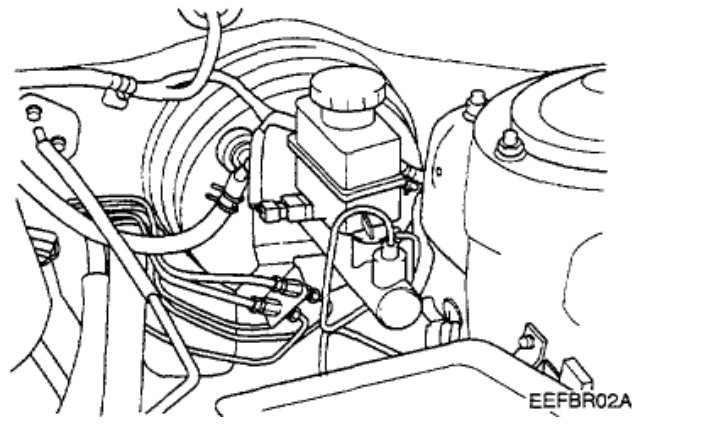

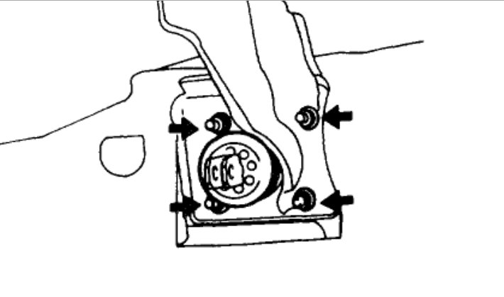

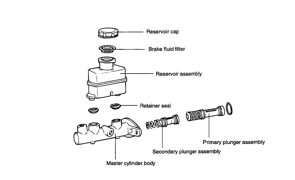

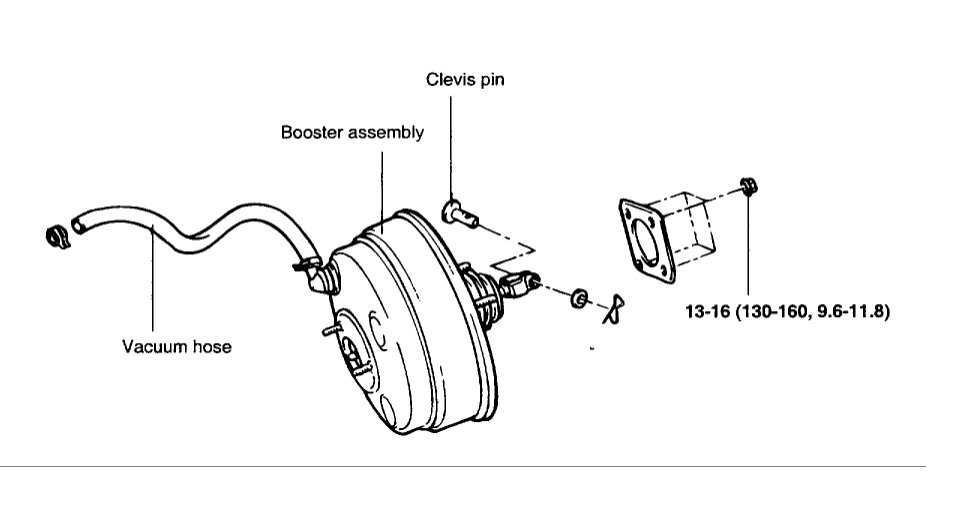

What happens is the internal valve inside the booster gets stuck so it wont release. The booster needs to the replaced or the booster rod is adjusted too far out. Try to undo the mounting bolts for the master to see if that releases it as well if so then turn the rod adjustment screw inward. If not here are some diagrams to help you replace the booster with a rebuilt or new unit.
+3

Check the brake pedal adjustment. If there is insufficient free play, the master cylinder would be partially depressed and this would result in the brakes seizing after the brake fluid heats up. Insufficient free play could be due to a mis-adjusted brake switch.
Monday, March 15th, 2021 AT 6:05 PM (Merged)
MATTHEW T WHITE
I figured it out it is the brake booster not sure if the pedal is adjustable or not. However, the screw is just have to take the master all the way off to adjust it.
Monday, March 15th, 2021 AT 6:06 PM (Merged)
KHLOW2008
  • 41,814 POSTS
Before adjusting the brake booster, check the brake pedal free play adjustment first. It is adjustable, either by the push rod or the brake switch if the pedal is low.
