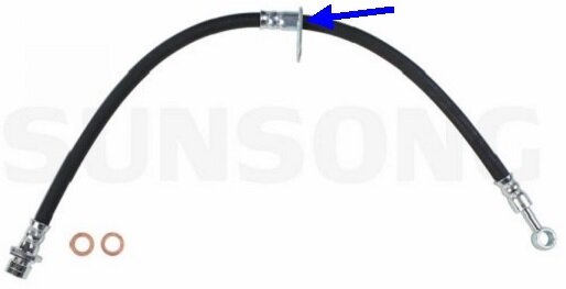

Changed mc drive wheels lock up. Loosen mc bolts from booster and pressure releases. So is the rod too long. Never changed the length just changed mc.

Did you replace the master cylinder in an attempt to solve the locking brakes, or did the locking problem just show up after it was replaced?
Loosening the master cylinder from the booster is a valid test. It proves the rubber flex hoses aren't constricted, typically from rust forming under a bracket crimped around the hose, and it proves the brake fluid is not contaminated with a petroleum product. That causes rubber parts to swell. The rubber lip seals in the master cylinder will grow past the fluid return ports and block them, keeping the brakes applied.
It's usually only imports that have adjustable power booster push rods. If it is extended too long, the brake pedal will be too high and hard, but before you make an adjustment, check the adjustment of the brake light switch. If that got out of adjustment, it can hold the brake pedal down a little. You can usually identify that by pulling up on the brake pedal with your foot when the dragging brakes occur.

The next step, when the locking occurs, is to loosen the soft metal line nuts for the steel lines at the master cylinder. If brake fluid spurts out and the brakes release, we can rule out everything beyond that point, including constricted hoses. The only possible cause is the fluid return ports in the master cylinder are blocked. If that just started with the new master cylinder, the length of the power booster's push rod is suspect. If this problem occurred with the old master cylinder, contaminated brake fluid is the better suspect.
Any petroleum product that gets introduced into the brake fluid reservoir will cause locking brakes after a few days to as much as a week. This includes engine oil, transmission fluid, power steering fluid, penetrating oil used to loosen rusted brake line fittings, and axle grease, commonly from residue on our hands after repacking wheel bearings. First affected will be the rubber lip seals in the master cylinder. You'll also find the rubber bladder seal under the reservoir cap is blown up and mushy. You usually won't be able to pop it back into the cap. Replacing the master cylinder will appear to solve the problem at first, but it will come back within a few days. The only proper repair is to remove all parts that contain rubber parts that contact the brake fluid, flush and dry the steel lines, then install new rubber parts. That will include the master cylinder again, the calipers, rear calipers or wheel cylinders, all the rubber flex hoses, the combination valve under or near the master cylinder, and the height-sensing proportioning valve, if used, (that's mainly a minivan and pickup truck thing). It also includes the hydraulic controller if the vehicle has anti-lock brakes as it has rubber o-rings and seals. If any contaminated rubber part is not replaced, the contamination will leach out of it and recontaminate the new brake fluid. That will recontaminate all the new rubber parts. This gets to be a very expensive repair and can easily render an older vehicle not worth repair.
Based on your observation that pulling the master cylinder forward a little on its mounting studs let the brakes release, we shouldn't have to go any further, but for the benefit of others researching this topic, if the brakes remain locked when doing this, the pressurized brake fluid is being trapped further down the line. This is where the rubber flex hoses are by far, the most common cause. Two things typically happen to them. First, on designs that include a metal mounting bracket crimped around the middle of the hose, as shown in this photo, rust can build up and squeeze the hose closed. You can force brake fluid through that restriction with normal foot pressure, but then that fluid can't return freely to the reservoir. Being trapped under pressure keeps that brake applied, the heat builds up very quickly. That heat migrates through the caliper, into the brake fluid, causing it to expand and apply that brake even harder. On Chrysler front hoses, that crimped mounting bracket can be opened up with a large flat-blade screwdriver or a large pair of pliers in a few seconds. On most imports, that fitting is a barrel the hose goes through. It has no gap to spread open, so the hose must be replaced.
One potential clue to a constricted hose is it usually causes only one front brake to lock up first. The other one develops that problem months or years later. When you have both front brakes locking at the same time, look for what they have in common. That's the master cylinder and brake pedal.
One thing to be aware of that can confuse this issue is almost all front-wheel-drive vehicles, and minivans in particular, use a "split-diagonal" hydraulic system. That pairs one front brake with the opposite rear brake on one hydraulic circuit. That insures that with a failure in one circuit, you'll always still have one working front brake. This is important because front-wheel-drive cars and minivans have as much as 80 percent of their weight on the front. With the standard front / rear systems used on older rear-wheel-drive vehicles, if the front system developed a leak and only the rear brakes were working, those would lock up too easily, the tires would skid, and you'd just keep on going.
A lot of car models still use drum brakes in the rear. Those are much less susceptible to remaining applied due to trapped brake fluid. With each front brake running off a different section of the master cylinder, it can be possible for only one front brake to lock up due to push rod misadjustment or brake fluid contamination, but since you won't see that in the opposite rear wheel, it can falsely look like just one front brake hose is the culprit. The same first step applies. Loosen the lines at the master cylinder. If the front brake is still locked, crawl underneath and open that caliper's bleeder screw. You could instead, follow the brake line from the master cylinder to the combination valve or ABS controller and loosen the line there, if they're easier to get to. The point is we're looking for the first place you can find that lets the trapped pressurized brake fluid release. If a constricted hose is the cause of the problem, opening the bleeder screw on the caliper is the only thing that will release the trapped fluid.
The second thing that can happen to a rubber flex hose is a tear in the inner liner that forms a flap, then a check valve. This occurs when a do-it-yourselfer slaps on new brake pads and during the service, lets the caliper hang by that hose. Even worse is when the caliper was set off to the side, then accidentally fell down, tugging on the hose. This damage is harder to identify, especially when you don't know the vehicle's history that led up to the locking brake problem. To prevent this, hang the caliper with a piece of wire or a rubber strap to keep its weight off the hose.
