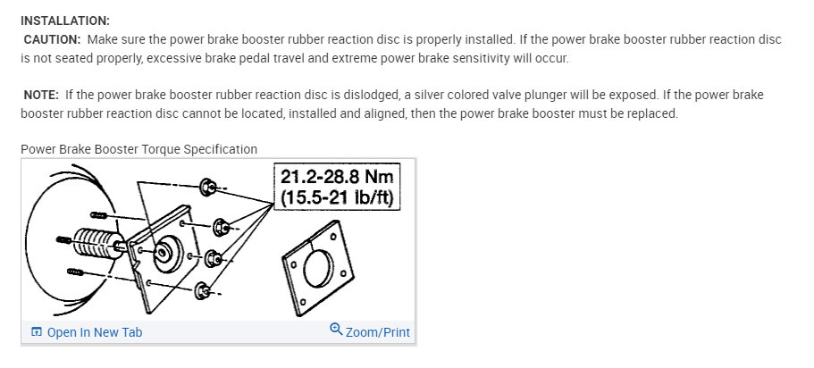

I seem to only have rear brakes. So, I just went crazy and replaced booster, master cylinder, pads, rotors, calipers, wheel cylinders, shoes and drums. So basically, have a new system besides lines and RABS. Have bled system several times as recommended. To no avail. Brakes will not even pump up running or not, so thought I had received bad master cylinder so did warranty exchange and now I will get a little bit of a pedal while not running. At wits end please some advice. (And yes, master cylinder was bench bled, and brakes bled with power bleeding tool.) Also have adjust rod on booster.

Since I was thinking you have already done everything correctly, I did some digging. Did you have the power brake booster removed? If so, see pic 1 below.

Power assist has been replaced. I removed to check if it was installed properly as you asked. I only get resistance on rear wheels. And yes, brakes have been bled properly. I even took to a shop to bled to make sure I did not notice any lines bulging with brakes applied. Brakes were not pumping up running or not until I replaced master cylinder for second time now, they will pump up slightly while not running.

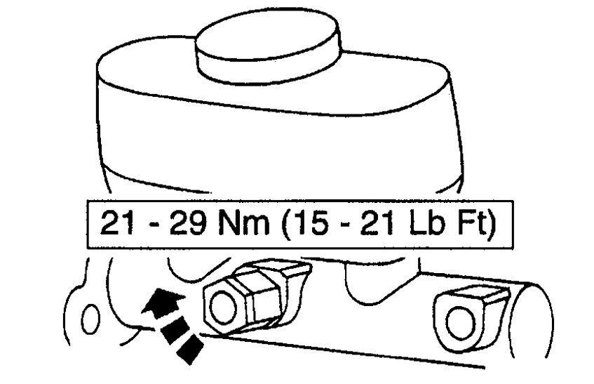

Was the fluid control valve reinstalled on the new MC? See pic 1 below.

Yes, it was reinstalled. I was having this prob before I started doing any work.

Based on everything you indicated, the brakes should work perfectly. If the push rod is adjusted and everything is new, the fluid control valve itself is the likely issue.
When the brake pedal is applied, the full brake pressure passes through the fluid control valve to the rear hydraulic circuit until the valve's split point is reached. Above its split point, the brake master cylinder fluid control valve begins to reduce the hydraulic pressure to the rear brakes, creating a balanced braking condition between the front and rear wheels.
This is the only thing left that I can think of. You should have a pedal. You indicated reinstalling the valve. Was it new or the original one?

It was an original valve. Also, I was thinking it may be centering valve, could this be issue also? Or has electrical connector is there a way to test it, or is this not an option?
