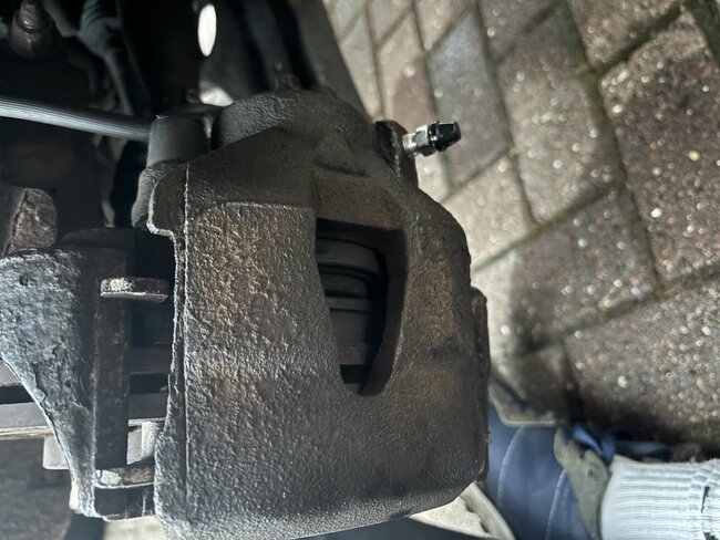

Pedal travels to the floor when braking and the brakes don’t work great, bleed brakes haven’t sorted it, when the car is off, and I press the brake pedal until it’s hard it stays hard for a bit before going down again does this mean my brake booster is gone?

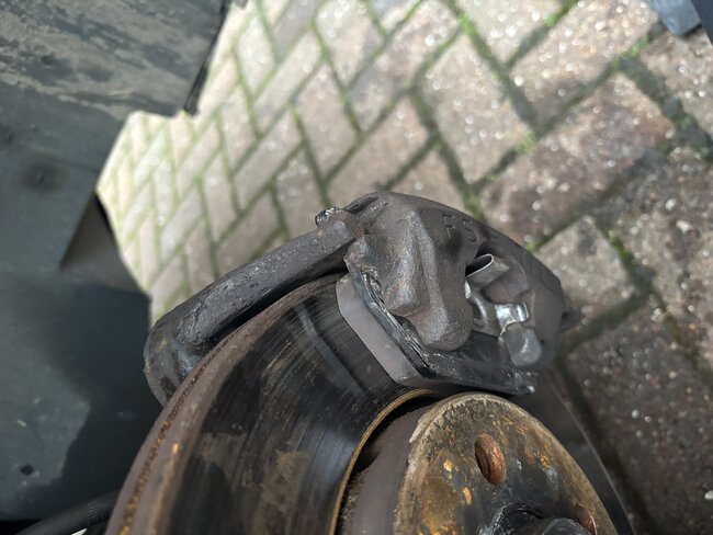

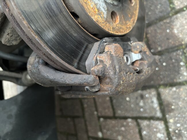

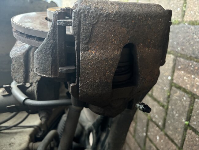

To check if the booster is okay, with the engine off pull the vacuum line from the booter and you should hear air escape, if not the booster is bad. I would again check the caliper slides, not the piston. Can you upload images of the caliper so I can see what I am dealing with?
Nov 2, 2024 at 9:06 AM
JACKTAMPS
  • 6 POSTS
Yeah, I can hear air escape when I disconnect the pipe going to the booster and with the piston pushed back should I have a bit of movement in the Caliper to tell me the slides are okay I’ve had both the calipers off, and the slides come out fine.
Nov 5, 2024 at 8:00 AM
  • CAR REPAIR CONTRIBUTOR
  • 54,436 POSTS
Thanks for the images, it looks like you have the calipers on the wrong side, the bleeder should be at the top.
