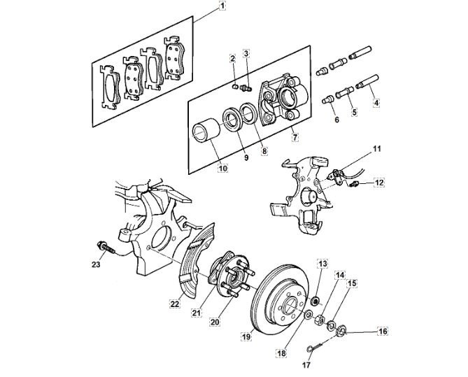

Would you know the torque specs for an the front brakes for this vehicle? I specifically need the guide pin torque specs and the banjo bolt torque specs. Thanks in advance.

The slide pins are 22 ft lbs, The banjo bolt show 145 inch pounds.

Would you also know the minimum thickness for front rotors? Some are stamped on the rotors but some are not. Thanks again in advance for your help.

Rotor specs -
13.3" dia.
Max run out -.004
Max thickness variation -.0005
Min. Thickness -.89" or 57/64"

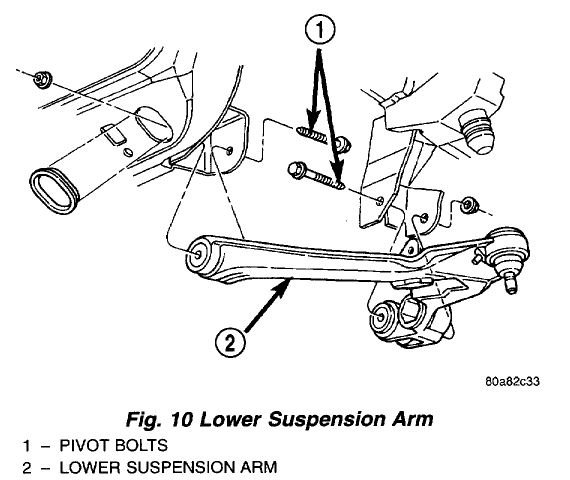

Would you have the torque specs for lower control arm, brake mounting bracket and banjo bolt for the vehicle listed above? I'm not sure if the control arm bushing bolt has a torque spec or not. I just asked. Thanks in advance.

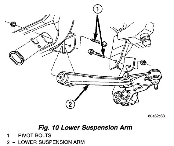

For the A arm -
Pivot bolts through the bushings (1) Front bolt 80 ft lbs Rear bolt 140 ft lbs
Shock mount bolt - 80 ft lbs
Ball joint stud - 135 ft lbs
Brake mounting bracket - Doesn't have them, the caliper and pads slide on ears that are cast into the steering knuckle. It is held in place by the caliper pins.
Caliper pins are torqued to 22 ft lbs.
Banjo bolts are all 145 In Lbs using new seal washers.
