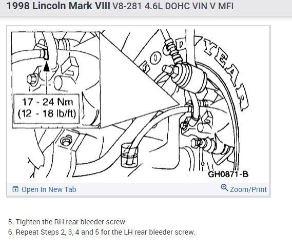

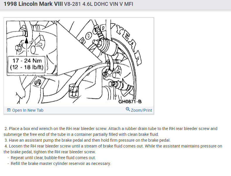

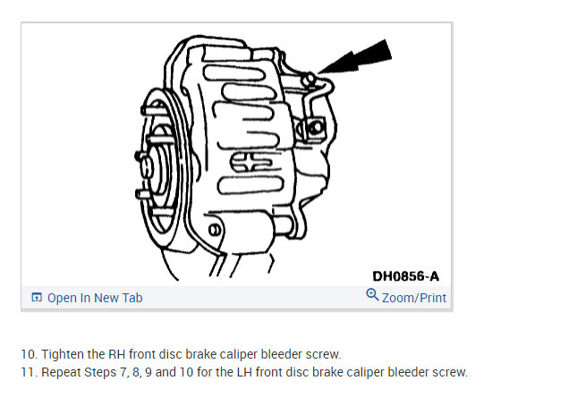

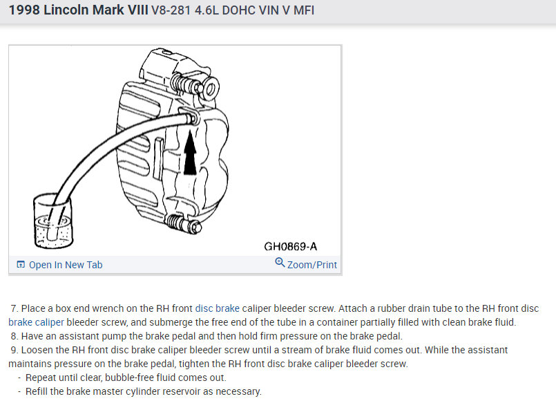

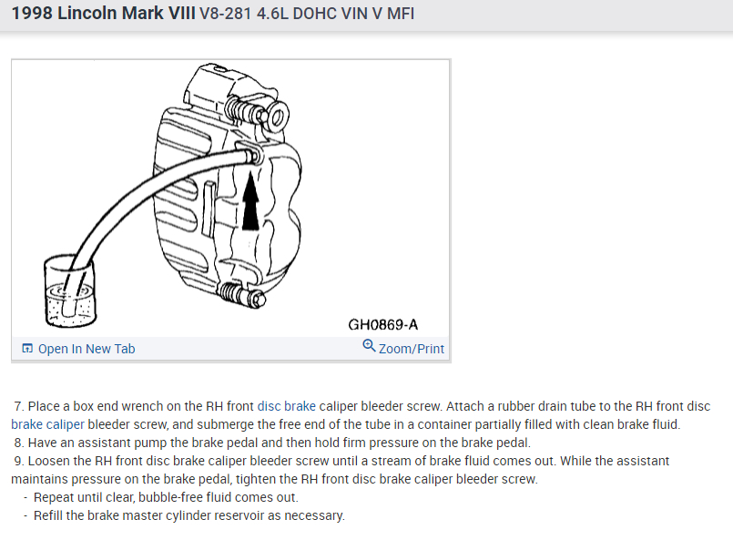

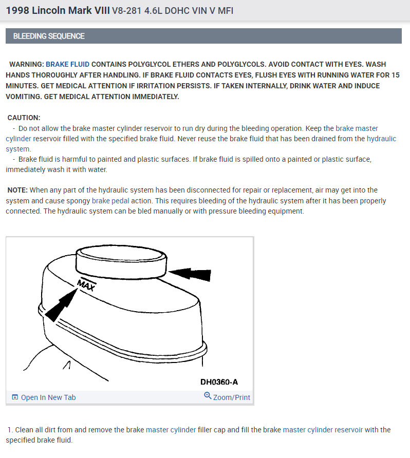

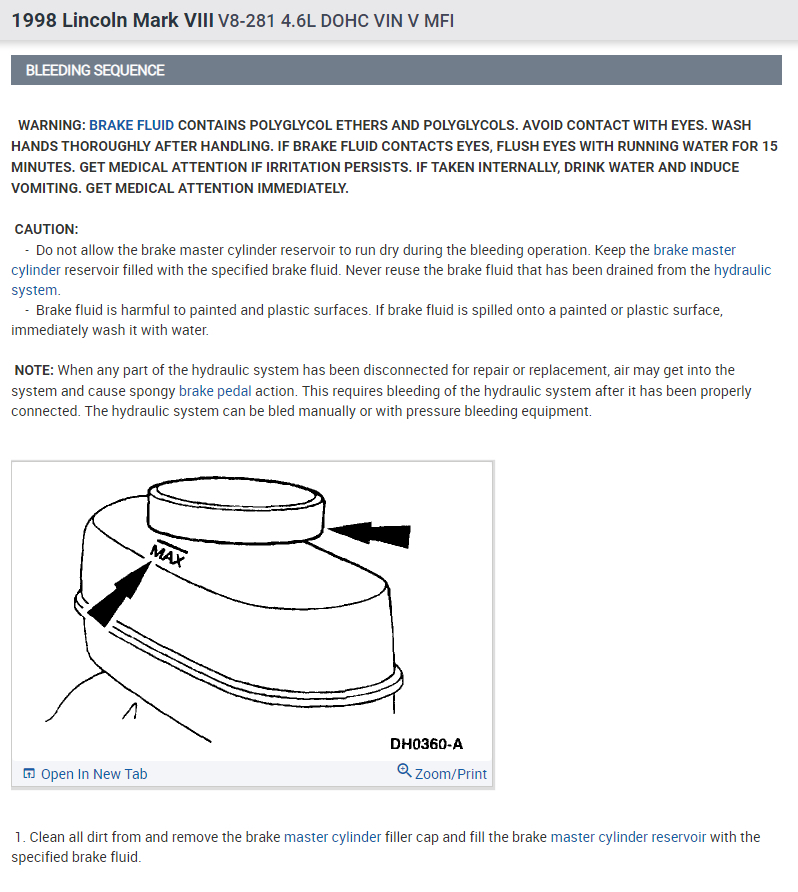

Brake pedal goes to floor after replacing brake caliper on the rear. What is sequence for bleeding brakes?
Saturday, January 20th, 2018 AT 6:02 PM
SQM
MECHANIC
6,383 POSTS
Anytime a caliper, hose or master cylinder gets changed, the brake needs to be bled to get the trapped air out.
Here is a helpful guide on how to properly bleed the brakes:
https://www.2carpros.com/articles/how-to-bleed-or-flush-a-car-brake-system
I have attached the brake bleeding sequence for your Lincoln below.
