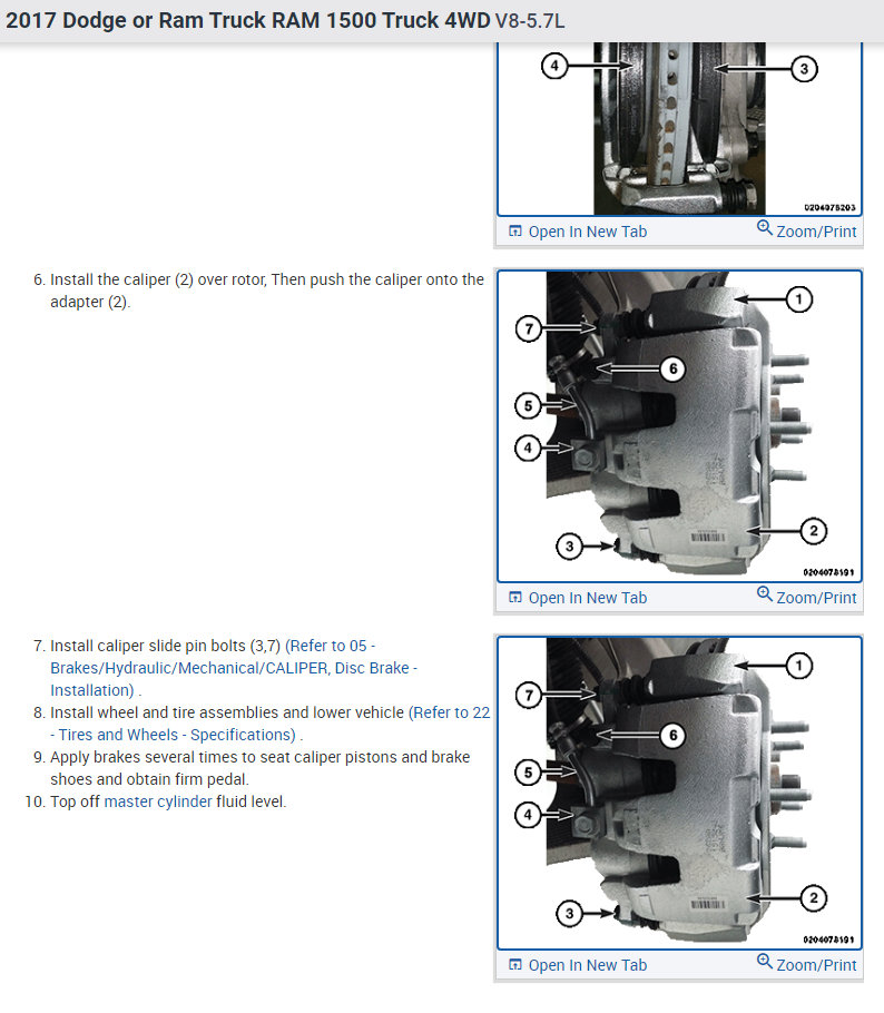

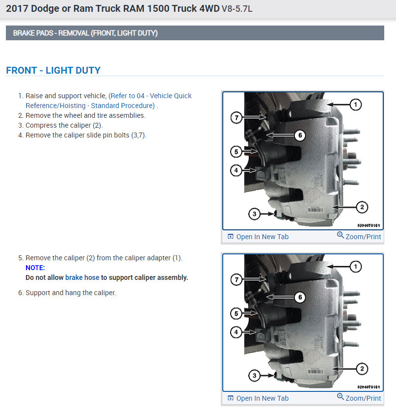

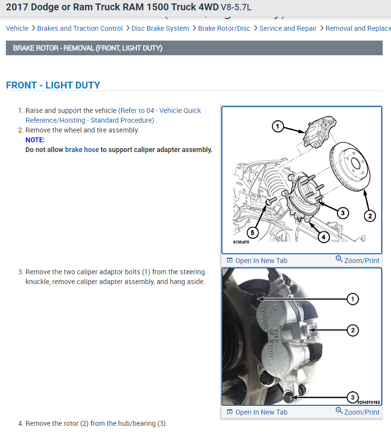

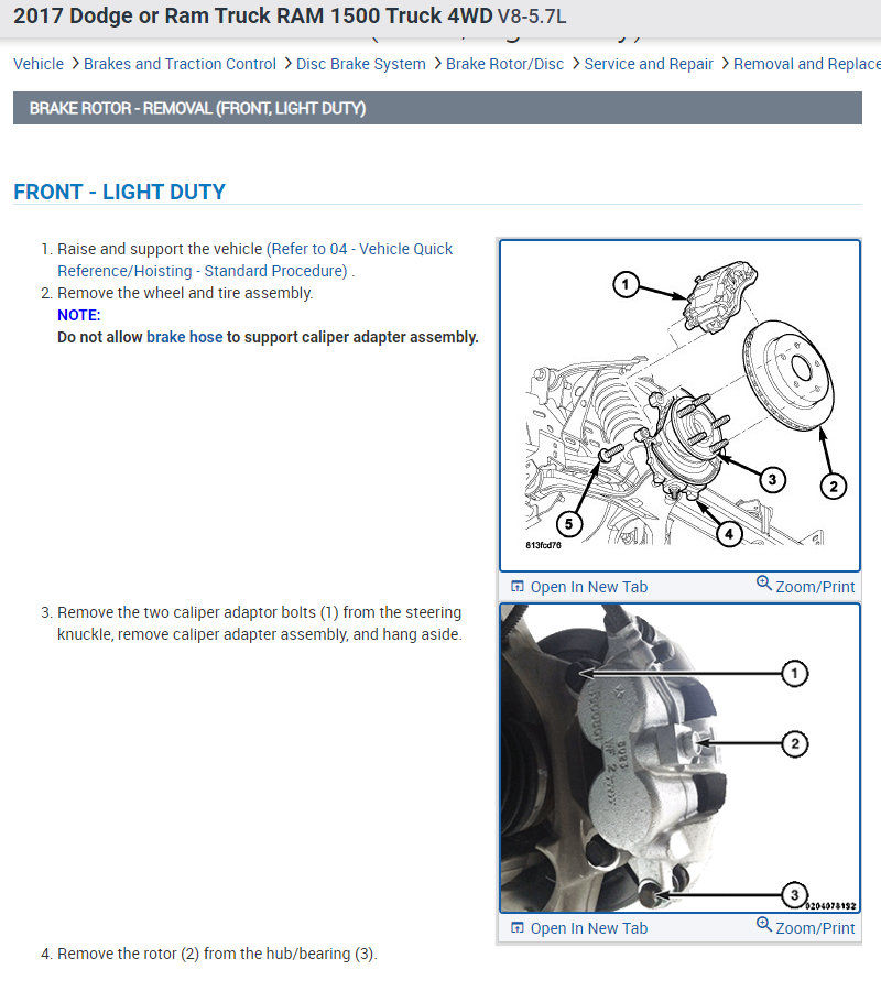

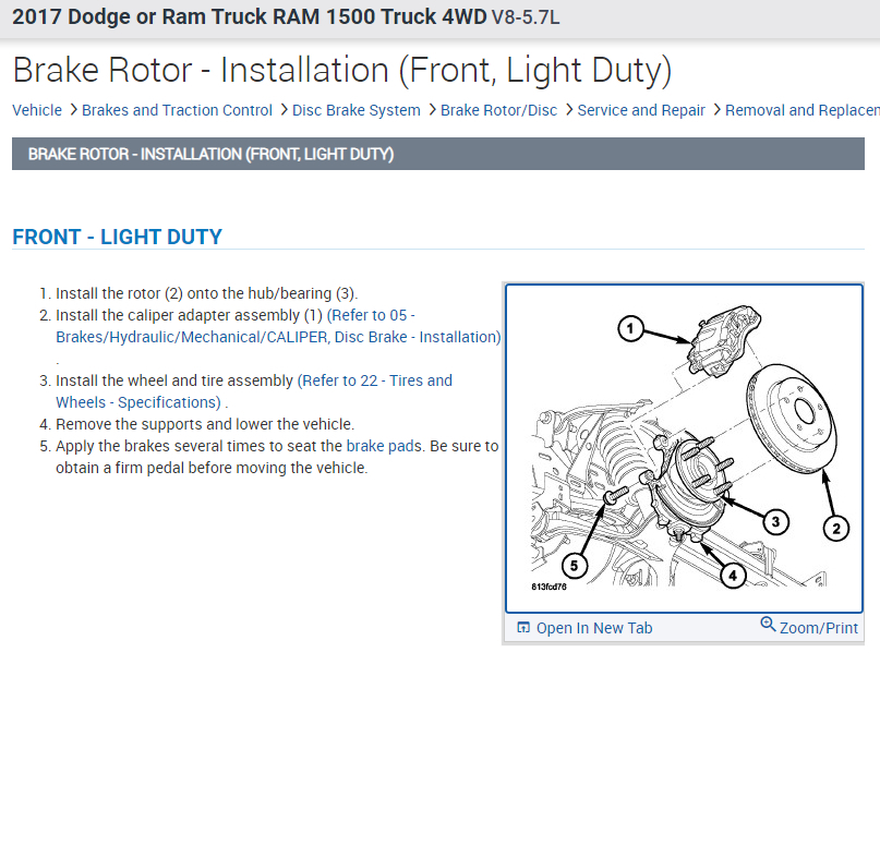

So, I replaced both front brake pads and rotors on my truck (myself). Still getting a bad grinding noise. i double checked my work when I was finishing them up. But I had to use a different style caliper bolt not caliper bracket bolt because one snapped that is the only thing I can think of that could cause it. The grinding happens even when I'm not touching the brakes. Need some help please it's killing me not driving this beauty!

Just to clarify, did you have this noise before replacing the pads?
Also, the bolt that you replaced was it one of the slide bolts or just the smaller standard bolt?
If you had this grinding issue before, it is likely that the caliper is sticking. If the caliper does not release all the way the pads will be in contact with the rotors, and you will hear the grinding noise.
This can be due to a faulty caliper piston or a restrictive brake hose to the caliper.
Let me know what you are experiencing.

Could you tell me how I would check for a faulty caliper piston, or the brake hose? It was just the standard bolt that held the whole caliper in place, and it did start grinding before I changed the brake pads and rotors.

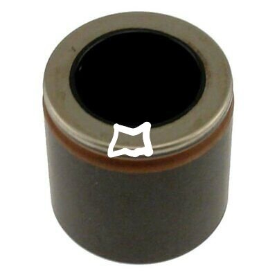

So, my piston on my passenger side the metal ring part is damaged a chunk is missing from that metal ring. would that be what's causing it to grind? I know from putting my calipers back on that the sliding pins aren't seized up.
Oct 8, 2021 at 12:23 PM
SQM
  • CAR REPAIR CONTRIBUTOR
  • 6,383 POSTS
That could be it. Can you upload a picture?

So obviously this isn't mine, but the white shape is where the piston ring is damaged at the top of that ring its missing metal right there.

Unless the seals around the piston is broken/damaged, having a chunk broken on the face of the piston may not cause the grinding noise as you drive without any brake being pressed.
Did the seal look to be damages around the piston?
Oct 8, 2021 at 1:09 PM
KRUPER101
  • 8 POSTS
No, it wasn't at all that was the only thing I noticed.

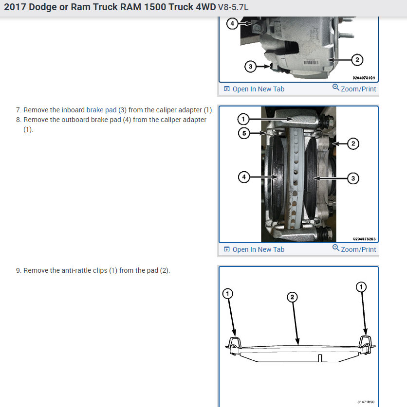

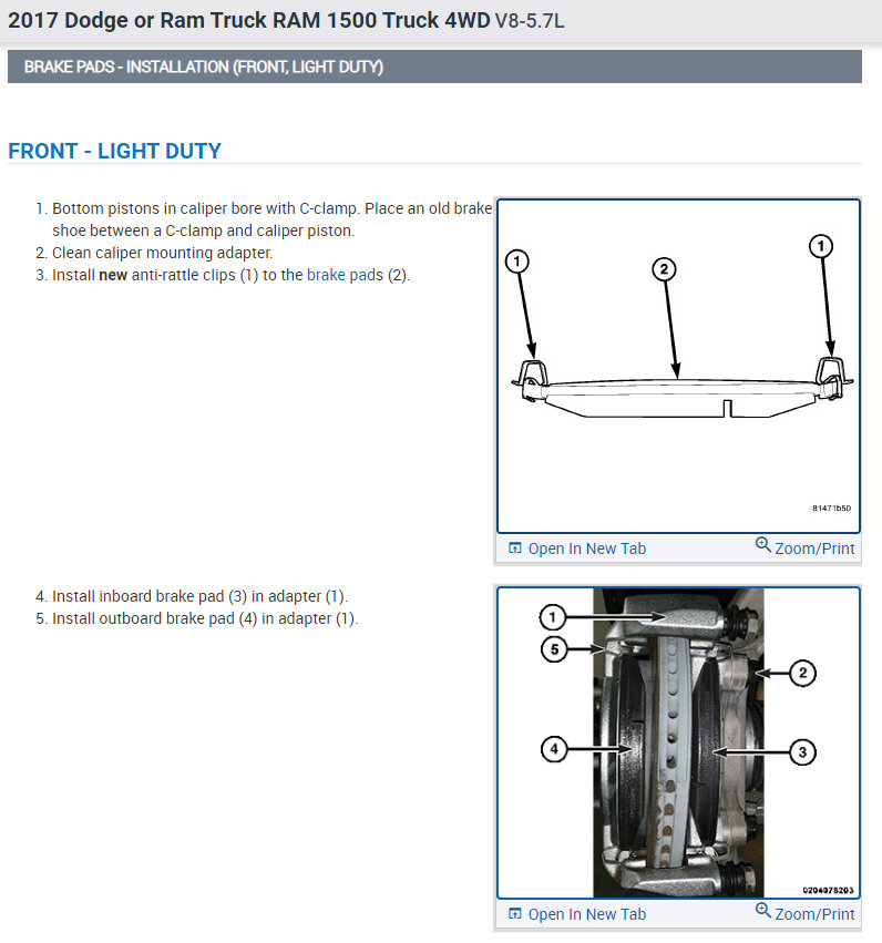

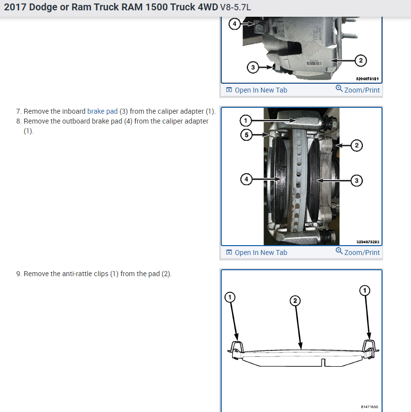

When the brake hose collapses in the inside it can become harder to bleed, when comparing to the other side.
This might be too basic, but make sure that the anti-rattle clips are secured for the pads.
