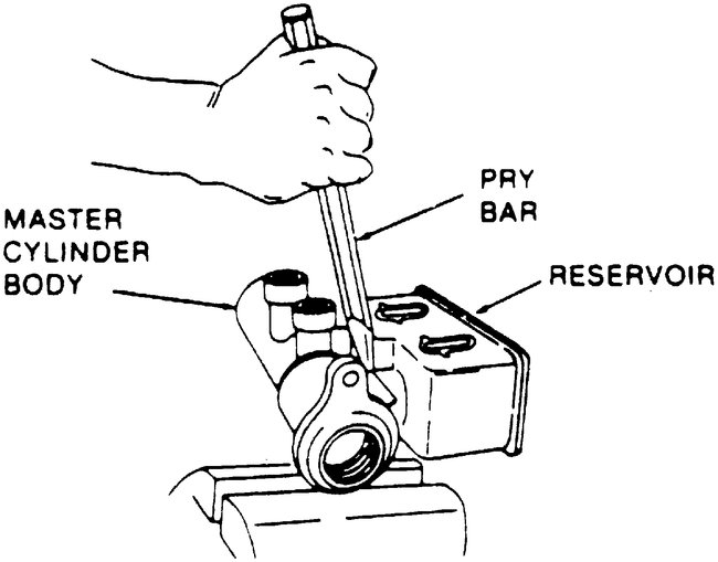

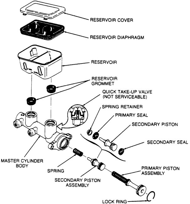

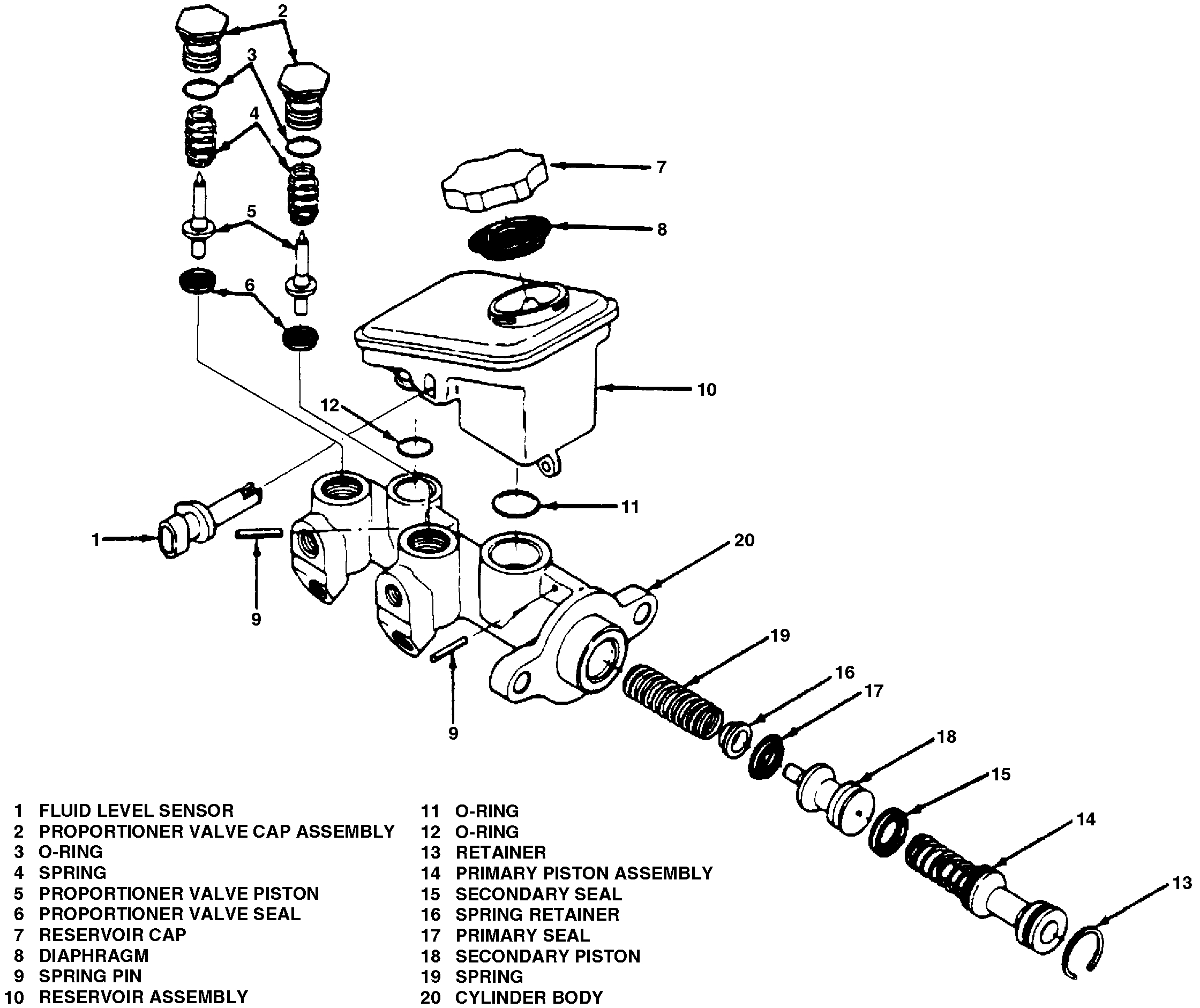

My reservoir was empty and i put fluid in and it leaked out again. When i touch brakes they go almost to floor and the car pulls really bad like its out of line. What can be the problem

Okay, if I understand, the plastic reservoir is leaking where it attaches to the metal master cylinder. There are two rubber reservoir grommets where the two attach which prevent leakage. It sounds like they need replaced.
Here are the directions for taking it apart and replacing the reservoir. I have to be honest, there is a good chance you may not find the grommets needed and will have to replace the master cylinder. Here are the directions. The attached pictures correlate with these directions.

5. On models with compact master cylinder, remove proportioner valve assembly, Fig. 20.

9. Clamp master cylinder in a vise as shown in Fig. 21, then remove reservoir using a pry bar. Remove reservoir grommets.

1. Lubricate new reservoir grommets with silicone brake lube, then press grommets into master cylinder body. Ensure grommets are properly seated.
2. Lay reservoir upside down on flat, hard surface. Press master cylinder body onto reservoir using rocking motion.

7. On models with compact master cylinder, install proportioner valve assembly, Fig. 20.
