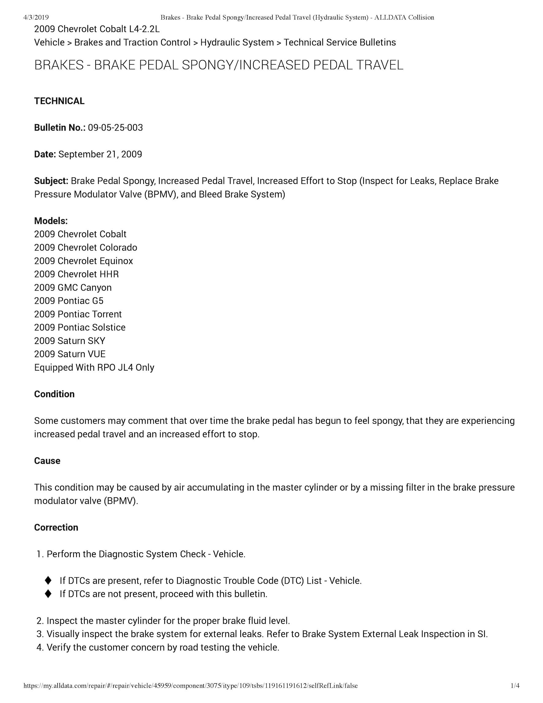

Hey Aoneal10515,

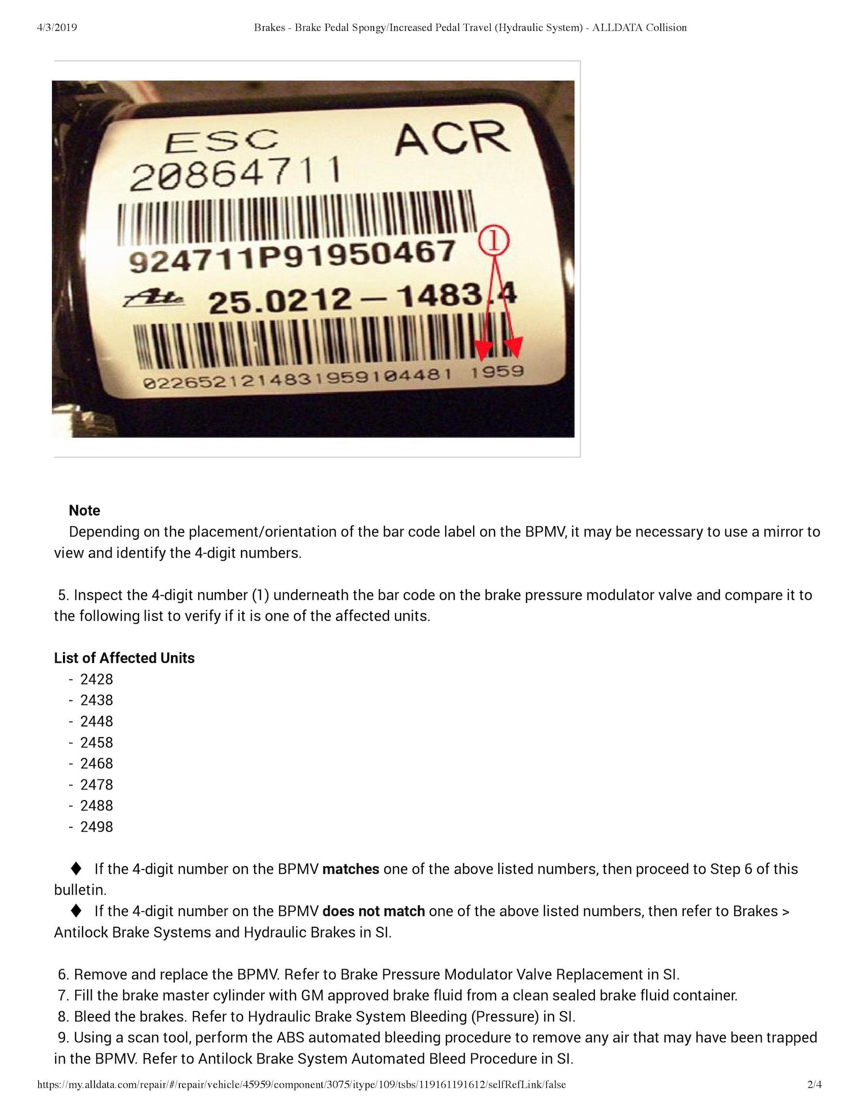

Has the brake pedal only been like this since you replaced the master cylinder?
Or did you replace the master cylinder because of this fault and it did not make any improvement?
Are you sure the car does not have ABS? From what i can see from the year model you should have ABS. There is a specific bleed procedure to carry out when replacing parts on these systems.

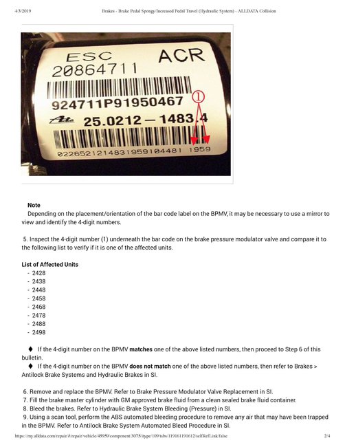

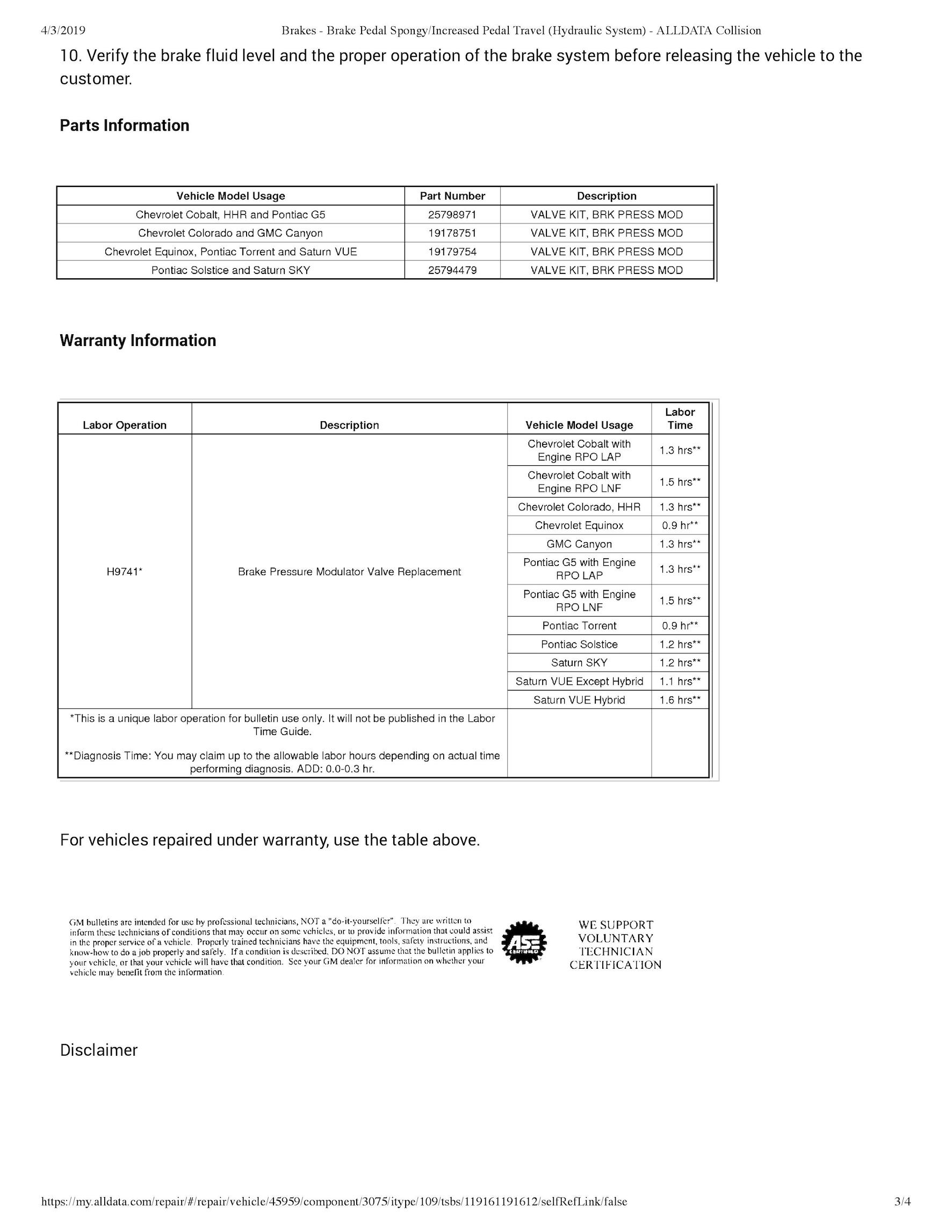

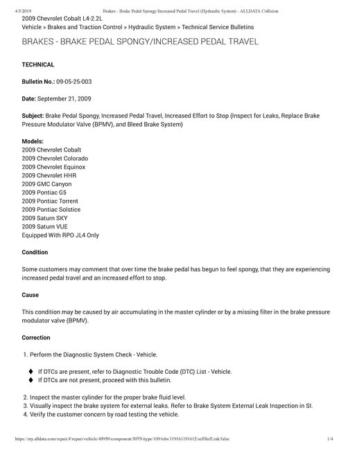

There is a TSB applicable for your vehicle that i have attached below.
Your vehicle may be affected by this and may require a replacement brake pressure modulator valve.I would suspect there is air in the lines. These guides can help you fix it.

I would advise if you go to a Chevrolet dealer and ask them if this TSB is applicable. They can then identify what you may need and quote you on the work.
You can then decide whether or not to have them do the work, get quotes elsewhere or do the work yourself.

Can you please get the TSB check done from my previous message with the brake pressure modulator valve and let me know if that helps.
It looks like this is a known issue that a dealer will be able to carry out for you relatively cheaply and will hopefully fix the issue.

Chevrolet dealership said this TSB did not apply to my car. I replaced front brake calibers today because I felt one sticking. The issue still is there. Is it possible that it is the Brake Pedal Position Sensor?

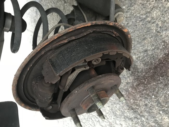

AONEAL10515
  • 21 POSTS
The only part I installed before the brake master cylinder was a thermostat.
I had Wagner pads installed.
After, the brake calipers were done the brake pedal felt worst. Before installing the calipers; I could be fully stopped and fit my other foot under the brake pedal. Now, I can’t.
After the calipers were replaced, it doesn’t get worse the longer I use them.
But now the pedal is going further than before.

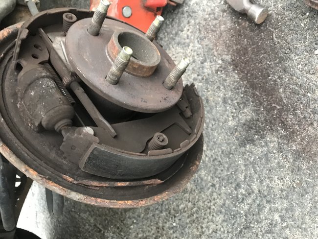

All the brake fluid was flushed when I had the master cylinder done. I have drum brakes. Attached is a recent picture of them from Sunday when I had the calibers replaced.
Tuesday, April 16th, 2019 AT 10:10 PM
AONEAL10515
  • 21 POSTS
Here’s the other side of them.
Tuesday, April 16th, 2019 AT 10:11 PM

If I can jump in here, it looks like the rear shoes are worn out causing the low pedal. here is a video of the job being done on a similar car which shows how to adjust the new shoes once you have replaced them:
https://youtu.be/1j7qDoi1LP0
Wednesday, April 24th, 2019 AT 12:33 PM
