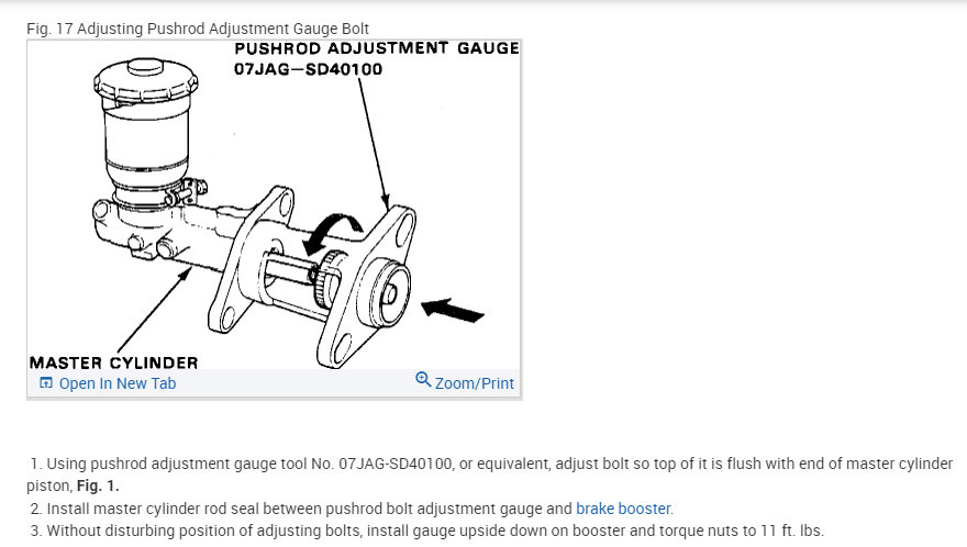

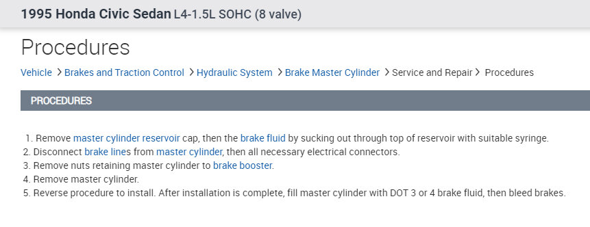

The pic below are the very basic directions from the manual.
Let me know if this helps or if you have questions.

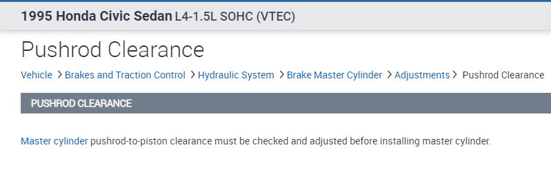

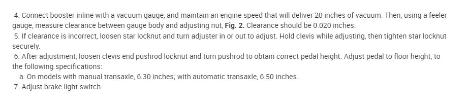

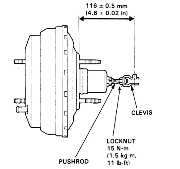

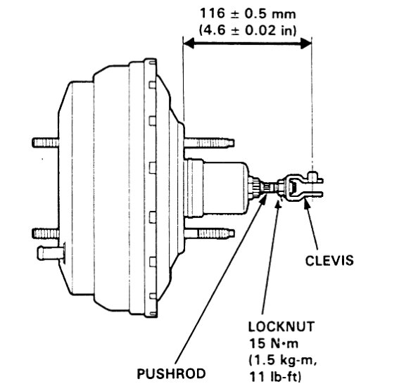

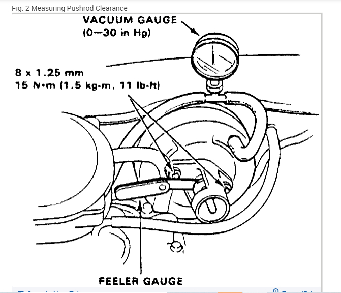

I suspect it is the master cylinder that has failed. There are plungers in the MC that can fail and allow fluid to bypass them. I believe there is an adjustment on the push rod, but you didn't remove the MC, so that shouldn't be an issue.
That leaves the master cylinder. If there are no leaks, the rubber brake hoses at the front calipers aren't expanding, and the fluid level in the MC doesn't go down, the master cylinder is my first suspect.
I attached information related to the push-rod adjustment and clearance. Take a look below. However, unless you had things apart, I don't feel this is the issue.

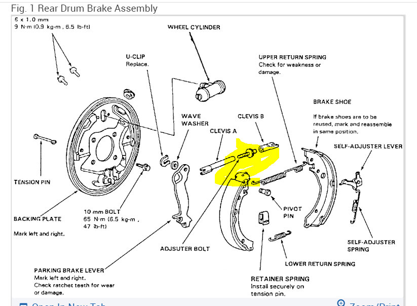

How are you supposed to use the auto adjust or is it easier to do it manually?
Sunday, August 13th, 2023 AT 6:34 AM
  • 110,192 POSTS
I attached a pic below showing what I believe you are dealing with. As far as the self-adjuster, it is supposed to adjust when you back up and hit the brakes. I've never seen them work correctly.
Do it manually. Remove the drum and measure the inside of the drum and the outside of the shoes. Install the drum and before putting the wheel on, get in and pump the brakes a few times to seat the shoes and then recheck them.

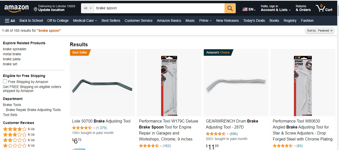

They make what is called a brake spoon. Is that what you are using? Are you able to see the adjuster with the plug removed?
Let me know. I attached a pic of the tool I'm referring to.
See pic below.

I'm familiar with the tool, but you cannot see the adjuster through the hole. The brakes work very well so it's all good. This car I'm told won't see 3,000 miles in the next 5 years, lol. That would make it a Civic hatchback with 126,000 miles, circa 1995.
