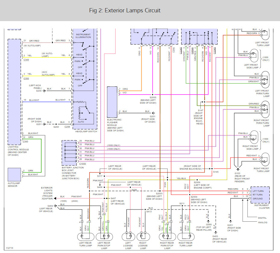

All three brake lights went out on our Mercury Villager. We have checked and there is power to the fuses, brake light switch as power as well and checked the bulbs. All lights are working on the vehicle except for the brake lights including the third one on the hatchback. Please HELP!

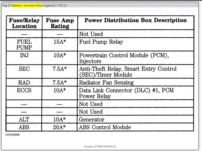

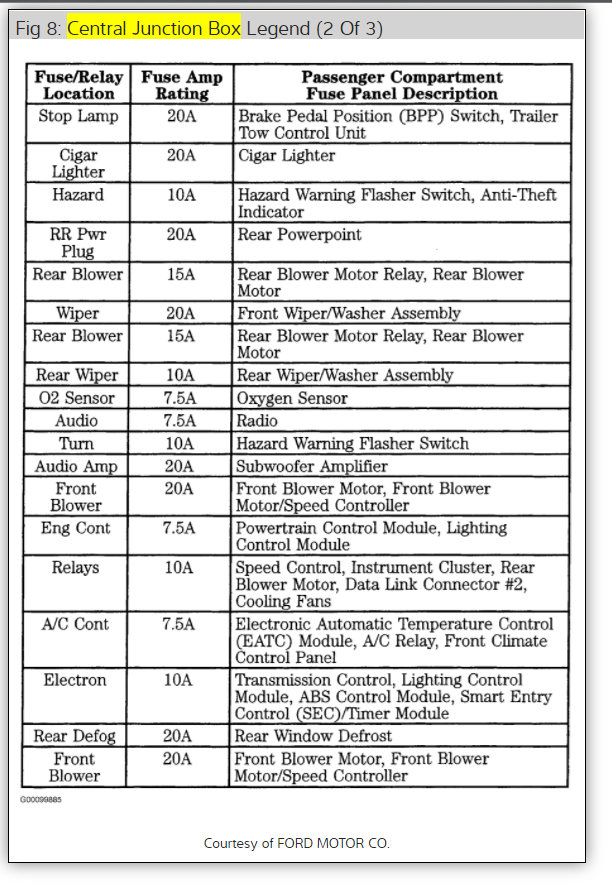

Hello, Please recheck fuse #51 which powers the system here is a guide to help get the job done.
Here is a guide to help see where you lose power at
Please run some tests and get back to us.

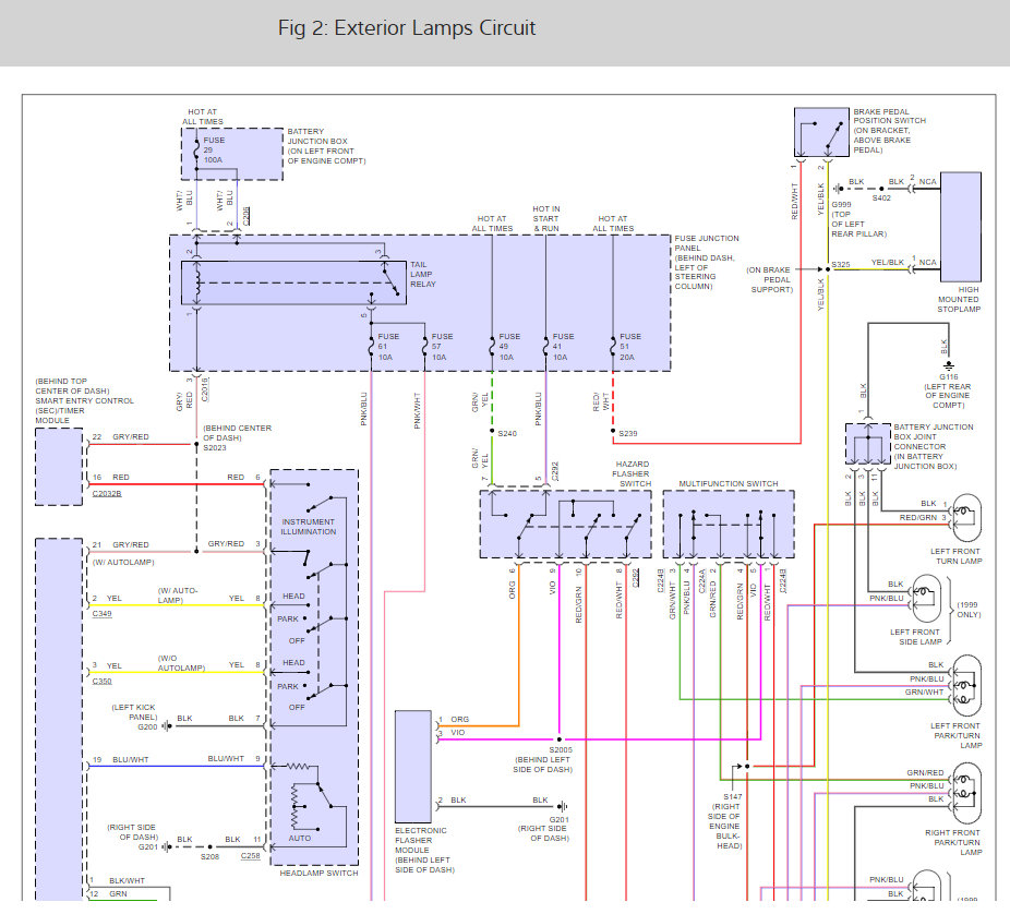

After perusing the wiring diagrams I have to recheck which switch is brakes the plug I pulled had blue and white wires where as the diagram says yellow/black and red/white. Nasty weather today so may take me couple days

Yup WRONG SWITCH! I guess it was CLOSEST! So now to check the right switch! If I had known the wire colors from getgo!

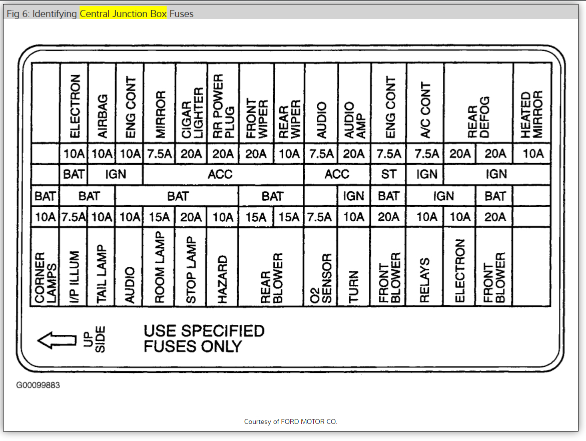

Do you have power at fuse #51?
Saturday, January 5th, 2019 AT 10:56 AM
FIXITMR
  • 9,990 POSTS

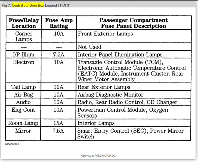

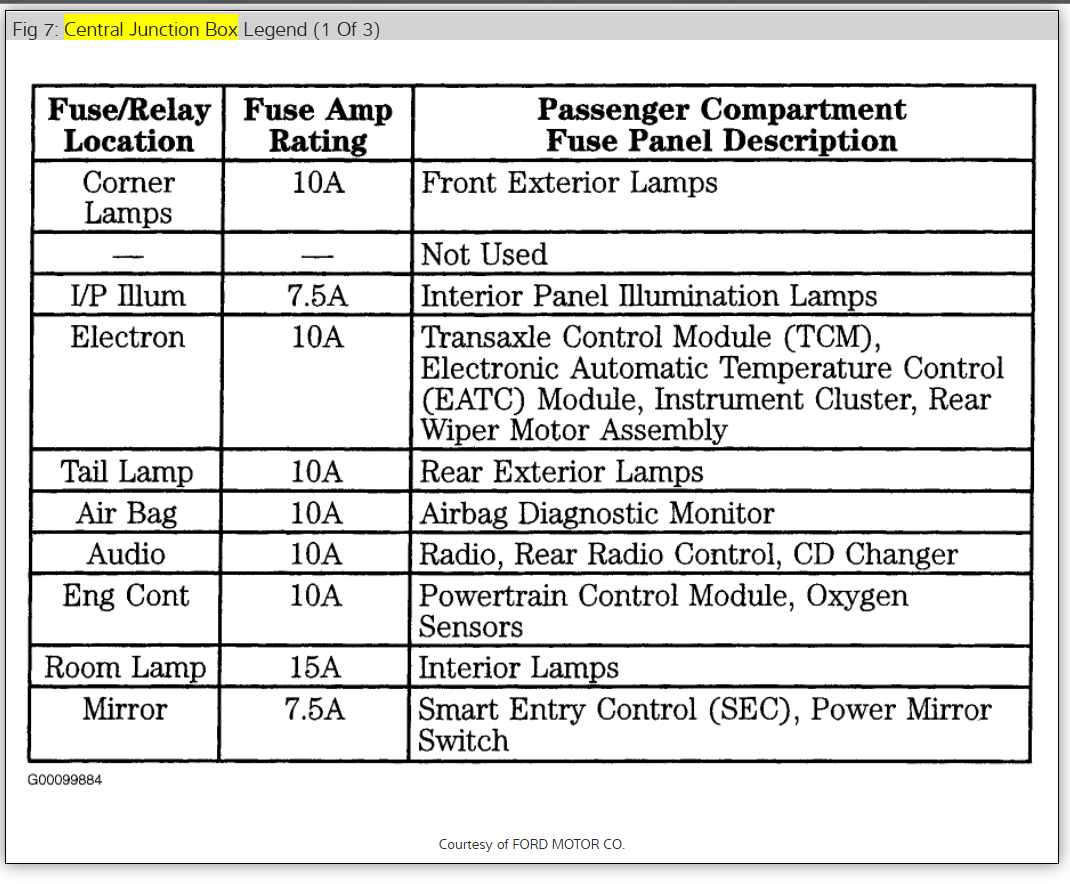

Dont know where that fuse is! My fusebox down left of steering wheel is not numbered? 10 amp says stop lamps on lid is good!
Saturday, January 5th, 2019 AT 12:15 PM
FIXITMR
  • 9,990 POSTS
Ok my fusebox is #6 figure somehow I got confused and checked tail lamp fuse but NOT stop light fuse!Or I pulled it and missed the blown section cuz design is different! I just pulled it cuz it was aftermarket fuse and yup its blown! Tested lights they work but then I went to store and dash light came on again!

So in conclusion after determining which diagrams applied to my vehicle and correctly identifying the offending fuse and changing it i'm back on road! And the dash warming light has NOTHING to do with brake lights!
