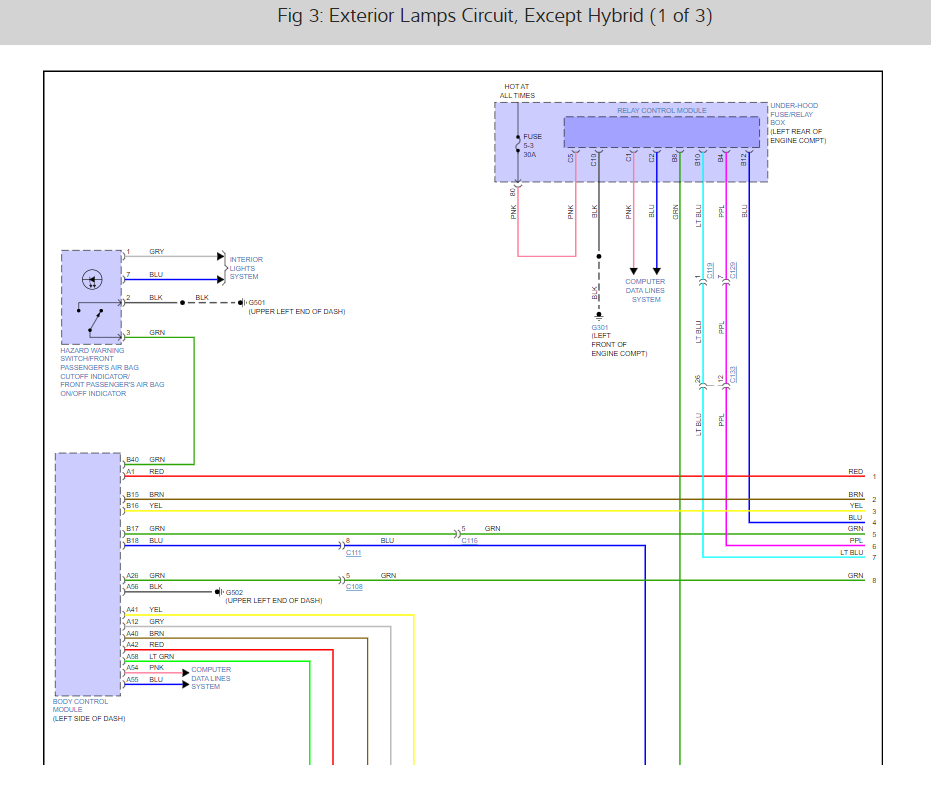

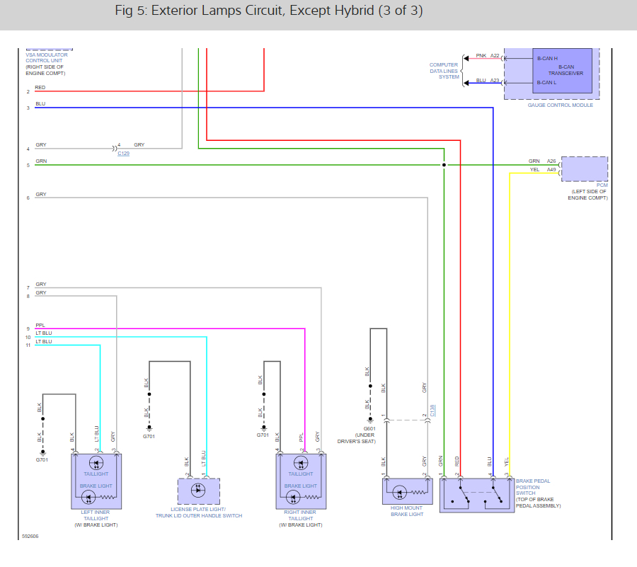

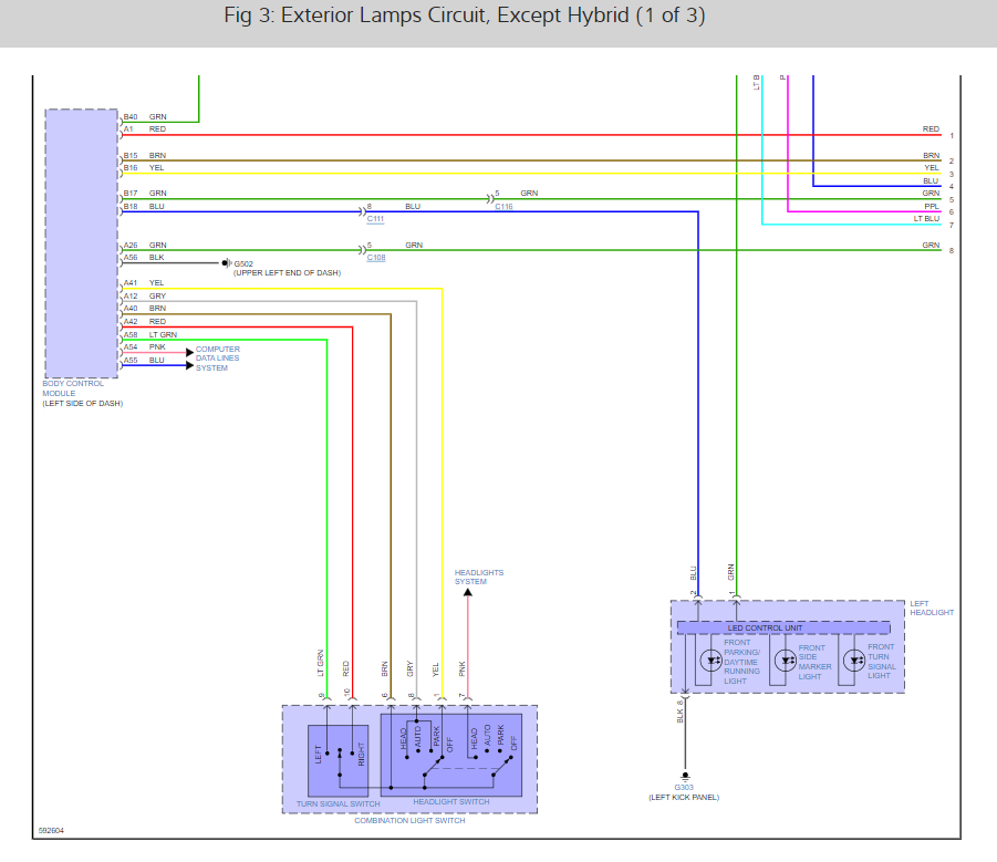

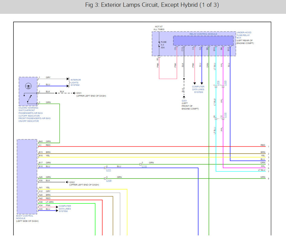

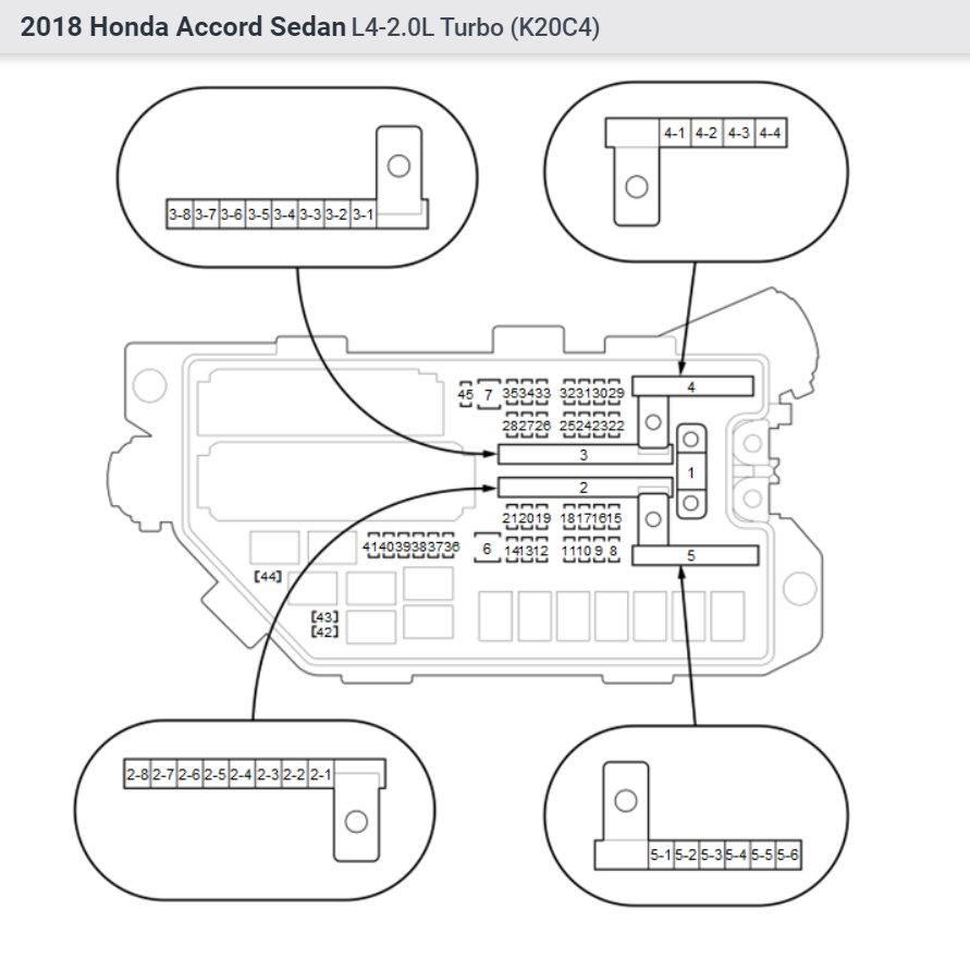

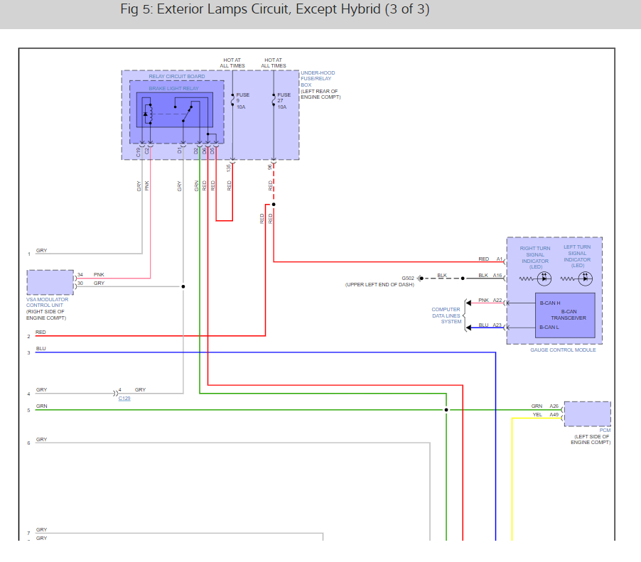

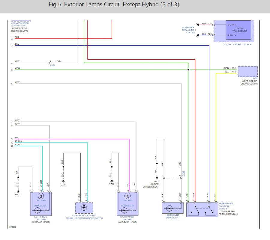

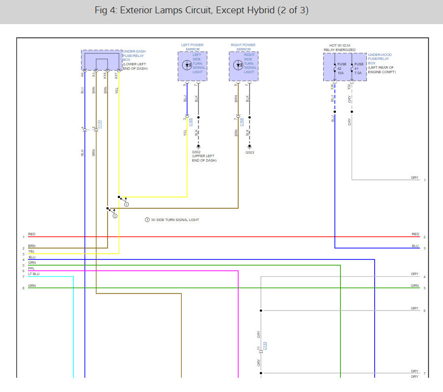

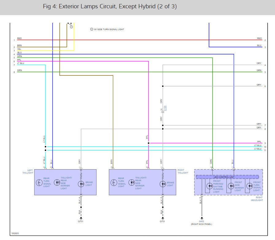

So, there is a fuse # 9 and a brake light control relay under the hood in the fuse panel by the left side of the engine bay that controls the system. here is a guide to check the fuse and the fuse and relay locations in the images below. Also included the brake light system wiring diagrams so you can see how the system works. Apparently, the brake light relay is part of the circuit board inside the fuse panel under the hood.
Check out the images (below). Please let us know what you find. We are interested to see what it is.

I checked fuse #10. The fuses are good. A pin on the Haynes slipped out.
