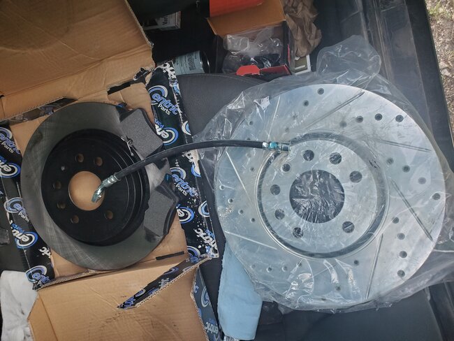

Here's a picture of all the month new parts that the mechanic was supposed to install and never did
Sunday, September 7th, 2025 AT 7:20 PM
KEN L
  • MASTER CERTIFIED MECHANIC
  • 55,481 POSTS
Yep, those look like good parts, did you want to try installing them yourself? We can help walk you thought it, CARADIODOC and myself ;)
