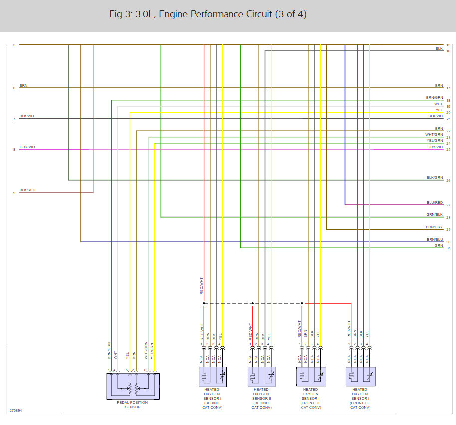

P0036 Heater Control Circuit B1 S2 = Broken or open heater control circuit.
P0037 Heater Control Circuit Low B1 S2 = Shorted to ground heater control circuit.
P0056 Heater Control Circuit B2 S2 = Broken or open heater control circuit.
P0057 Heater Control Circuit Low B2 S2 = Shorted to ground heater control circuit.
Do you have twelve volts at the red wire/white stripe on each sensor?
Check to see if the brown wire is grounded with the key OFF.

The first codes you had (P0036, P0056) both indicated a problem with the heater control circuits. Then after the exhaust and changing the sensors you now have P0037 and P0057, Both of those codes still indicate a problem with the heater control circuits, this time it's low voltage.
The battery voltage should be the same to all 4 sensors as they all use voltage from the same fuse. The heaters are turned on/off by the PCM using the Brown wires to ground them. The codes say that the voltage the PCM expects to see on that wire isn't correct.
Were the sensors you used OEM units or after market? It's possible they are just enough different that the PCM thinks they are bad, even if they are working.
BMWs can be temperamental like that. If the OEM sensor is 4 ohms and the new sensor is 5 ohms the PCM will see a lower voltage then it should. Even though the heaters are working you will get a code.

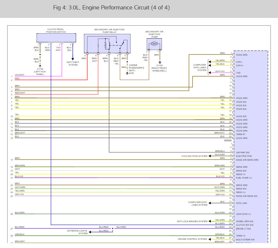

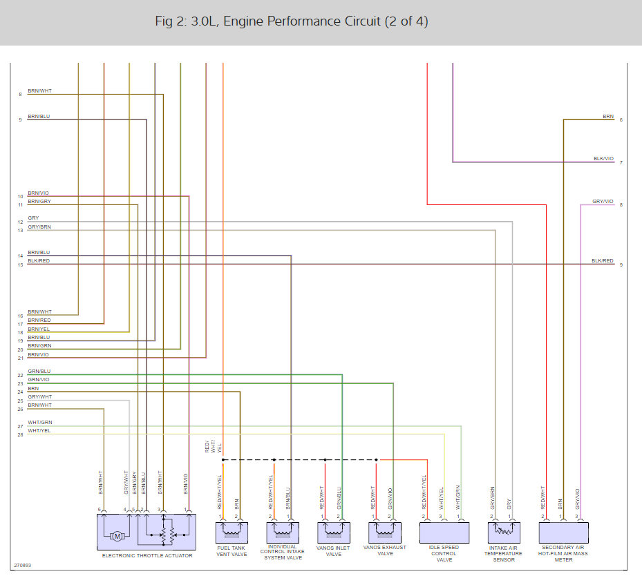

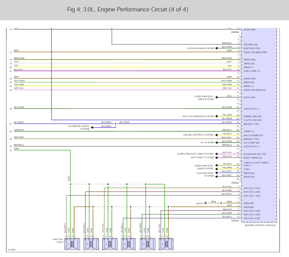

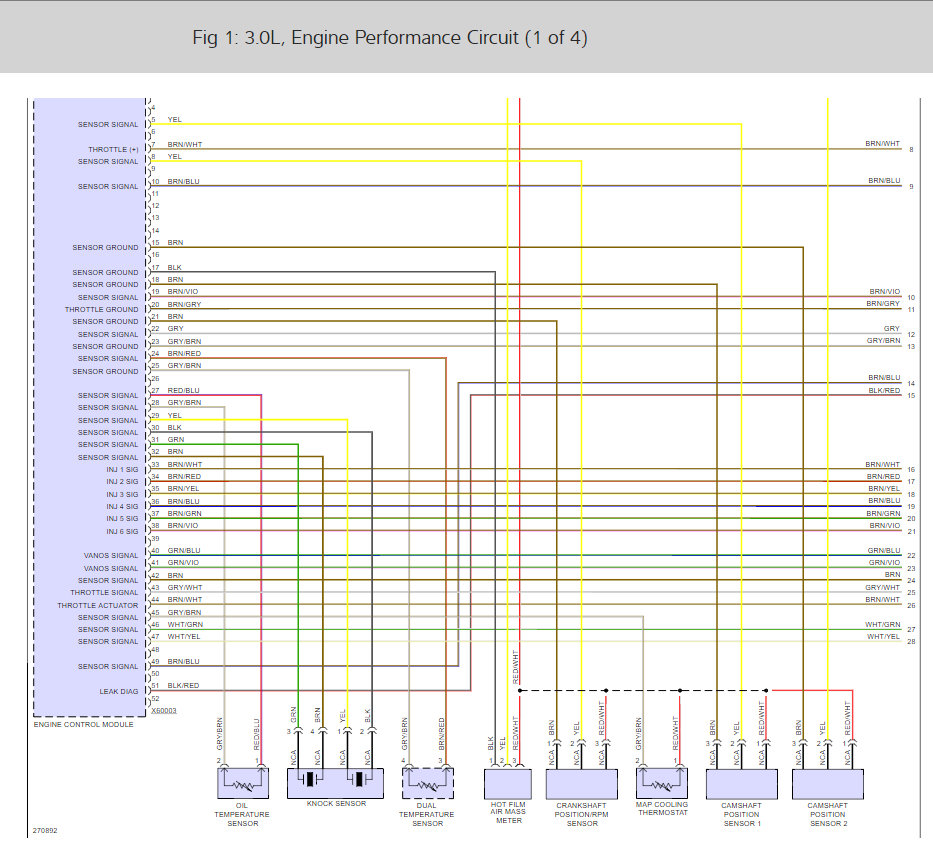

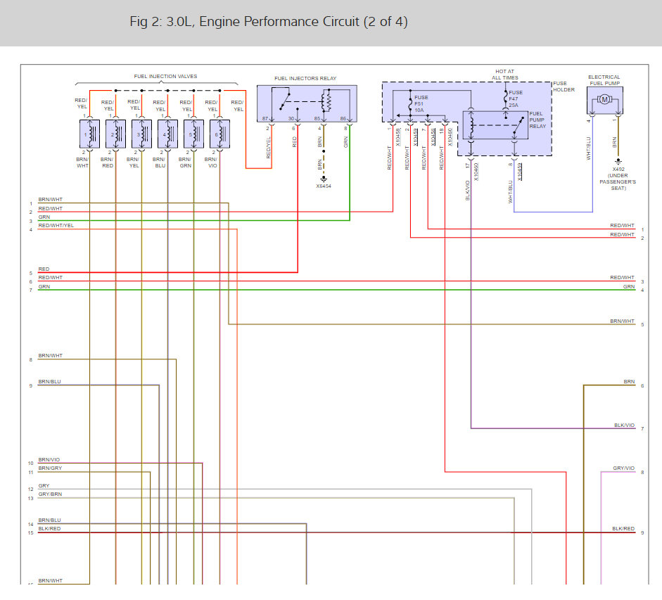

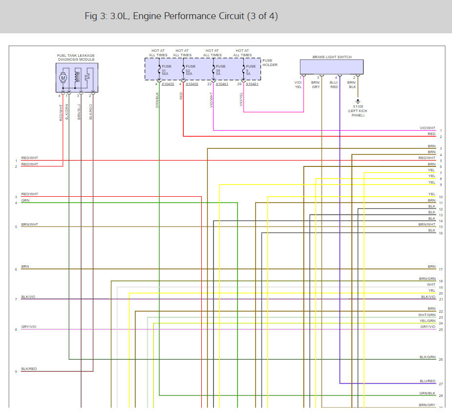

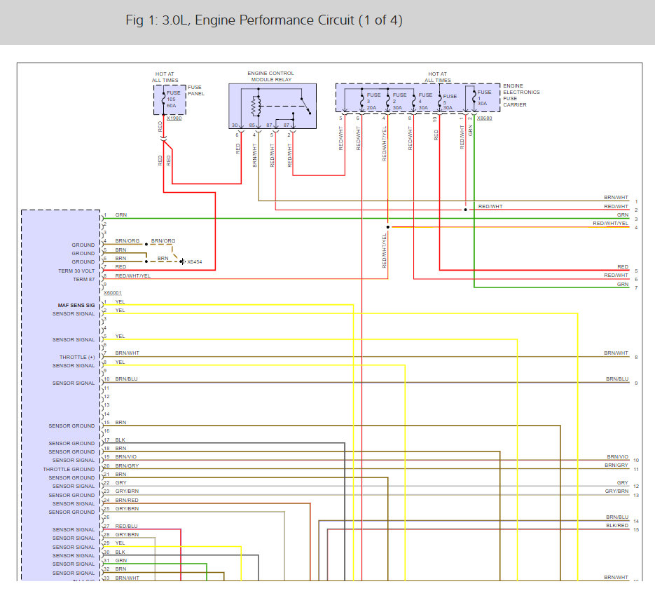

I was going to suggest the same thing its time to check the wiring. Here is a guide to help you see what you are in for and the engine wiring diagrams (Below) so you can get the job done.
