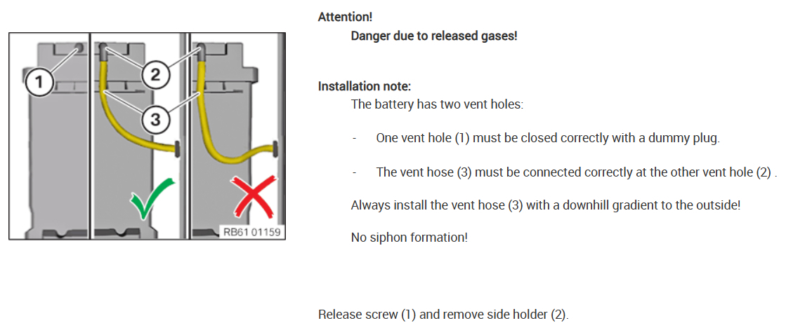

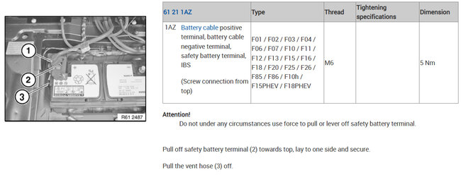

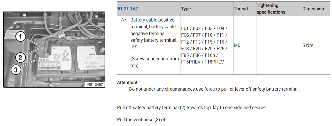

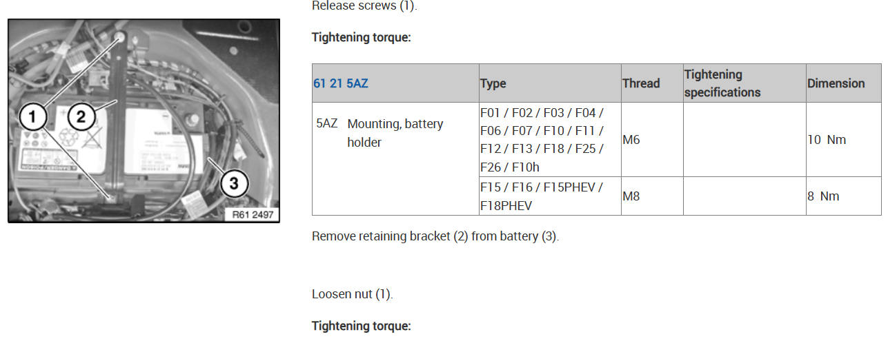

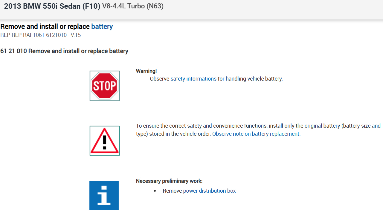

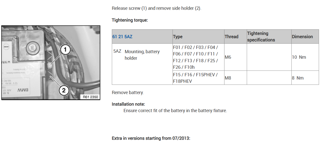

The "rattling" is the concern which can cause all of these codes but the low battery voltage. If the battery is bad, it may even have an effect on the engine misfire, glow plug and camshaft codes. I would upload a short video of the engine noise from under the hood so I can hear what the problem is, and I would remove the battery and have it tested at the local auto parts store. Here is how to remove the battery and its location which is in the trunk. Be sure to clear the codes if they find the battery needs replacement. Check out the images (below). Please let us know what happens.

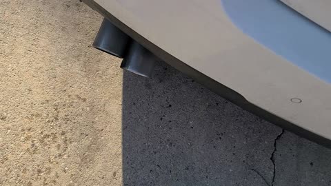

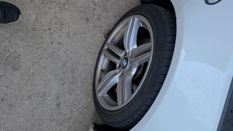

Thanks for replying. I replaced the battery which definitely helped. Thanks for that tip. The car is still rattling which I've uploaded some videos of the engine and exhaust.

Yep, it sounds like the camshaft actuators, turbos or the engine is having a valve issue. The turbos can cause the noise out from the exhaust. But I think we should do a compression test to see if the engine is okay. I have seen dirty and low engine oil cause the actuators not to work so I would change the oil and filter to see if that helps.
Here is a guide to help check the compression:
Please go over this guide and get back to us.
