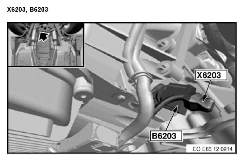

My car was running just fine I parked it and came back on the morning and it would not start. I have no idea what it can be I'm getting fuel but no spark. It just cranks and cranks but won't start.
Jul 3, 2010 at 5:02 PM
  • 75,992 POSTS

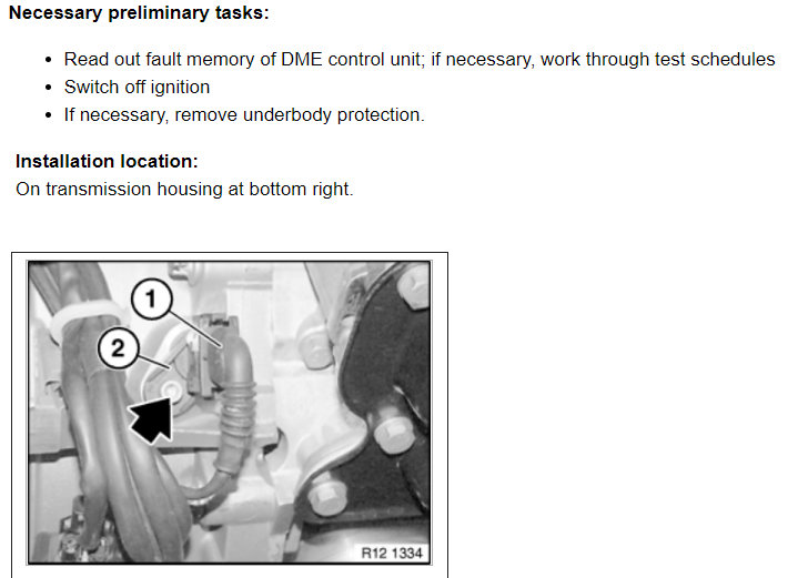

Please check for spark first here is a guide.
If no spark I would change the crankshaft angle sensor. Here is a guide to help with diagrams below to help you see how it is on your car.
Cheers
Oct 19, 2018 at 5:05 PM
BPLATT23B
the crankshaft sensor fixed it
