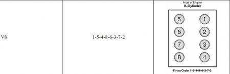

witch side is the #1cyl located an is 234 on same side

Hi srbstn2256,Welcome to 2carpros and TY for the donation.
See below:
