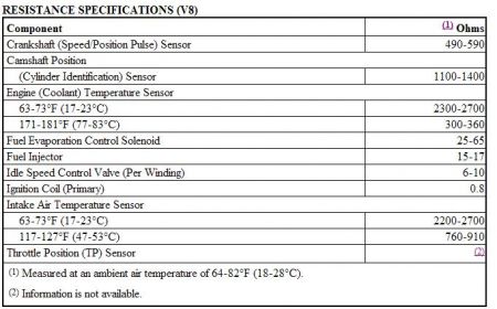

I have replace the idle control valve yet is still show P0505 I have done every thing I can think off. Please advise

Check resistance of the connector to the Idle Speed Control Valve. Some models use a 2-pin connector while others use a 3-pin connector. Below is a reference chart for what the resistance should be wether you have the 2 or 3-pin connector..
https://www.2carpros.com/forum/automotive_pictures/261618_Noname_367.jpg

I don't know what to look for or what to do I change everythink yet the idle is still high and code p0505 is on. I have check everywhere for leakage in the hose. Please advise

You said I should Check resistance of the connector to the Idle Speed Control Valve. What did n need to change it with.

Was the resistance incorrect?
