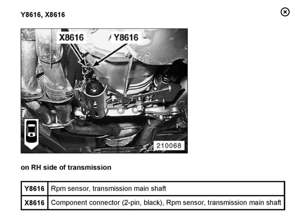

Transmission problem 6 cyl Two Wheel Drive Automatic 90000 miles
Dear Sir
I have a question regarding the message shown on the display screen in my car, it is " transmission malfunction " it appears sometime when I am driving in the traffic, while using automatic system, not typtronic, my car seems to be working on the 4th level, slow and could not take more speed while the message appears I park the car, stop it and then turn it on, the message disappear and the car work normally please I need to know about the problem because many mechanics advice to change the sensors in the transmissions and other advice to check other items in it.

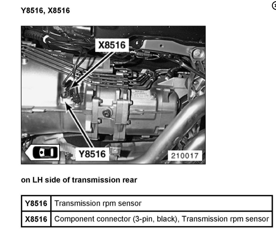

This sounds like you have a a problem with a input or output speed sensor. We should run the codes to see whats come up and then go from there.
Here is guide to get us started.
These cars had big problems with the sensors here is there location (below)
Cheers

Yep I don't know why he private messaged me but he said that did the trick and the car is working once again!

I did the sensors and my problem went away. I had the same message on my car about the transmission malfunction.
