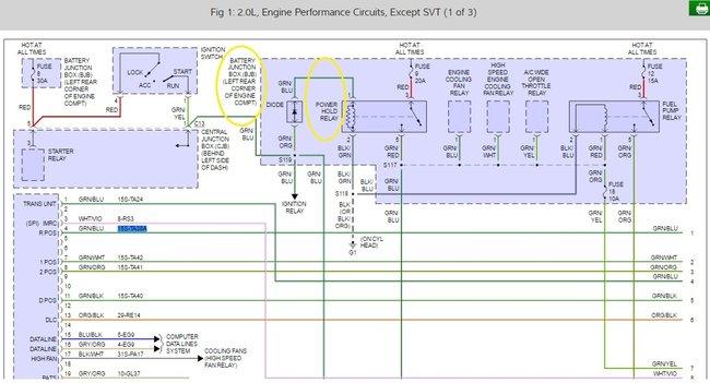

I do not know but something is cause the #9 fuse in the under hood fuse box. It says in the manual it is 20amp big fuse for engine management. So I change it and when I restart the car it starts rev up once and blows that fuse after not even two seconds. Still have all power, but turn key and nothing. Please help

A simple trick to finding a short is to replace the blown fuse with a pair of spade terminals, then use small jumper wires to connect them to a 12 volt light bulb. A brake light bulb works well. When the circuit is live and the short is present, the bulb will be full brightness and hot so be sure it is not laying on the carpet or against a plastic door panel. Now you can unplug electrical connectors and move things around to see what makes the short go away. When it does, the bulb will get dim or go out.
For intermittent problems like yours the bulb may be dim already. Watch what takes place when it gets bright. That is when the short is occurring. It could be due to the rocking of the engine when you shift between reverse and drive. It could be due to the body flexing when you drive over bumps in the road. The bulb limits current to a safe value when the short occurs, in this case about one amp. If the engine will not start with a brake light in the circuit, try a headlight bulb. The low beam filament will limit current to five amps, and the high beam filament will allow about six amps to flow. That is still low enough to prevent doing damage to the circuit.
I will dig up a wiring diagram to figure out what the likely suspects are.

I think we are going to have to approach this a different way. There are just way too many things on this circuit. We need to bypass the "Power Hold" relay. That will allow you to run the circuit without trying to run the engine. You can do this by removing the relay, popping the cover off, reinstalling it that way, then squeezing the contact or holding it squeezed with a rubber band. You can also remove it, then install a jumper wire if you can figure out which two terminals to jump, or you can install a new fuse, then install my light bulb and jumper wires in place of the relay. Any of those things will work and will avoid blowing more fuses. All that is needed is the test bulb is in place of the fuse or the relay.
The relay terminals that must be connected together in the socket are numbers three and five on Ford's wiring diagram. I'm including a drawing of the common Chrysler relays with their numbers. If your relay looks like either of these, use the drawing to figure out which terminals to connect.

I cannot find the power hold relay.

Your vehicle has a 2.0 Liter engine, not a 2.3
I grabbed part of a diagram from 'Prodemand' showing the relay and its location.
See diagram below.

Hi CJ. How are you copying and pasting the diagram? That is the same one I was using, but I cannot copy them.
If you follow the red/green wire from terminal five of the relay, you will see it goes to four other relays. Three of those can be removed and the engine should still run. I suspect the fourth one, for the fuel pump, does not have the short because the engine does run at times. Regardless, my test bulb in place of the fuse would no longer be full brightness if the short is removed by removing those first three relays.
After that, if you follow the red / blue wire down to the lower half of the diagram, you will see it feeds all kinds of things. The engine is not going to run with my bulb in place of the fuse. Not enough current will be able to get through, so we need to energize the circuit manually and leave the engine off. That is where bypassing the relay comes in. As you eluded to, this is way easier to do than it is to describe.
The alternative is to disconnect or remove one of the dozens of items, plug in a new fuse, try to start the engine, blow the fuse, and repeat with a different item. Let me know before you do that so I can buy stock in a fuse company! You will need dozens of fuses before you realize there has to be a better way to find what is shorted, and that is with my test bulb.
To answer your question about how this will help, you need a way to know when you did something to remove the short. You can do that by removing things and replacing fuses until the fuse no longer blows. That can take weeks or months of trial and error. You sure would not want to pay a mechanic by the hour to find it that way! You also want a test procedure that does not involve blowing hundreds of fuses, and you need a way to limit current to a safe value. The test bulb does all of these things.
You cannot see how much current is flowing through a fuse, but you can tell how much current is flowing through a bulb by how bright it is. Even with something shorted in the circuit, the most the bulb can be is full/normal brightness. Once you do anything to remove the short, current will go down and the bulb will go out or will become less than full brightness. In most circuits that will be a significantly-lower brightness that is real easy to see. In some case where normal current is relatively high, as in heater fan or radiator fan circuits, the difference between the bulb's brightness with the short in the circuit and without is barely perceptible. That is when it works better to use a head light bulb instead of a brake light bulb in place of the fuse. A brake light bulb will be full brightness when it passes the one amp it is capable of. A head light bulb will be full brightness when it passes its maximum five amps. That is still well below the rating of the 20-amp fuse it is temporarily replacing, and will protect the wiring just fine.
