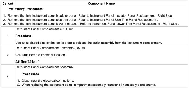

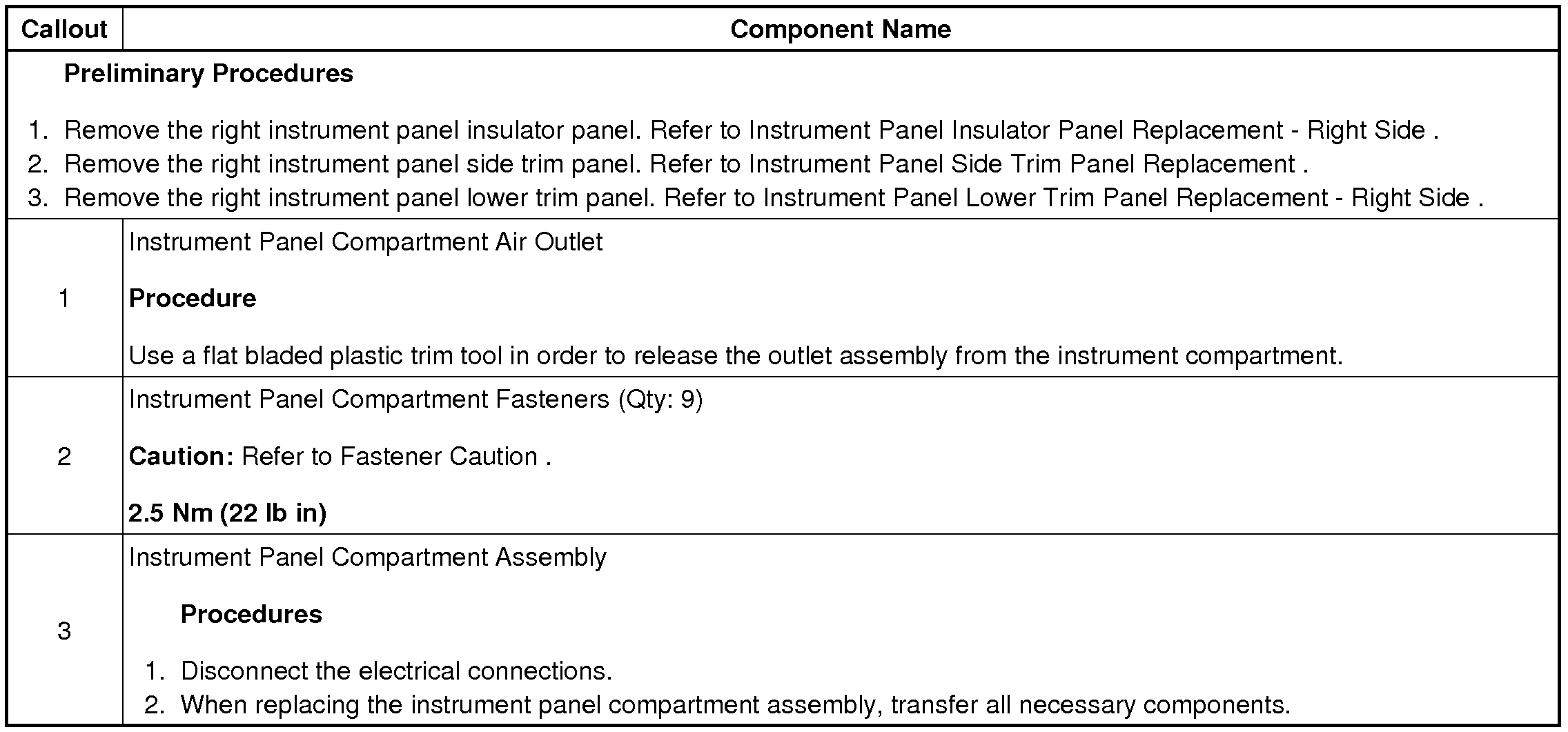

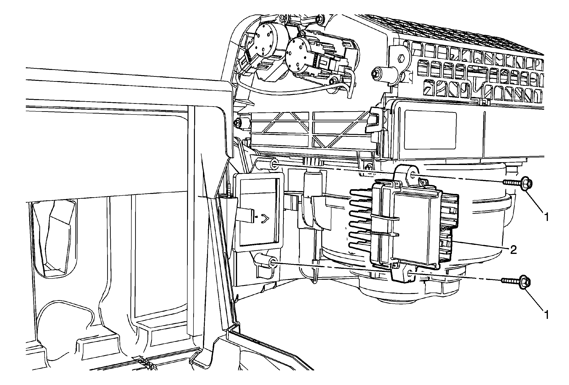

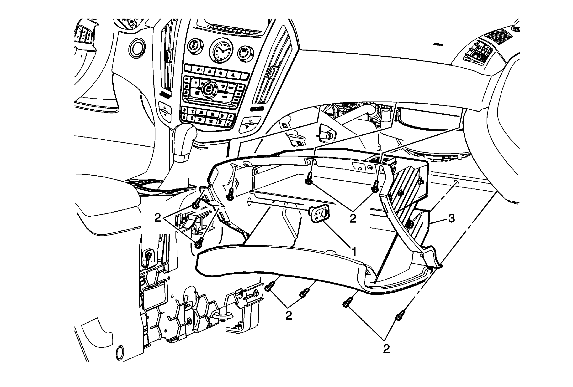

How do i access this? it appears the glove box is in the way for the top bolt. i have taking all bolts out of glove box still wont come out.
Jan 5, 2019 at 12:07 PM
  • CAR REPAIR CONTRIBUTOR
  • 110,190 POSTS
Here are the directions for removing the instrument panel compartment. The attached pictures correlate with these directions. The directions are picture 1. Pictures 2 and 3 show the locations of the retainers and the module.
