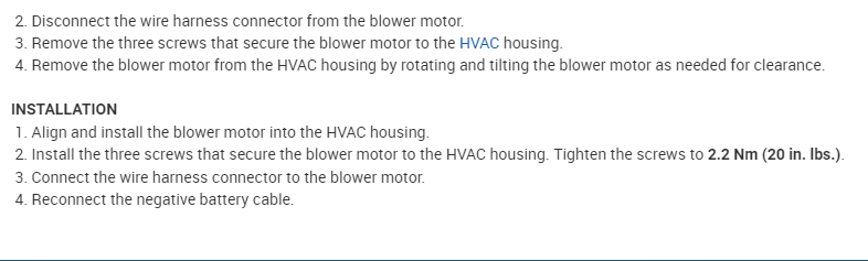

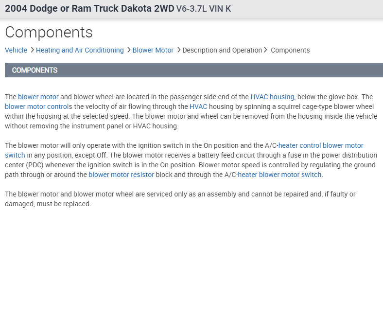

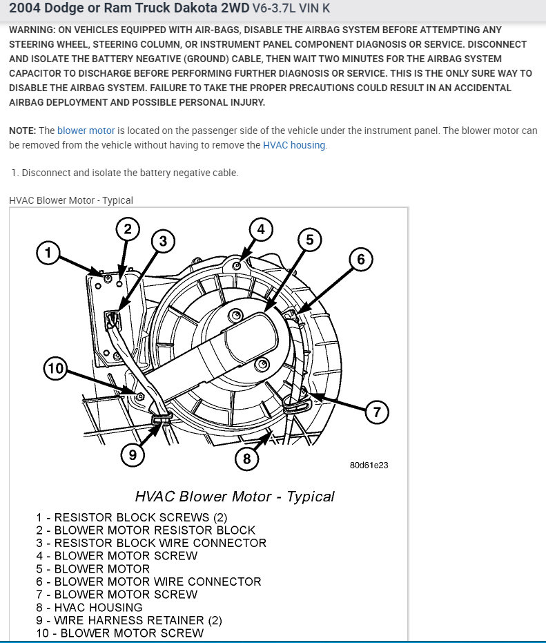

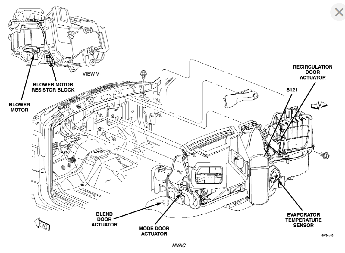

Sounds like this could be a connection issue or internal loose or worn components for the blower motor or the resistor.
A good first step would be to access the blower motor and make sure the wiring harness is secured.
Look for any corrosion or pushed out or burn pins.
Over time due to a loose connection, you will have burnt pins.
https://www.2carpros.com/articles/blower-fan-motor-works-on-high-speed-only
Please let me know what you find or if you have any questions.
