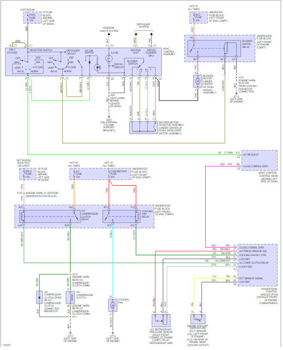

Hi Quin71@live.com, my name is Alex and I will be helping you today. It sounds to me like your blower motor may have gone out.
Here is a great link on blower motors and a wiring diagram of your vehicle:
https://www.2carpros.com/articles/blower-fan-motor-works-on-high-speed-only

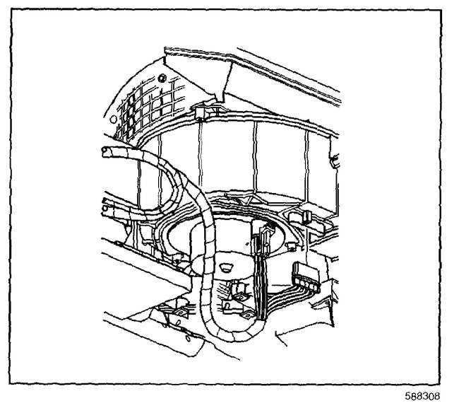

First, if it only worked on high, the blower motor resister needs replaced. As far as struggling, it sounds like the blower motor may have failed. Honestly, the motor most likely was going bad and drawing too much power. That is the likely cause of the resister failing.
Here are the directions for replacing the resister. This can be done at the same time the motor is replaced because the blower motor needs removed to be able to replace the resister. Everything is located under the dash on the passenger's side.
Procedures
Vehicle Heating and Air Conditioning Blower Motor Resistor Service and Repair Procedures
PROCEDURES
REMOVAL PROCEDURE
See Picture 1
1. Remove the blower motor.
See Picture 3
2. Disconnect the electrical connection at the blower motor resistor assembly.

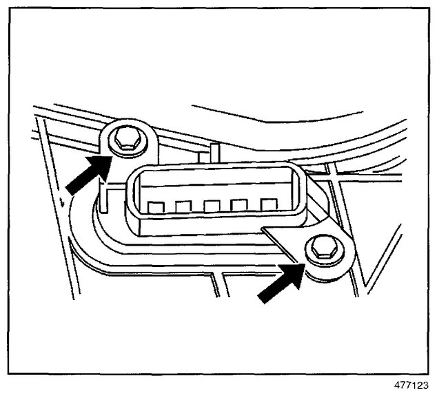

See Picture 2
3. Remove the blower motor resistor assembly screws.
4. Remove the blower motor resistor assembly.
INSTALLATION PROCEDURE
See Picture 1
1. Install the blower motor resistor assembly.

See Picture 2
3. Connect the electrical connector to the blower motor resistor assembly.
