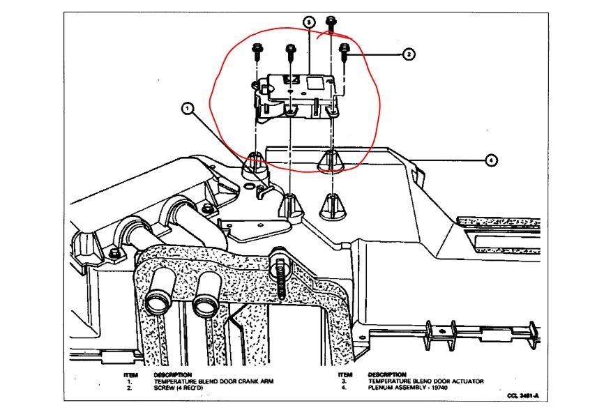

If you clamp off one hose, you will have no heat. I do not know who told you that but that is incorrect information.

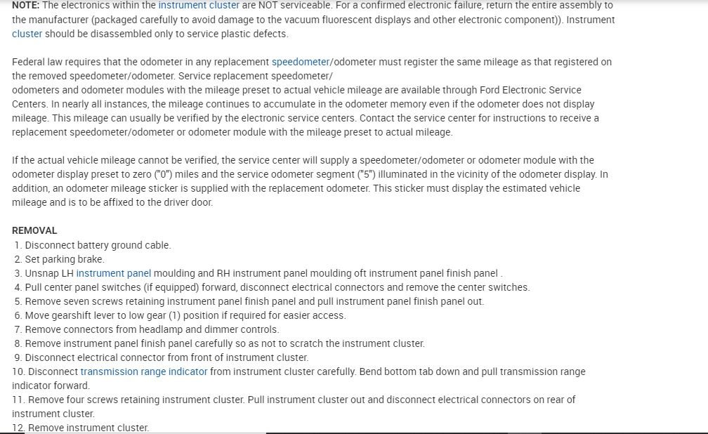

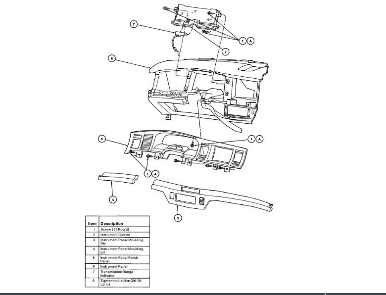

The clicking is from the blend door actuator which moves the mode door from cold to hot mode.
Images (Click to make bigger)
