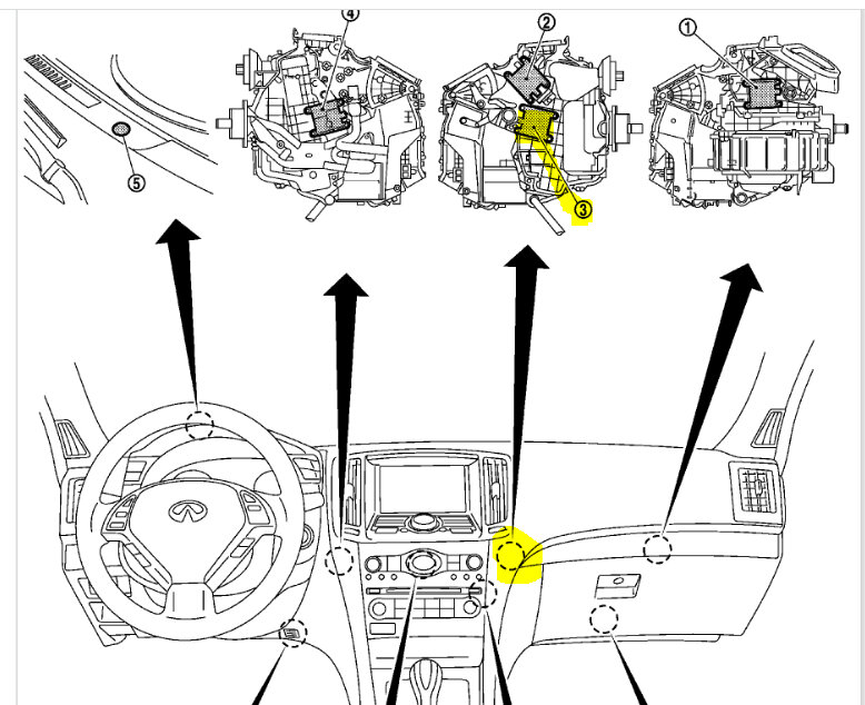

Do I have a second one for passenger side or it is only one? as the driver side blows good but passenger is stock on cold. Is it around glove box under or behind it if there is one. It is dual control temperature. Thank you
Dec 5, 2022 at 6:23 AM
  • 110,211 POSTS
If you have dual climate control, there are two. So, if the passenger side is cold, then we likely have an issue related to that actuator.
To get you started, here is a link that explains in general how to replace an air temperature door actuator (Blend air door).
If you look at pic 1 below, I highlighted the location of the right (passenger) side actuator.
See pic below.
