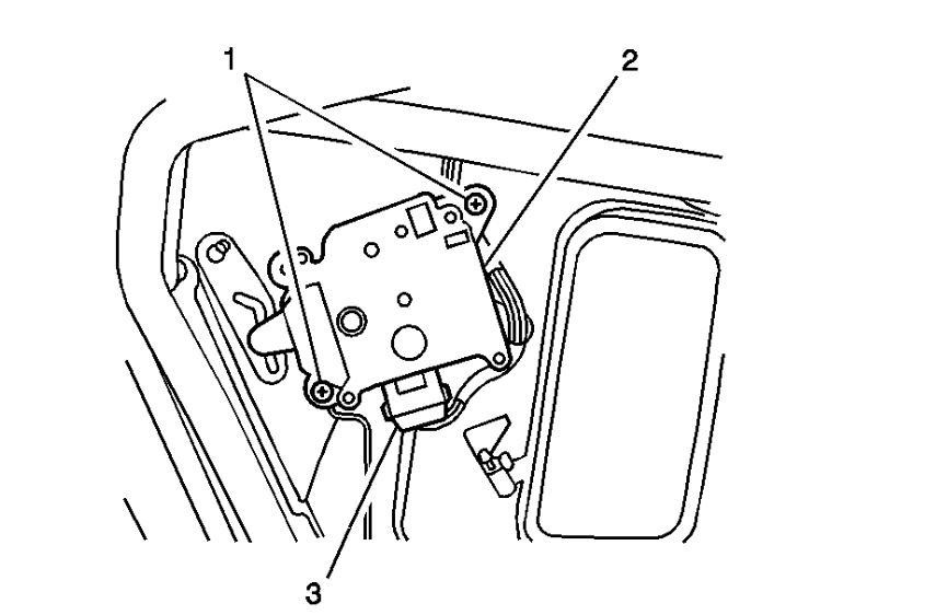

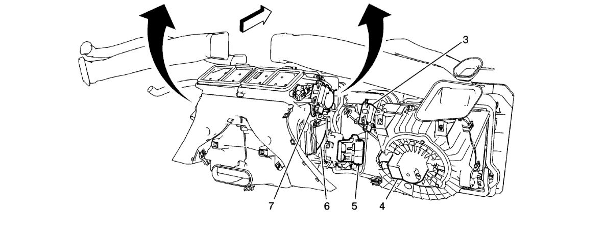

There are three different actuators on passenger side. How do I determine which one is not working? Do I have to remove entire dash to replace it?

I attached a picture for you to view of the actuator.
It is number 6 in the drawing.

That is the one that I replaced already but I still get hot air from passenger side.

Okay, I will try that. But could it also be #7 in picture?

If you said it moved with a command from heat to cool and back, good chance you have the correct actuator.
Check the others as well for movement.
