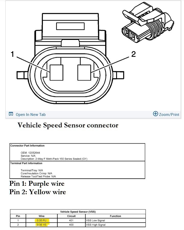

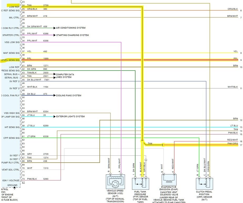

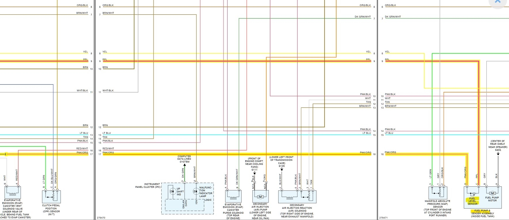

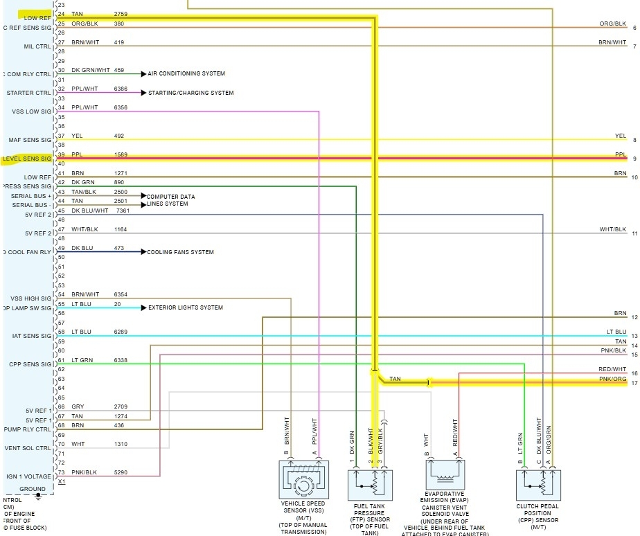

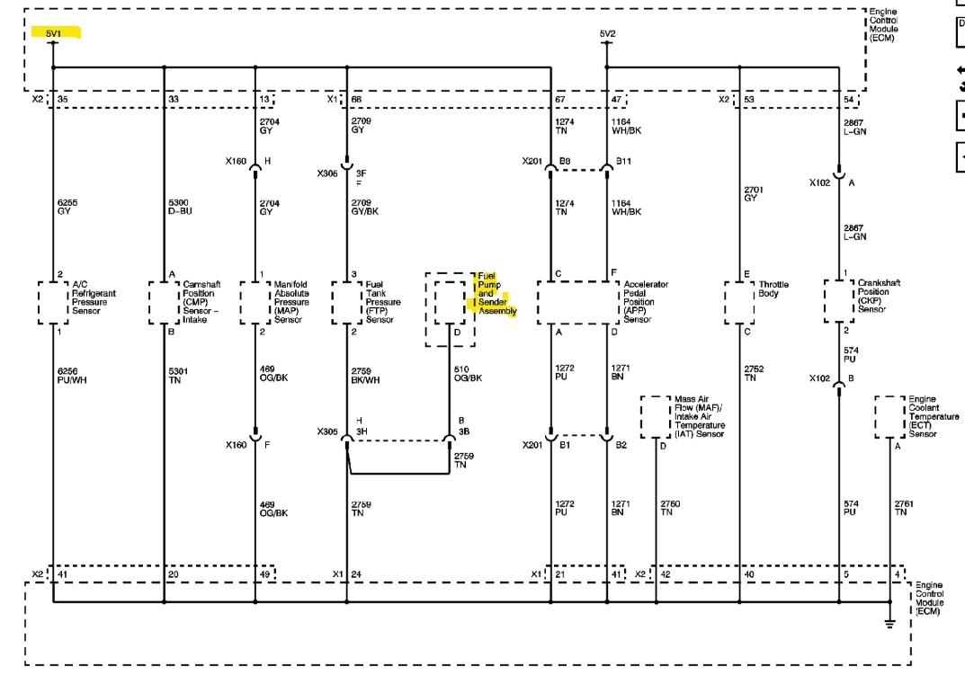

Sorry I had to read your posts again to catch up, been through a lot of vehicles lately, So, the dealership is returning most of what they previously charged you. But still no Speedometer and gas gauge? The fuel gauge code P0463 (Fuel Level Sensor circuit High Voltage) on the OEM wiring diagram shows the fuel level sensor is fed a 5volt reference and when the float on the sensor moves up and down as the fuel level does, the float is on an arm which changes the resistance in the circuit, and therefore changes the 5volts to a different level to indicate the fuel level. So, if the sensor is missing/open its ground (low reference) or the sensor is shorted to a power wire, it will read a high voltage level at the PCM.

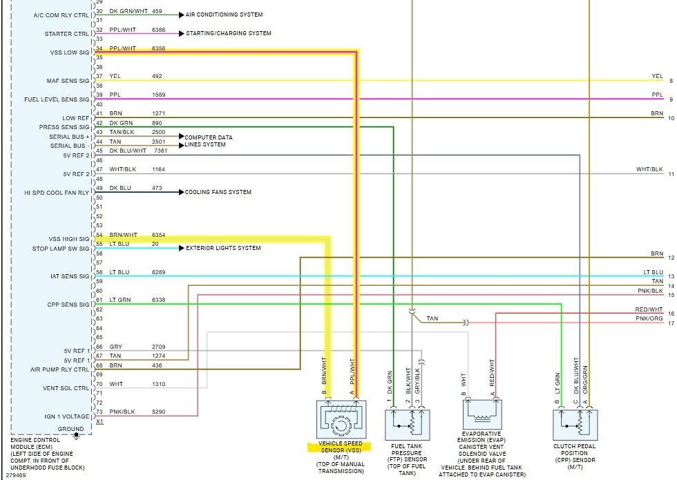

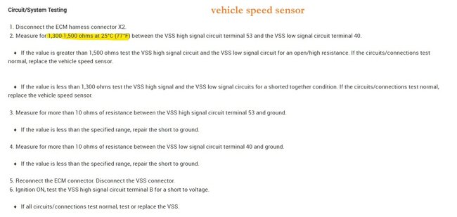

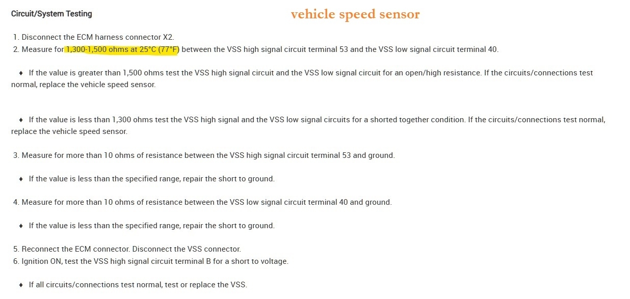

As for the vehicle speed sensor code, there are some specs for checking the resistance of the speed sensor for the manual transmission, but the PCM pins they have listed for testing are not the same as what is shown in the aftermarket wiring diagram.

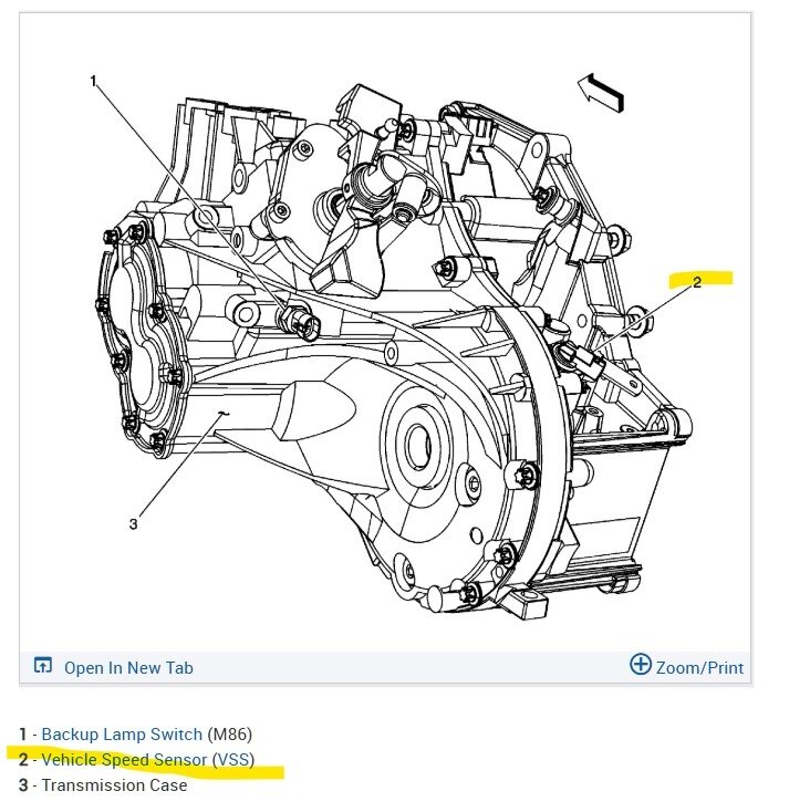

But it's possible the vehicle speed sensors wiring may have been affected when changing the shift cables, since the speed sensor is located on the transmission housing. With all the wiring harness movement you had posted about, it's difficult to say exactly where these wiring issues could be, but again going back to any areas where the harness was moved around and worked on, including the PCM connectors if they were disconnected, would be the first areas to check.
