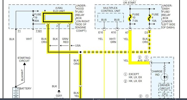

When driving the battery light came on and the power steering light came on. So I got home turned the car off and it wouldn't start again. So I bought a new alternator fitted it bought a new battery and fitted it and car started no problem, but battery light and power steering light still on. So I checked to see if the battery was charging which it's not. I checked all fuses they are all fine. So I thought maybe I was unlucky with the alternator, so I bought another and fitted it and still same issue. I'm lost for ideas on what to check next. Any help appreciated. Thanks

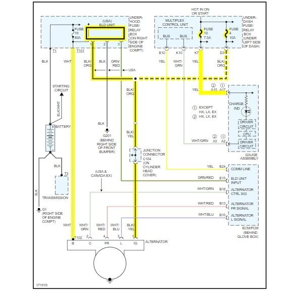

I attached a wiring diagram for you to view. Verify power to the fuses listed for power on both sides.
The ELD or electronic load detector is the most common failure for this issue.

Again I can find no issues there either.

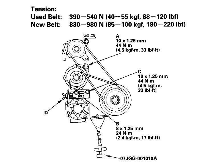

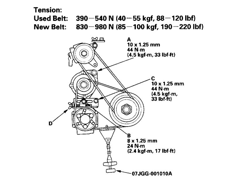

If the voltage drops when accelerating, it sounds like the belt is slipping and the alternator slows down.
Sunday, June 2nd, 2019 AT 8:57 AM

That was my thought also but there's no issue there. The Eld had a hairline crack in it so I replaced it and everything was running fine for about twenty minutes then same issue lights came back on in the dash and power steering went. Is it possible something is shorting the Eld?

No, there is no connection between the power steering and the alternator.
I would still suspect the belt tensioner for the serpentine belt.

Just thought I'd keep you updated encase anyone reports a similar issue. There was a damaged wire going to the o2 sensor that was shorting out the edl and in turn not sending power to the alternator.
