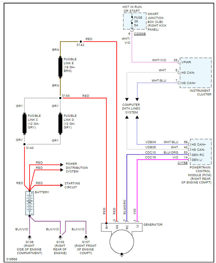

It needs a jump to start and then runs a bit rough, not sure if related to the alternator. Once I check the battery voltage and charging voltage, ig I remove the alternator is there a way to check the connector behind it to see if am getting what I need to get? if so, what wires should have power and what need ground?

I checked the charging, and it says 13.50. Battery is from 6/20.

The battery is almost five years old so I would say it is bad. You can remove it and head to an auto parts store for testing or you can use this guide:
Here is a guide to help you test the alternator:
Here are the alternator wiring diagrams so you can see which wires go where. Check out the images (below). Let us know how it goes.

Not solved yet. Changed the battery but i still have a battery light and the charging is over 13.

It sounds like you need to do a battery monitor reset.
Here is a guide to help:
https://youtu.be/ETNv2S_idIU?si=BZPj8NUX1Wicemd-
Also, have you run the FCAN scan?
