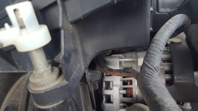

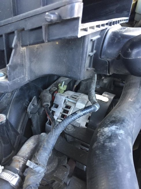

There's 2 wires going to alternator, 1 has black and red wire going to back in a plug in plug style no nut. And 1 black plug going to right side back of alternator with plug on plug style too. Which one I unplug? Thanks
Saturday, April 11th, 2020 AT 12:14 PM
The black/red wire is the one to disconnect.

I can't get at alternator so going buy socket for it tomorrow. Could I just unhook 1 cable that is coming to positive on battery that runs to the alternator? Will that work?
Saturday, April 11th, 2020 AT 2:26 PM
No, that turns off the test.
You need to disconnect the alternator.
Saturday, April 11th, 2020 AT 2:28 PM

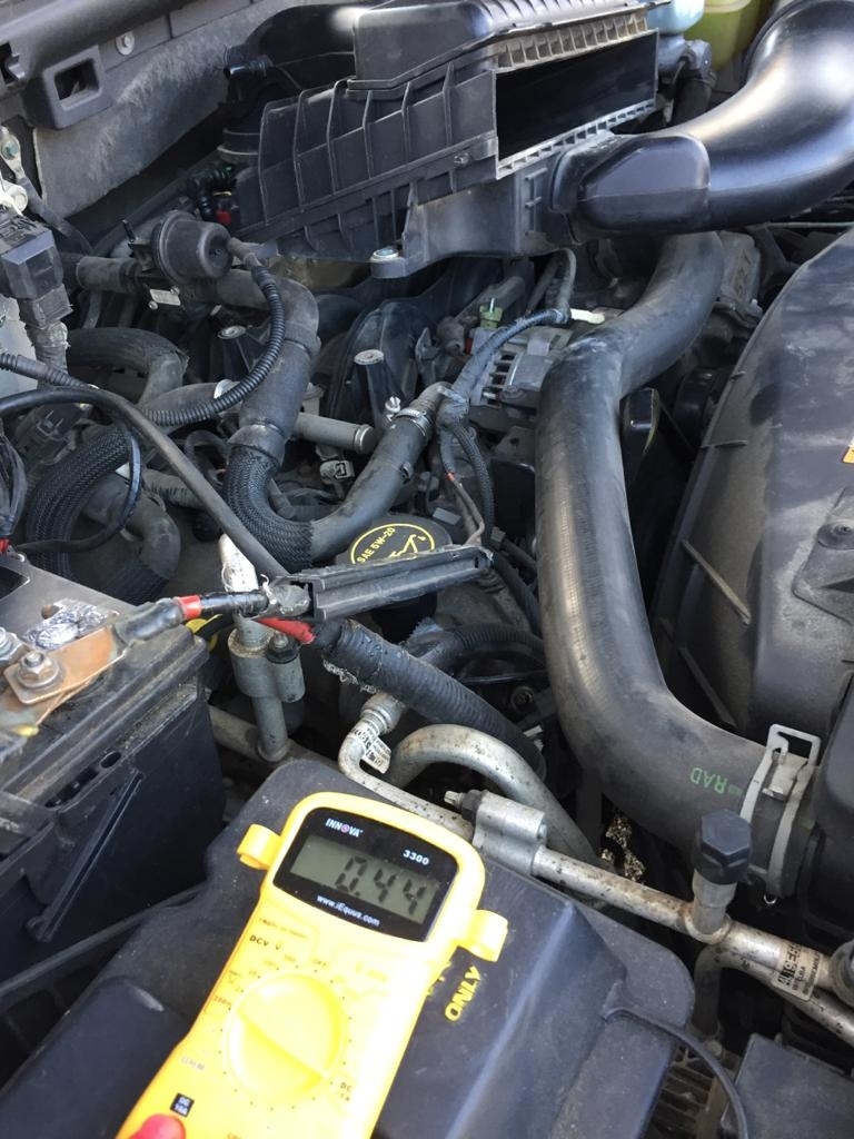

I check again with alternator unplug and still at.44 and I have a actuator that clicks under dash board but I think that has nothing to do with anything.

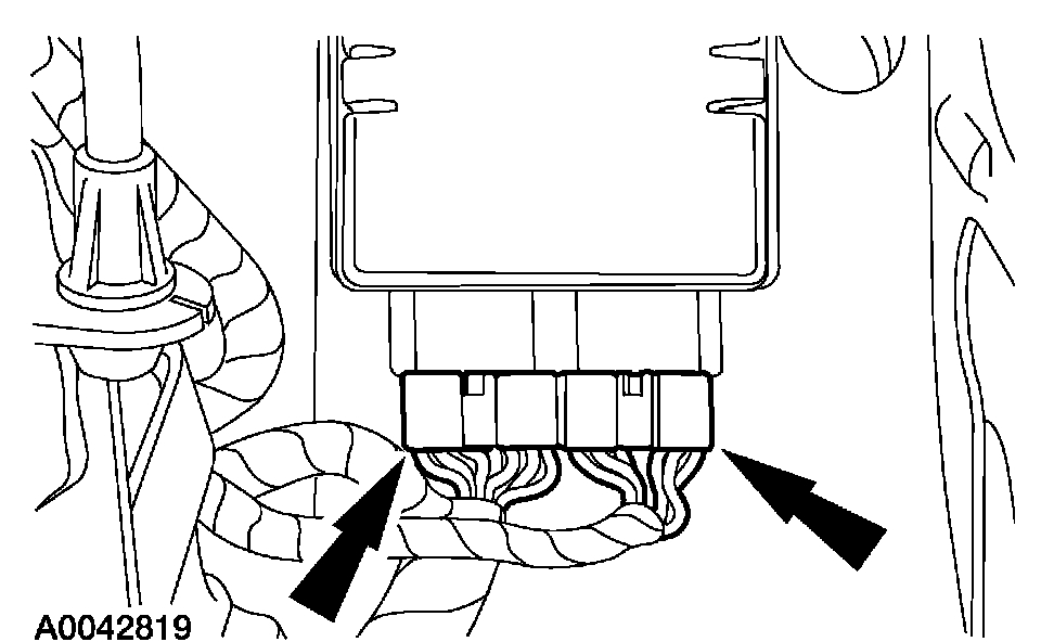

Only had truck for 2 weeks and suspension light is on in the dashboard and wondering if that doing anything drain power?

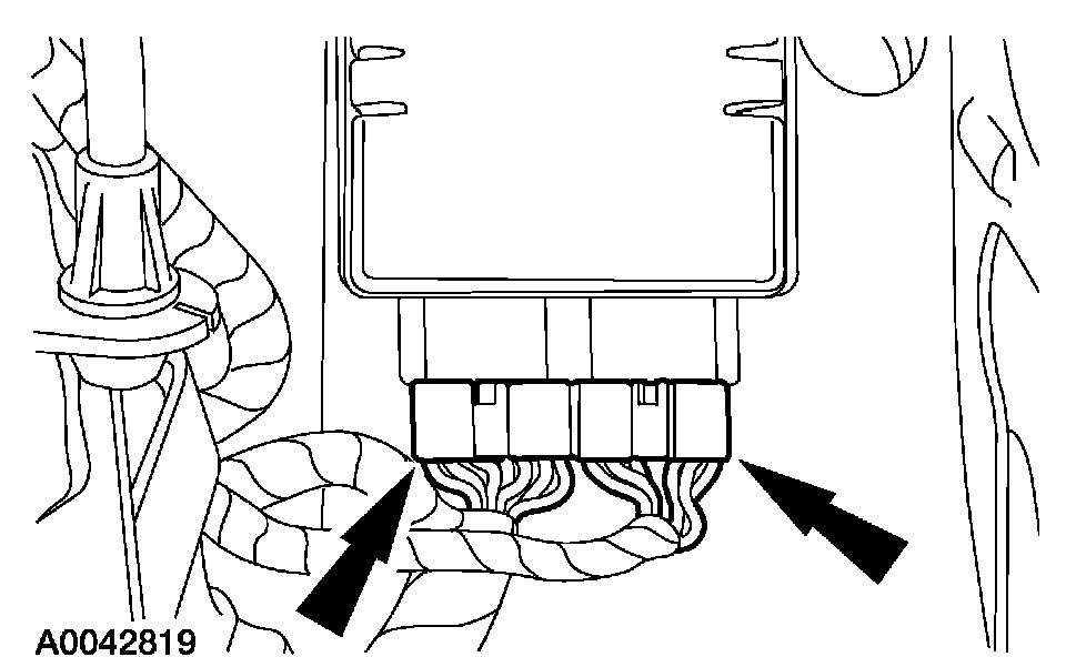

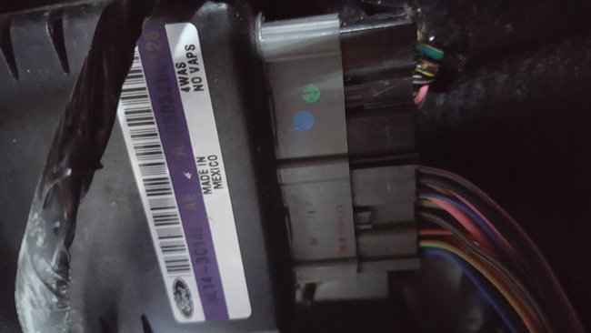

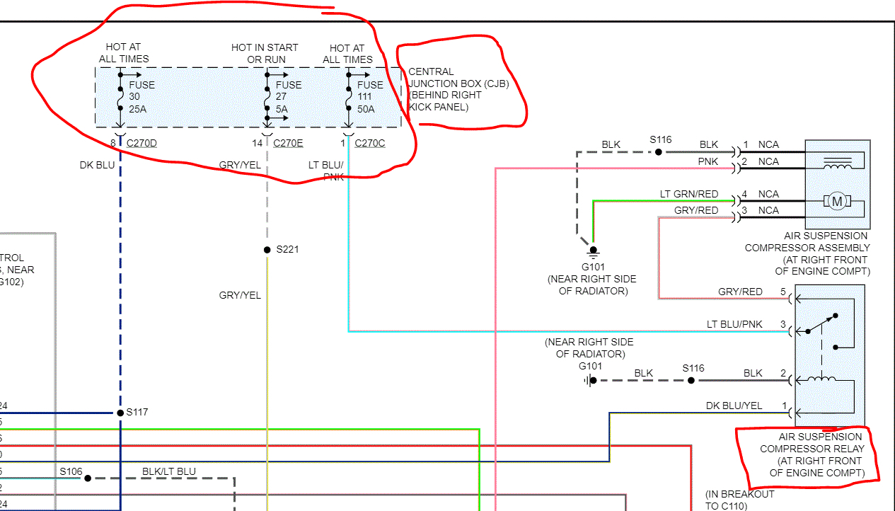

Roy, I thought you had it with the alternator / diode thought. However, I want to try something with this. Since the suspension light is on, there is an air suspension module under the dash that may be drawing power. Also, the idea that a relay is being heard needs to be looked considered.
Do this 3rd --- I attached a pic of the module. With the battery disconnected, unplug the suspension module and then do the test. The air suspension control module is mounted to the lower left side of the dash above the parking brake. Make sure the battery is disconnected before disconnecting or reconnecting the module.
Do this 1st --- There should be an air ride on off switch in the rear left of the vehicle. Chances are it is hidden behind the trim. It is a toggle switch. See if that changes things.
Do this 2nd --- If you haven't already, remove the fuses in the fuse box at the right side kick panel. That is the place you would rest your right foot if you were the passenger. See pic 2 for fuses I'm referring to. I have a feeling we found the issue, and it's related to the air ride. Note that the relay for the air ride is under the hood.

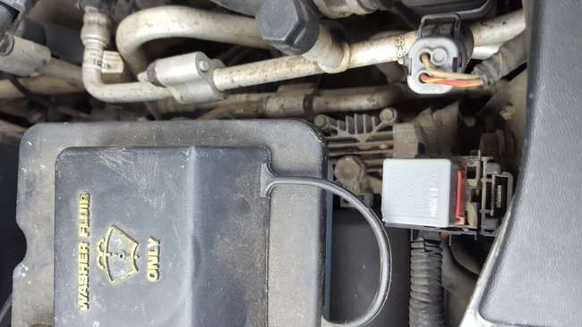

Relay in front of washer fluid was on the right side, was that suspension relay? Also under dash I unplug both and that was air suspension control module? If so still at.44 but I started truck and charge system light is on now flashing and when I drove it, it was warning me about it every 10 secs
Monday, April 13th, 2020 AT 3:33 PM
Did you test it with the alternator unplugged?
Monday, April 13th, 2020 AT 4:36 PM
TERRY L MENESES
  • 33 POSTS
Yep, yesterday and was still the same.44.
