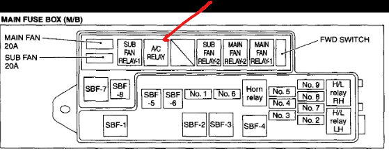

Please start another thread for the fuel injector issue, we only handle one problem per question. We we solve the battery drain on this one, I would pull the AC compressor clutch control relay to see if the drain stops, here is the location of the relay and a great guide for you to go over as well.
https://www.2carpros.com/articles/car-battery-dead-overnight
The relay is located in the fuse panel on the left side of the dash. Check out the images (below). Let us know what you find.

That worked perfectly. It fixed the issue instantly.
