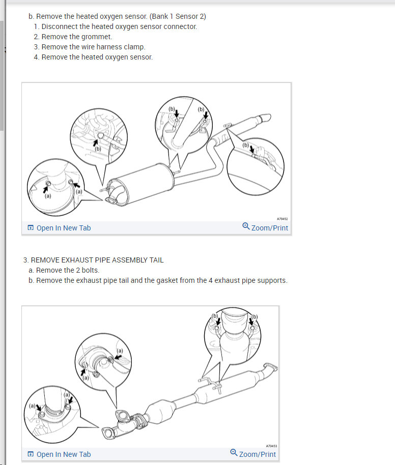

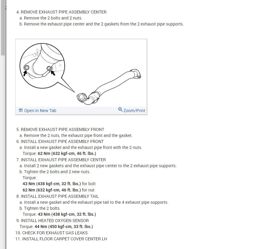

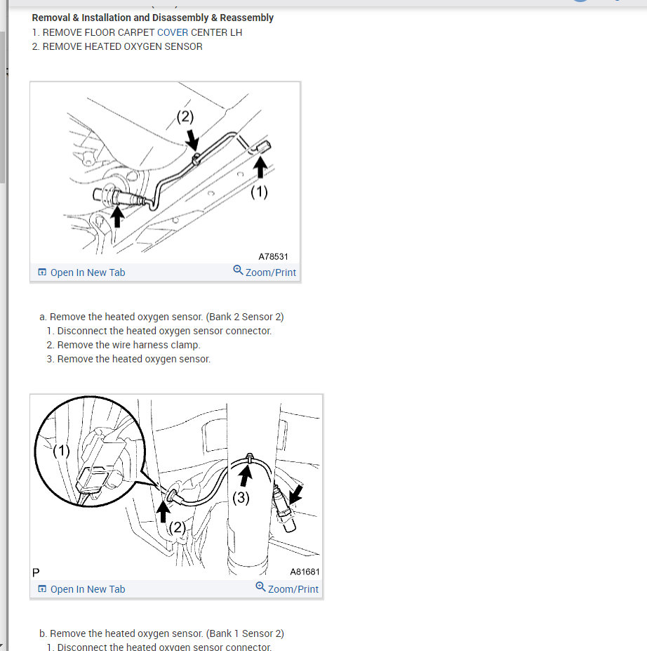

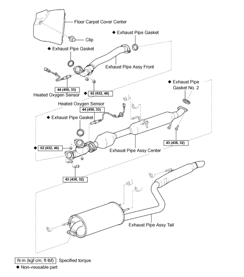

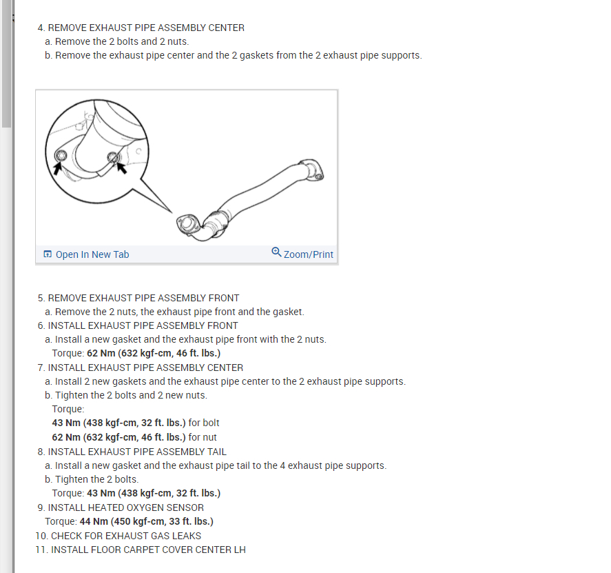

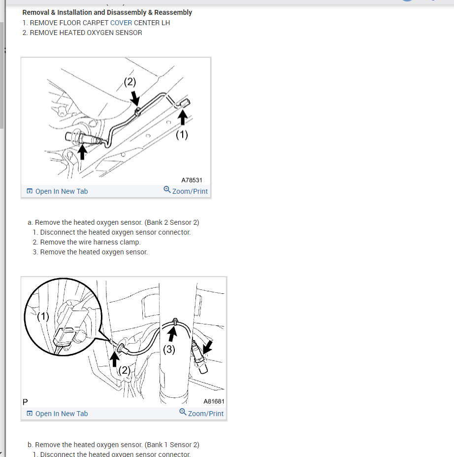

I need to determine if they need replacing or not.
Friday, October 8th, 2021 AT 1:59 PM
MECHANIC
18,907 POSTS
We can help with this.
Here are a couple guides that will walk you through exactly how to do this:
https://www.2carpros.com/articles/how-to-use-an-infrared-temperature-meter
Plus, below you will find the info from the manual on your vehicle that will help with identifying this and replace it if needed.
Please let us know what you find. Thanks
