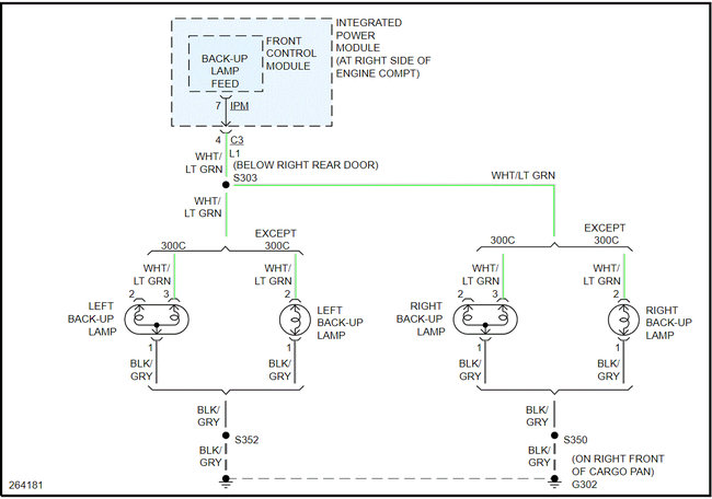

What are the wire colors going into the left taillight assembly? Specifically for the backup light.

If you look at the attached pic, I included the wiring schematic for the back-up lights. The wires at the socket should be white with a green tracer. As far as checking, let me know exactly what is happening. Also, here is a link you may find helpful:

Perfect, exactly what I was looking for. I'm installing a backup camera for my wife. This gives me a head start by not having to strip all the wires to pick the right one.
